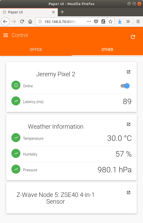

  • In the Paper UI none of the items show up, just the default thing name.

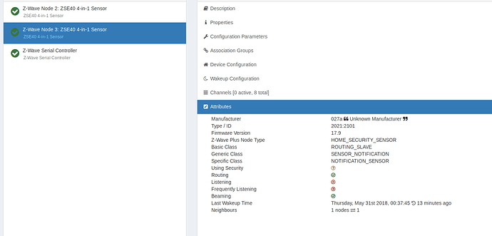

I don’t know if I am looking in the correct place but here are the differences that I noticed.
Manufacturer ID is “027A” in the database and “027a “Unknown Manufacturer”” in HABmin.
Firmware version is 17.9 in HABmin , database says all.
Z-Wave Plus Node Type is “UNKNOWN_TYPE” in HABmin

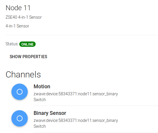

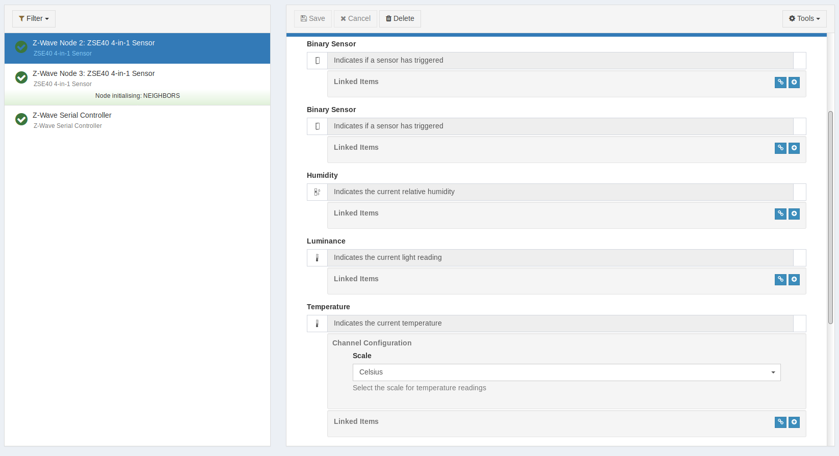

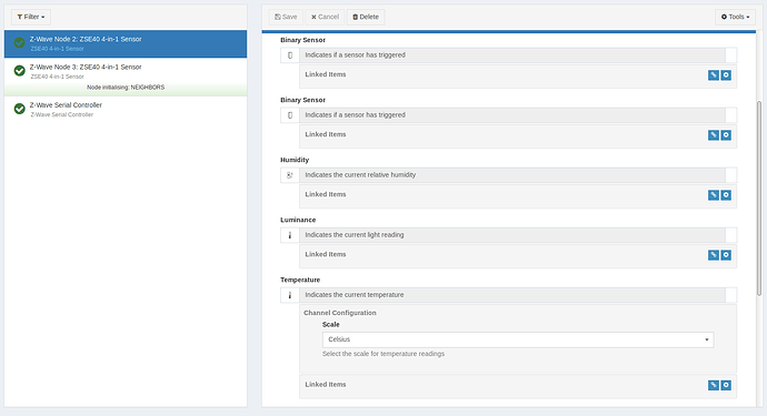

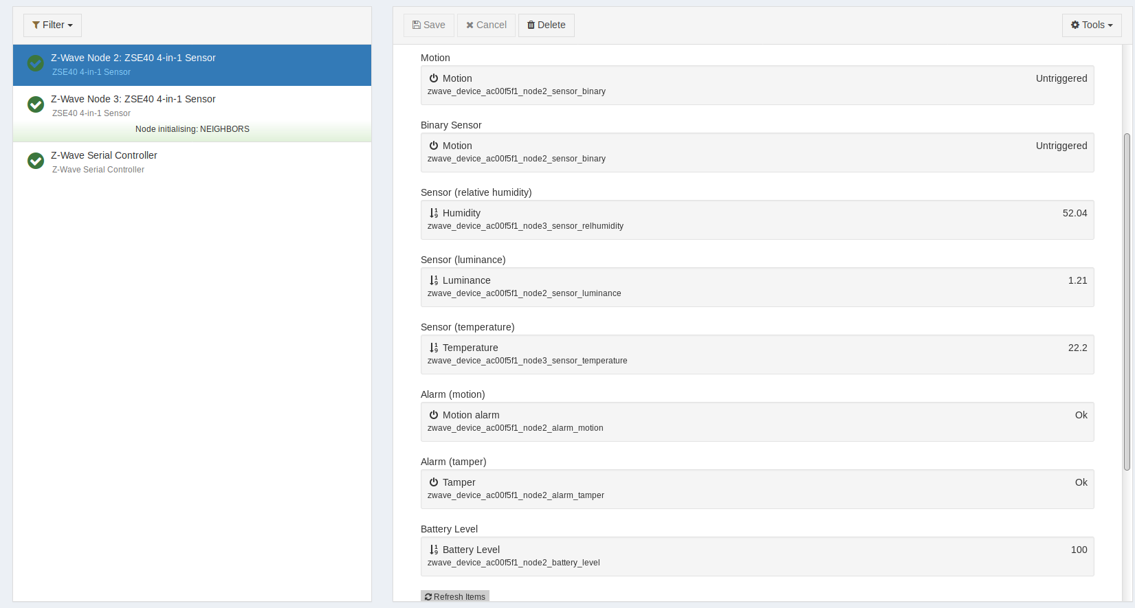

Also in HABmin and PaperUI there are 2 channels that have the exact same address.
Switch - Motion - zwave:device:f788bb8f:node5:sensor_binary
Switch - Binary Sensor - zwave:device:f788bb8f:node5:sensor_binary

Items are not part of the binding. It sounds like you need to link items to the channel?

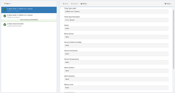

Here is an image after I overwrite the node2.xml file with the ZSE40 openhab2 device from the device list website. But its a rough temp fix as openhab reloads the broken binding after a reboot:
First is to understand what isn’t working as I don’t understand at the moment.
Why? These files are totally different format. Please don’t mess around with the XML files that OH writes - it will likely cause you problems and certainly doing this will definately cause errors. Each time you do this, the binding will have to download ALL the data from the device again. This will take time - it will not know what the device type is and likely the device won’t work properly until all this data is downloaded again! Since this is a battery device, this will take some time (hours!!!) unless you are manually waking the device up each time?
As above, the files are totally different format. There will be an exception caused by what you are doing, and the binding will rewrite the correct file.

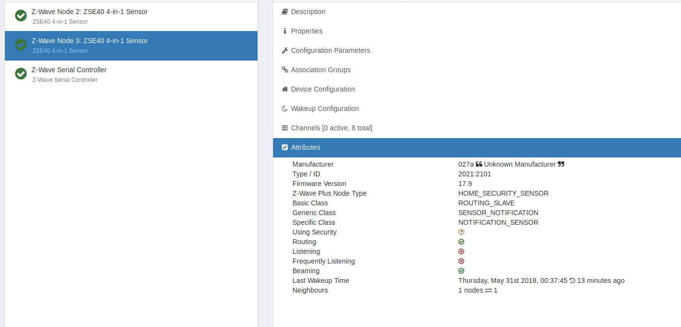

I don’t know what you mean? What are you basing this statement on? From what I see in the image, it looks like it’s detected ok. I see all the channels displayed, but you haven’t linked any items to the channels (at least in the first image!). The third image also shows that the device is working as I can see all the data as well.
So, I don’t really see any problem with the binding based on what you have presented above. I suggest that you don’t mess with the XML files and make sure the device is fully initialised by waking it up.

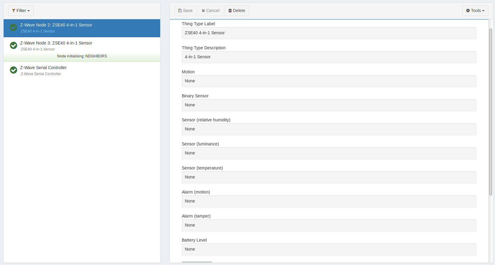

well.. the third image is after i overwritten the xml file with what is on the device list which you mentioned i shouldnt have done but thats the only way i get any information from this sensor.
That is before I’ve done anything to the xml file and the device is obtained on its own.. it doesnt have anything to link it to. If I press the link button or the add button there is nothing availiable on the dropdown for my device.

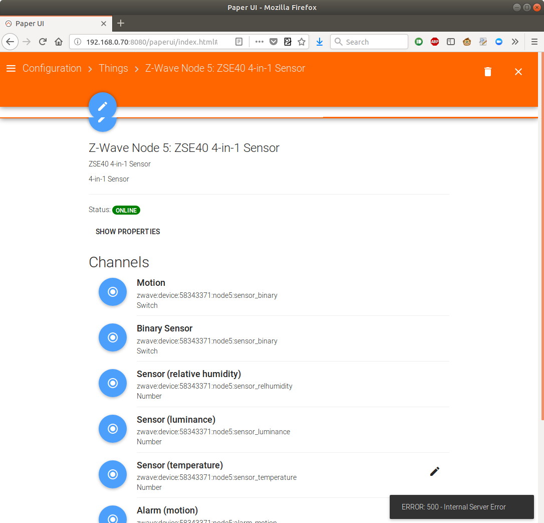

However: Now if I attempt to modify the name, location, or temperature scale I get a “ERROR: 500 - Internal Server Error” in PaperUI. In Habmin it says it saves correctly but if you close and re-open none of the Properties values get saved. See screenshot below:

I’m assuming this is because the ZSE40 has two binary sensors on it, so the OpenHAB UI is trying to generate two sensor items with the same name?
I don’t see two binary sensor channels on this device, so I don’t think that’s correct?
The device itself doesn’t have two channels, but two show up in both Paper UI and Habmin, both with identical address / item names:
If I click the radio button to “enable” either channel it tries to enable both because they are assigned the same name.
If you look at the earlier posts in this thread other users were reporting the same symptoms:
So I’m not sure if the Zwave binding is mis-reading the device or the UI is mistakenly generating two channels when there should only be one, but either way I think there may be a bug here somewhere.
