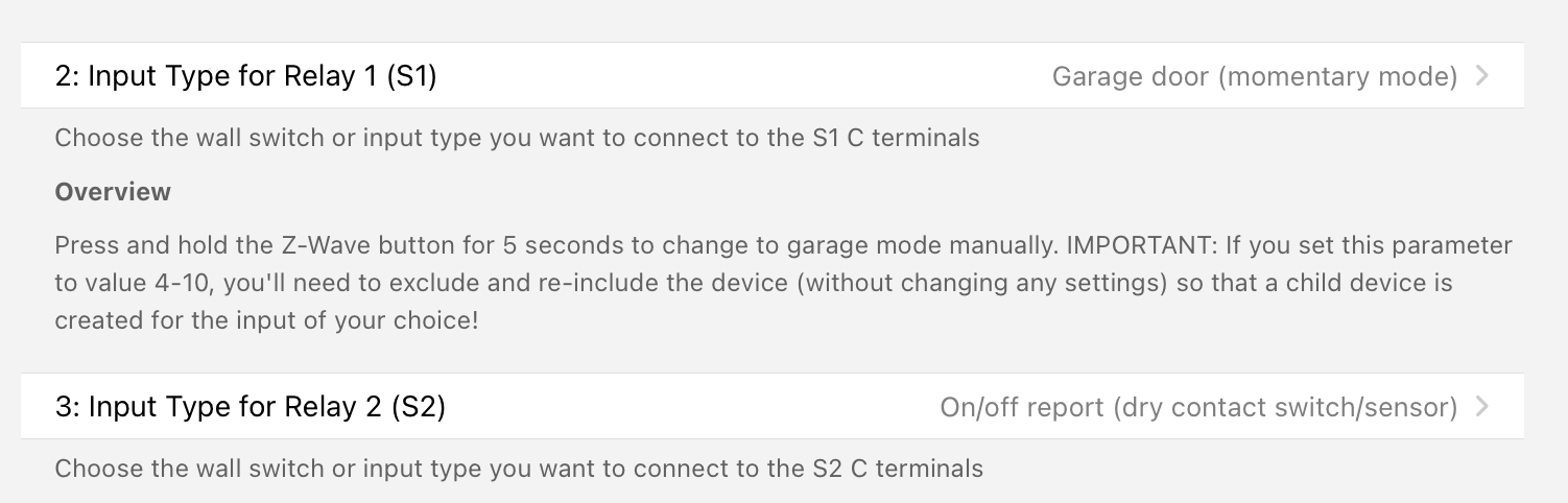

Relay 1 is controlled by Switch S1. Configure the switch input as “momentary mode” for Garage door. Ignore Relay 2. When I made that change, OH showed the configuration as “Pending”. I pressed the Z-Wave button on the ZEN17 for 5 seconds to complete the mode change. YMMV.
Enable the Trigger for S1. This will allow S1 to control Relay 1.
Configure Relay 1 to turn Off one second after activation.
