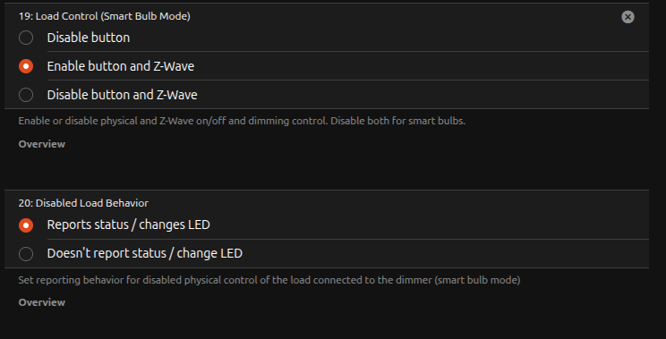

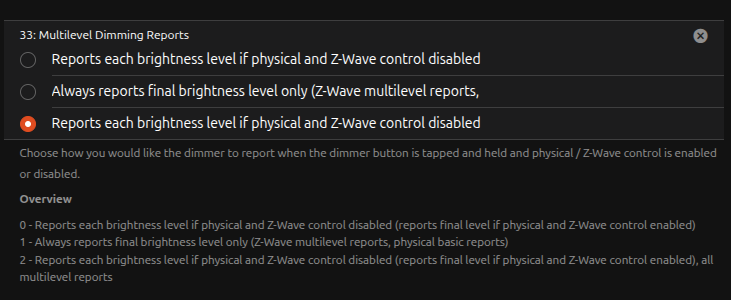

Edit: also make sure parameters 19 and 33 are showing correctly

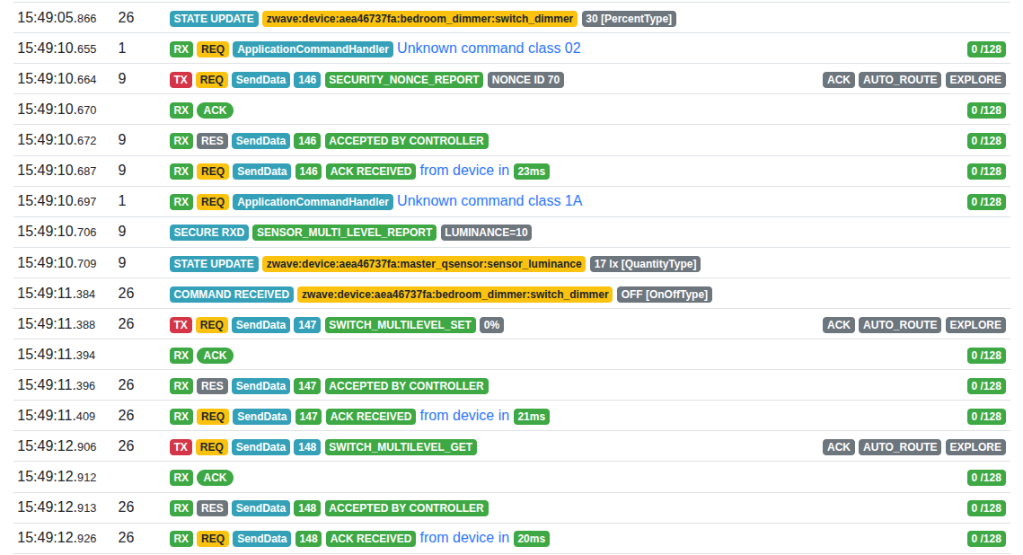

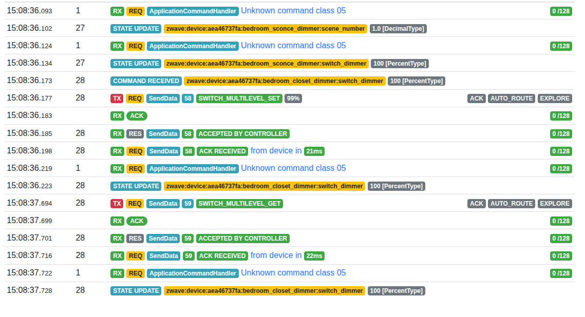

Attached is a trimmed down log file. Node 26 (bedroom_dimmer) is the ZEN35.
It seems to respond with state updates when triggered from OpenHAB, but no messages seem to go through when I press the button manually.
I do see a bunch of “Unknown command class“ messages, I wonder if that’s related?
zen35_sample.log (240.5 KB)

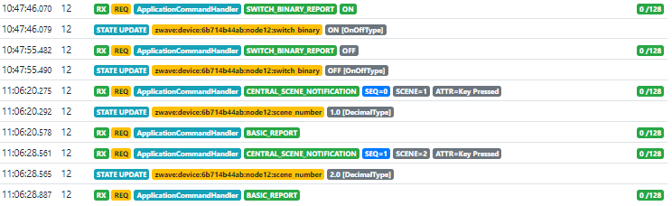

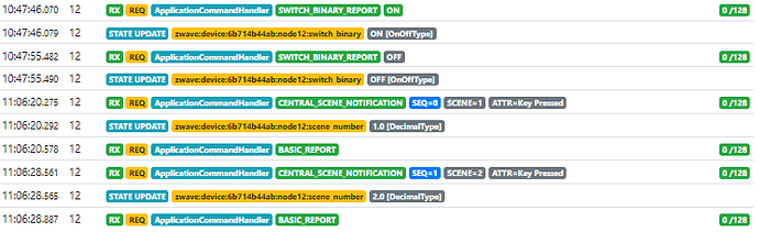

As a comparison, here are some status updates from ZEN72s:
paddle_dimmer.log (24.4 KB)
Here are some screenshots of the parameters:
The messages showing node 1 are odd. Will take a look. I have a Zen73 (on-off only). With only manual operations. (my device doesn’t have the Basic CC, but has a parameter to use Binary Switch)

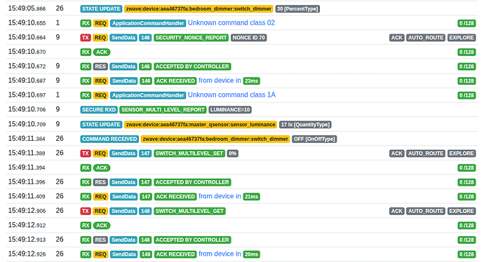

Ok, here is a manual log file. I pressed each button, and double tapped the dimmer button. Other than “unknown command class“ messages, there is no traffic from node 26.
I’m not sure if the bytes listed are raw received data or translated by the USB stick. I don’t have a copy of the ZWave spec anyway, so I can’t analyze further. According to an online resource, the “unknown” command classes don’t exist, so either the data is probably getting corrupted, or the ZWave binding isn’t parsing it properly.

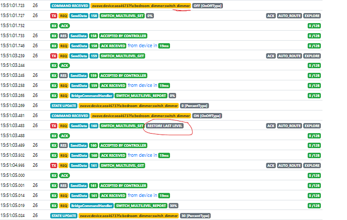

This is the only thing I found odd in the first file. It appears the manual trigger is sending a restore last value command. Could that be possible? Maybe your latest will clear it up. There should be no TX from the controller. Note the log I posted, only RX for local control.
EDIT: Definitely no messages from Node 26. Thing to try. Delete the node from the thing page and rescan, if that doesn’t work, exclude the node via the controller and reinclude.
Yeah, I wondered if the “unknown command class” was reported by the binding or the viewer.

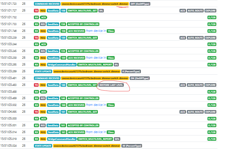

That’s not a manual trigger, that’s me changing it from the OH UI. The button on my page changed the state to “ON”, which I assume defaults to Restore Last Level.
If I push buttons on the ZEN35 directly, I see no traffic other than the “unknown” messages.
