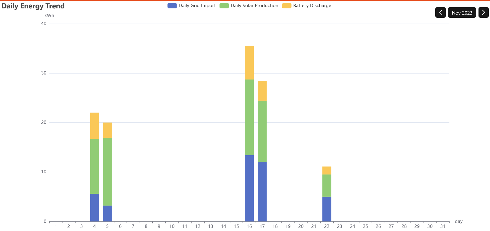

Issue of the topic:
The graph below confirmed an issue which i have observed but failed to solve. Initially i thought the issue was a charting issue where some data disappears causing gaps on the info. However 2 weeks ago, after reading zram issues, i realised that possibly zram was causing issues which resulted in the data going missing. Typically this happens when the device restarts unexpectedly. I uninstalled Zram rebooted and the reinstalled ZRAM. For a few days all seemed fine with data being kept as expected through reboots. The problem showed up again this week. What is strange is that some data is stays and is removed. Today i woke up to find my OH failed a few automations. It was painfully slow. I rebooted. at 8am. Then it came alive. Upon checking the logs, all entries for the last week until at 5am today are missing. Various graphs are also missing data for some days.
My question is, Is this ZRAM issue or memory card issue or even the installation itself?
Forgive me on my ignorance but this has been working flawlessly without losing data before. While it is possible to lose data on unexpected reboot, I don’t expect to lose data when I restart the device myself. That is graceful restart data should be preserved.
