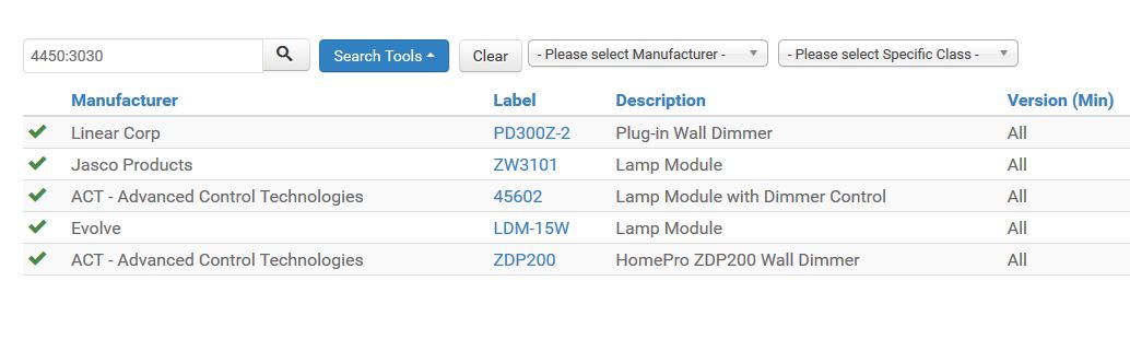

Looks like this was done multiple times:
This just shows the one conflict as already noted. The others you’ve found are different manufacturers so there is no conflict.
