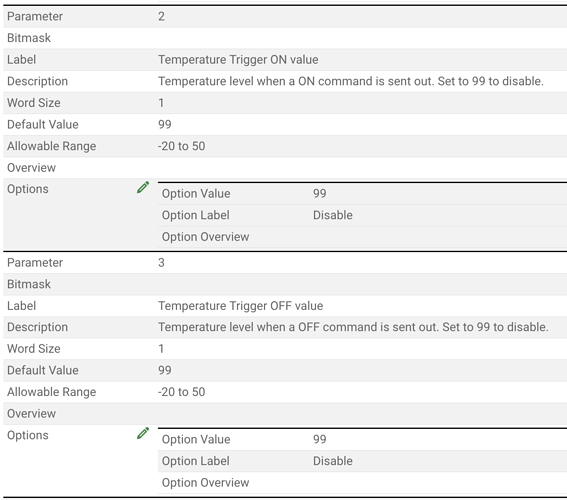

From what I understand, you would need to set config parameters 2 and 3 to set the temperature values that will cause the device to send the ON and OFF commands, respectively. Then you would need a rule to perform an action when an ON and OFF are received.
However, there’s no channel defined in the ST814 database entry to which you can link to an item, so I don’t think it will work.

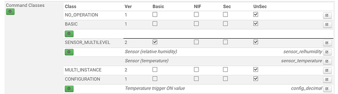

@chris I’m not sure how this should be handled. Should there be a SENSOR_BINARY command class that’s linked to the BASIC command class, and defines a sensor_binary channel?

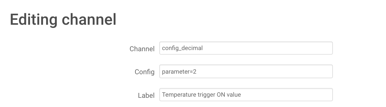

Your advice to use config_decimal would only create one channel. Or do I misunderstand?
I would kindly appreciate if you could give me some more advice on how to configure this properly.
I understand that these channels would be used to SET the min and max temperature that the device would use as the trigger to send the ON/OFF commands, but what channel gets updated when the device sends the ON and OFF commands?
I was assuming that this was being used to control another device, so maybe I missed that need - if this needs to be fed in to OH, then it will also need a switch channel in the BASIC command class as the device will send a BASIC_SET.

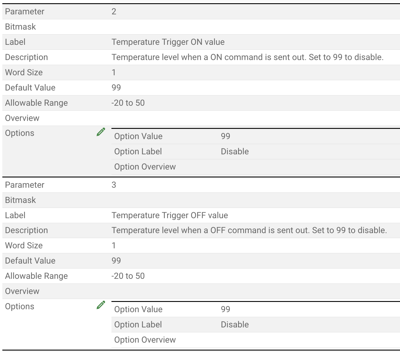

It is not possible to GET the min/max values - if you are talking about the temperature itself. You can GET/SET the limits that you have set if that’s what you mean?
Correct.
This is the database - I hope that what I provided above is self explanatory, but if not, just let me know and I will add all other channels.

Once I’ve approved the database changes and exported them to the XML files, the database will need to be imported into Github, then the binding will need to be rebuilt, and then you will need to update your binding to the latest version that has the updated database definition. You will also need to delete and re-add the thing so that it picks up the latest database definition for this device.
This is the same process as always when a database update is needed - there’s nothing special for these channels in that respect.
@ohb1138 If you want, I’ll finish updating the database with the config channels, as well as the switch channel. Since I have several of these devices, I’m also able to put these changes to good use.
