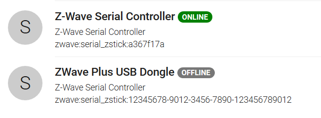

Also, the discovery processes find a ZWave controller, even though one is already available and working (maybe a different issue?):
Can you provide the link to the database for your device please? Or provide the device type/id so I can be sure what the device is.
I suggest to just ignore this.
