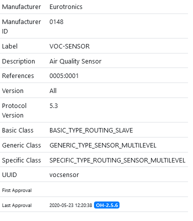

i tried to integrate the air quality sensor from eurotronic. Unfortunately, it doesn’t seem to be in the database. (Z-Wave Node 063 (0148:0005:0001:0.1) ) however, this is listed in opensmarthomes’s database.
I currently have version 2.50 M1 running.
Should i update to a snapshot version?
Thanks in advance
… i found it. using 2.5.6 should help… i’ll give it a try
Correct:
yes, it worked
thanks

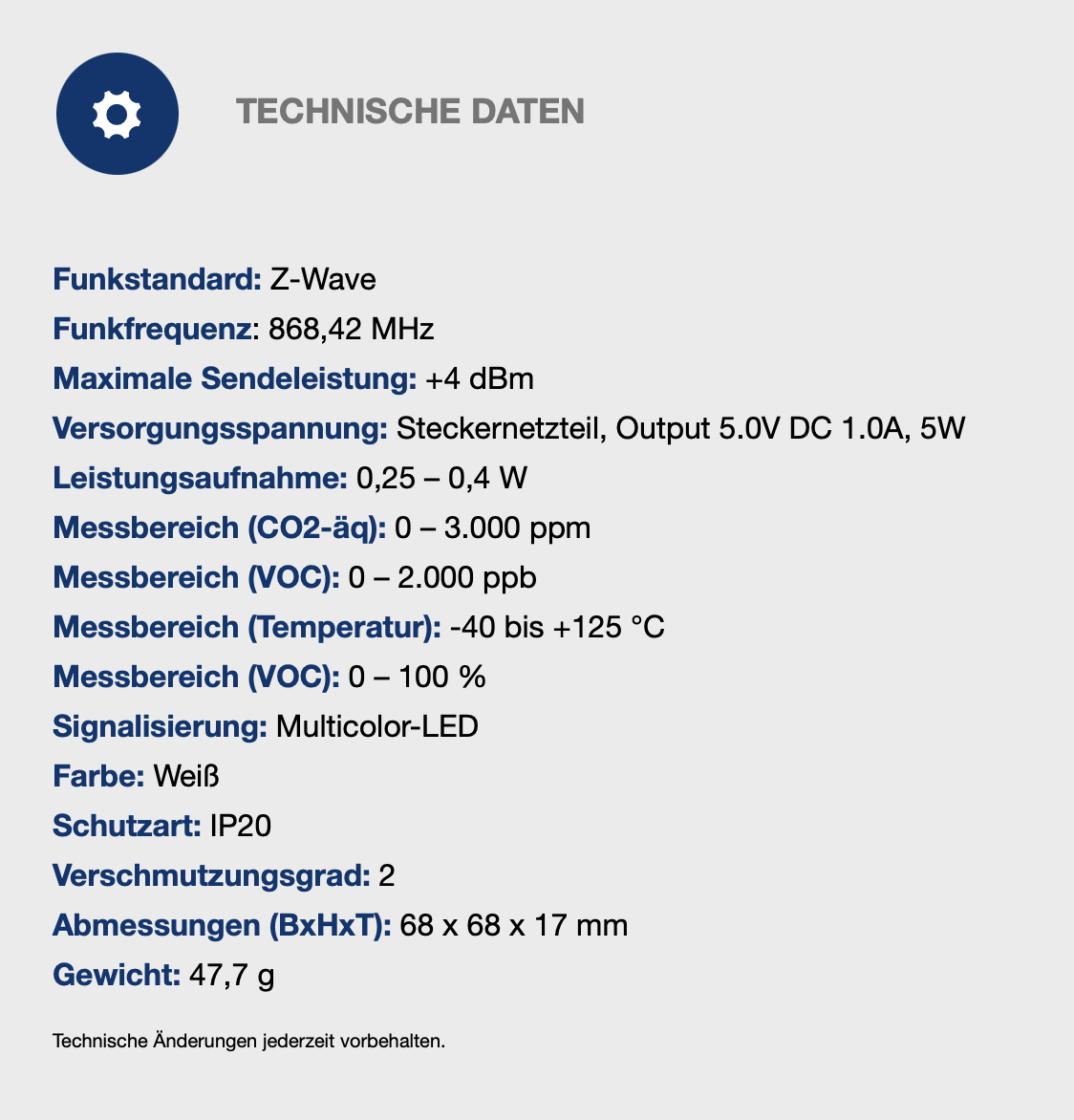

The user manual is confused between it is in ppm or ppb, but neither of these two units match the weird float return I get.
Could it be a percentage of the sensor itself? Here it says:
And if I don’t speak German, I understand that it says it measures CO2 between 0 and 3,000 ppm and VOC between 0 and 2,000 ppm, temperature between -40 and +125°C and then it mentions VOC again in % (but I suspect it is a mistake and they intended to mention relative humidity).

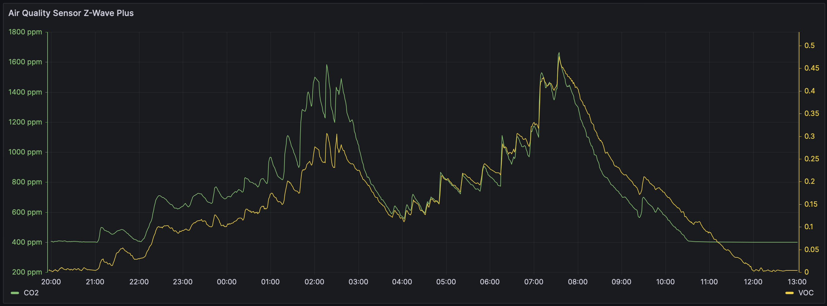

We can see with the following chart than the VOC value (in yellow, Y axis on the right) I receive varies when the CO2 value varies (in green, Y axis on the left), so the sensor must be working, but I am totally lost when it comes to the unit for the VOC value returned by the Thing for this channel:
Is the OH Thing definition correct? Is there a ratio to apply to the number to convert it in ppm or ppb?
