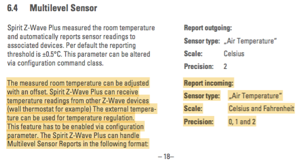

I tried it like the manual descripton:
Externel Temperature:
Measured Temperature offset: 0x80 (128d)
now I try to send a temperature via the SENSOR_MULTILEVEL but nothing happens

I want to use the Thermostat with an External Temperatur Sensor. So e.g. an 1-Wire temperature sensor is placed in the room. The openhab is reading the value of the temperature sensor and sends it to the radiator. The openhab also sends the setpoint to the radiator and the radiator do the rest like adjusting the valve opening.
To do this i have to set the Parameter 8 (“Measured Temperature offset”) to 0x80 (128)
then i have to use the SENSOR_MULTILEVEL to send the measured room temperature

Sorry for the bump. The use for external temperature sensor works only with a direct association. So you have to associate a sensor to the Spirit, than you can use its function. This has nothing to do with openHAB
