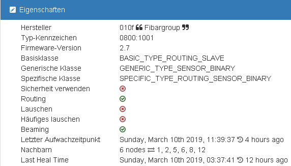

I’m nearly desperated. 2 of 3 Fibaro FGMS001 stopped working.
Temperature, Illuminance and Battery are running. Motion Alarm, Tamper Alarm are NOT running anymore!
I bought them abot 1.5 years ago at the same day.
They are all the same:
I compared ALL settings, they 3 are all the same configured.
They were running until End of January 2019 /Mid February 2019. I didn’ t change anything!!!
I have three items:
FibEye1_Motion_S (=node 3)<–NOT OK
FibEye2_Motion_S (=node 11)<–NOT OK
FibEye3_Motion_S (=node 9)<–STILL RUNNING

I tried the following:
I had a Backup of 20.01.2019. I reused this. No success.
I excluded one (=node 11) of the two from controller. Did a factory reset.
Included it again (= now node 13) → NO success!
When I set:log DEBUG org.openhab.binding.zwave → If I force motion or tamper alarm (node 3 or node 13 (former node 11)) → NO entries in logfile !!
Only when I wake them up: here node 11 (now node 13)

Hi Alex,
just try with a fresh batterie. It solved the problem for me instantly.
Kind regards
Clemens
@kanji
Thank you for the hint.
I wonder why the battery states are still remaining 81% and 100%? Was it the same at yours?
I’ll give it a try!
Alex
@kanji
Inside are the following batteries:
Are they really empty after 18 month? I could not believe!
Has someone else the same experience?
@Celaeno1 Try with the batterie from the still working one.
@kanji OK, I’ll try this evening!
I have the same unit. My battery was empty in a month. Had the wrong settings.
For me the unit does not give actual battery status. Re-added one of them and battery went from 100% to 0%. New battery and it was up and running again. I threw them out and replaced them with an aeotec multisensor. Those units can be powered by an outlet, I gave up on zwave and battery powered.
Have researched the internet and read a lot about the FGMS001. The battery life is according to the manufacturer up to 3 years. Other online stores write in the product description up to 2 years. Various forums report from one month over 3 months up to 1.5 years, depending on the settings. Mine are on DEFAULT settings. A long-term test (published in internet) showed 40% rest of charge after 12 months. I will now change the batteries, let’s see how long these battery charges will last and whether the motion alarm now works again.
P.S: I wonder why the battery states are still remaining 81% and 100%? How do I get the correct values?
My FGMS001 does not send motion events, if it’s added with PaperUI.

Initially I used PaperUI to include FGMS001 (1.5 years ago) . Then I NEVER changed any setting! Now after 1.5 years I excluded it through Habmin and included it with PaperUI again. Maybe that’s the problem?
I would have tried to include it using Habmin again.
@jag @kanji @khakzoy
I had success. I bought 1 new battery. Put it into FibEye2 (=node13) . Same problem. Woke it up about 25-30 times. Same problem. Changed the thing name a little bit with Habmin. Woke it up about 10 times again. FibEye2 (=node13) (Motion Alarm/Tamper Alarm) is running again!
Thanks to all! :slight_smile:
But I’m going to observe this the next few days.
P.S. FibEye1 is still not running (with old battery, have no new one). Will try it in the reverse order. But not tonight.
