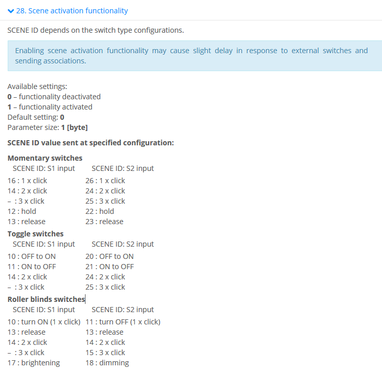

Make sure you have scene numbers enabled (parameter 28):
https://manuals.fibaro.com/dimmer-2/

I did not change parameter 28, it’s still 1 (activated). I actually tried changing it to 0 and then back to 1, but that didn’t change anything.

Okay, I checked this out today:
Triple clicking is only available on S2, as I only have S1 connected I can’t test, sorry.
Make sure you have Group 3 set to your controller and scenes are activated.
