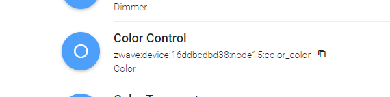

Thanks a lot! I used color_color instead of color_color1. Now I can set colors. The only thing left is how to control the W channel manually. Using switch_dimmer5 didn’t work for me.
Anyway, you’ve been a big help, @stefan.oh! Thanks again!
What I normally do when creating an Item is copy fro the Paper UI. There is a double box right beside the information needed to link the channel. That copies the information to your clipboard for pasting into your Item.
