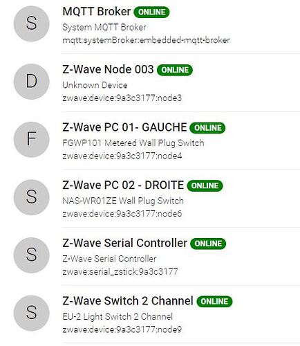

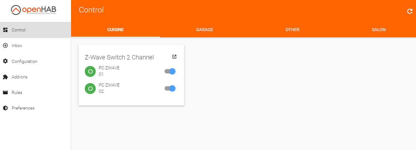

The pic is from PaperUI (use for config not control), do you have a sitemap created for BasicUI and checked the status update there?
Hello, No i do not have any sitemap, nothing appear on basicUI when launched.
I will read documentation about that.

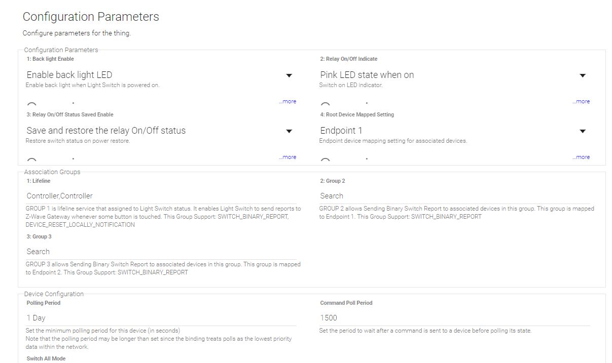

FGWP101 is a Z-Wave device, not Z-Wave Plus. I think that means you need to associate the controller with device Group 1 to get the status updates. An expert such as @5iver can confirm if that is correct.
I think the NAS-WR01ZE should update the status automatically and that should show in the openhab logs.
The Paper UI is not a good UI to use for accurate status, in my experience. That is why the Basic UI with sitemap is recommended.
Correct, but my understanding is that the binding should force these too. But if status updates are not reported and the device supports them, then associations are usually not set. I don’t know this device, so the configuration parameters should be checked too. Logs are your friend!

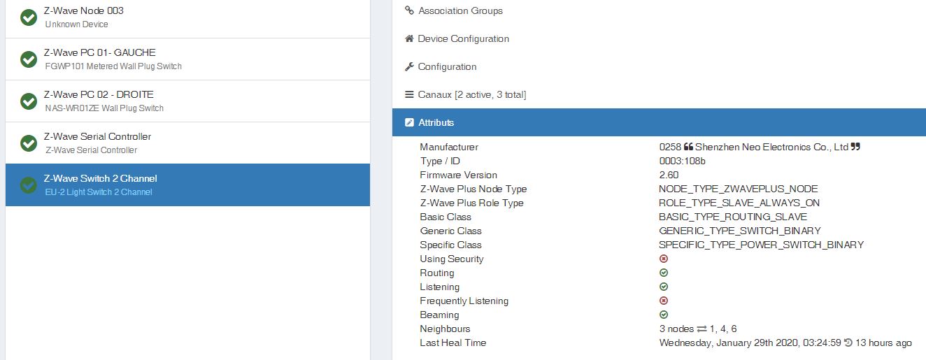

Here is zwave wallswitch conf
Best regards

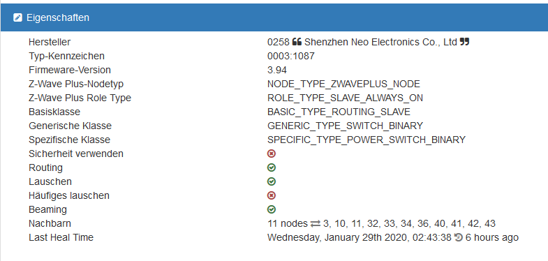

If you want help we need more detailed information:
  • which device with which firmware do you have? (Check properties page in HABmin):
  • How is your items configuration?
  • How is your sitemap definition?

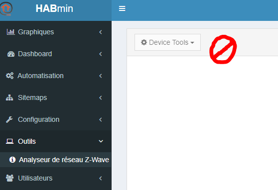

I tried to use HABmin, but it seem to be unusable , zwave “analysor” is forbidden access.
Or i do not search at the good place ?
Only BasicUI, PaperUI , Home Builder, Classic UI seems to work fine.

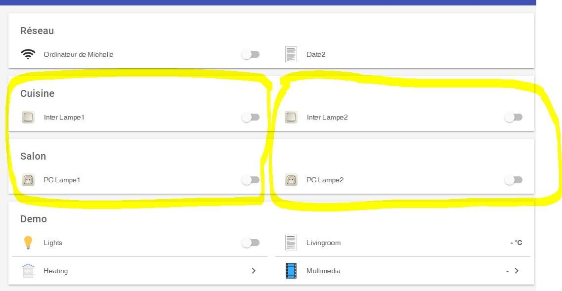

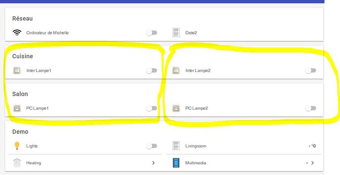

Here is my sitemap file :
sitemap wiwire label="Domotique à BAULON" {
    Frame label="Réseau" {
        Switch item=PC_Michelle label="Ordinateur de Michelle"
        Text item=Date2
    Frame label="Cuisine" {
        Switch item=WallSwitchA_1 label="Inter Lampe1"
        Switch item=WallSwitchA_2 label="Inter Lampe2"
    Frame label="Salon" {
        Switch item=Wallplug_Lum1 label="PC Lampe1"
        Switch item=Wallplug_Lum2 label="PC Lampe2"
    Frame label="Demo" {
        Switch item=Lights icon="light"
        Text item=LR_Temperature label="Livingroom [%.1f °C]"
        Group item=Heating
        Text item=LR_Multimedia_Summary label="Multimedia [%s]" icon="video" {
            Selection item=LR_TV_Channel mappings=[0="off", 1="DasErste", 2="BBC One", 3="Cartoon Network"]
            Slider item=LR_TV_Volume
Give this screen :
Here is items file:
Switch Wallplug_Lum1 "PC LUM1" <poweroutlet> { channel="zwave:device:9a3c3177:node4:switch_binary" }
Switch Wallplug_Lum2 "PC LUM2" <poweroutlet> { channel="zwave:device:9a3c3177:node6:switch_binary" }
//Switch WallSwitchA_1 "Inter A_1" <wallswitch> { channel="zwave:device:9a3c3177:node9:switch_binary" }
Switch WallSwitchA_2 "Inter A_2" <wallswitch> { channel="zwave:device:9a3c3177:node9:switch_binary2" }
Switch WallSwitchA_1 "Inter A_1" <wallswitch> { channel="zwave:device:9a3c3177:node9:switch_binary1" }
Switch PC_Michelle "PC Michelle" <network> { channel="network:device:192_168_0_92:online" }
Now, with when i press wall1 in the kitchen , lampe1 in the salon goes on, but nothing appear at Basic UI screen, work fine on Paper UI Screen .
When i swith “on” in Basic UI, lampe1 goes on, but nothing appear on Basic UI.
Best regards.

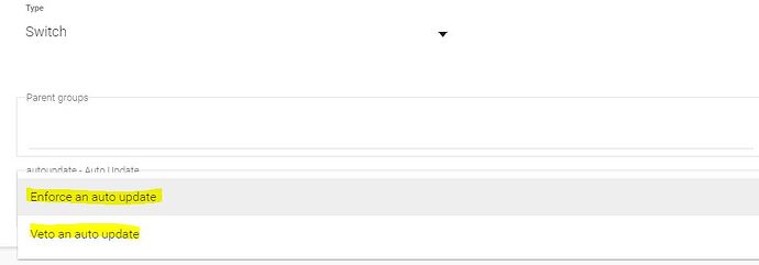

More options with PAPER UI ?
autoupdate is for what ?
nothing about that here
Not sure as I use files only but I think you have more flexibility with files. That may change with OH 3.0???
A link to autoupdate info:
Finaly found … :innocent:
