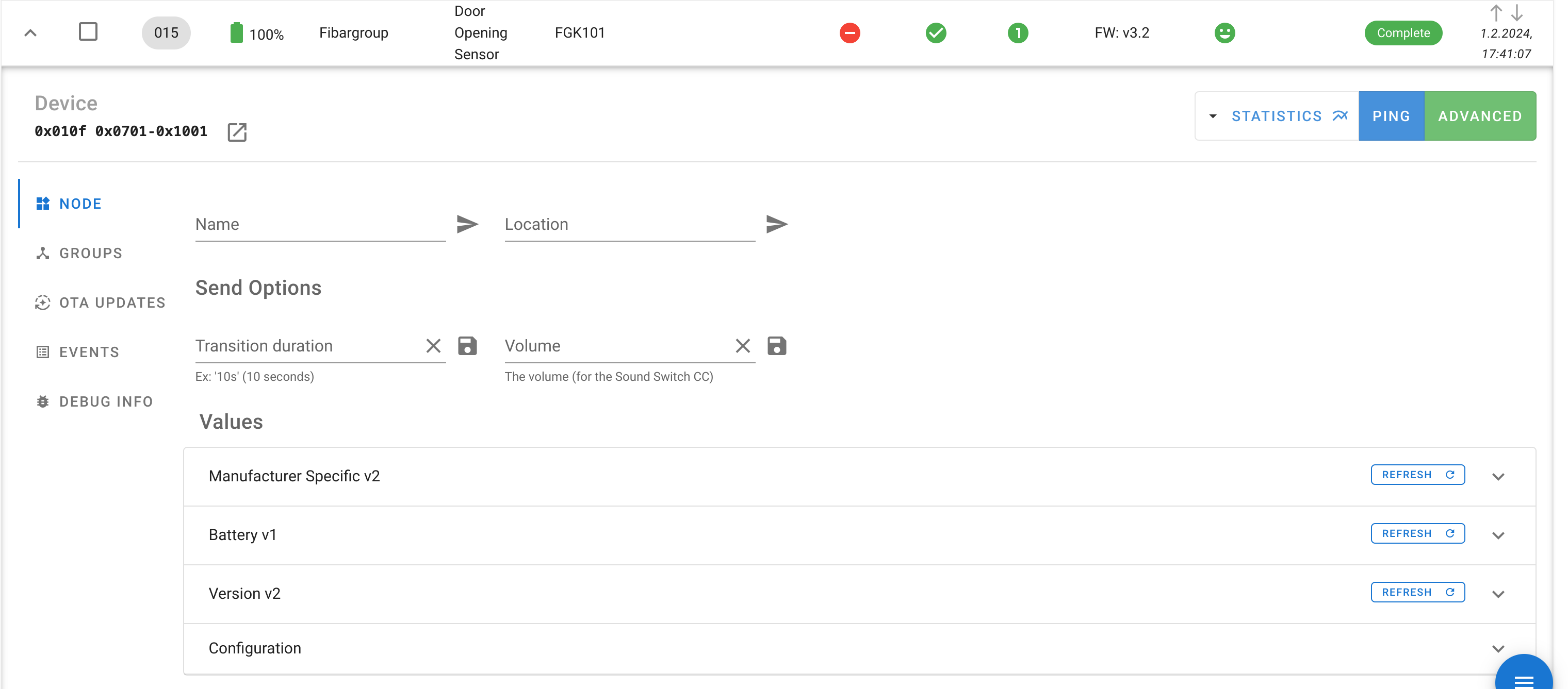

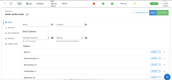

I have 2 door sensors in my zwave network
but have some issues with ther configuration
The first node id 14 is showing everything and also the basic topic:
But node id 15 is not showing any basic topic at all
How can i get this back?
Try the reinterview option then wake the device. Could be remote. What does the network map look like for hops and speed?
I reincluded them … everything now fine
