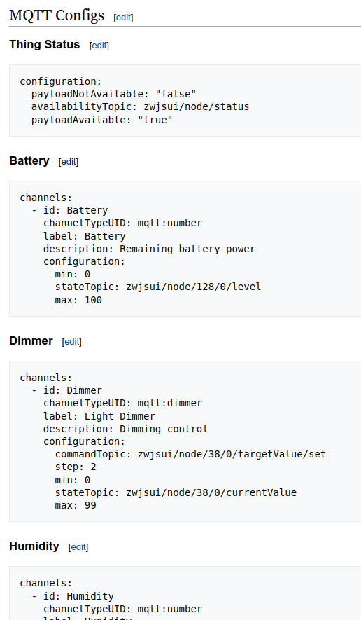

I tried setting the payload type to Just value under settings → gateway and it seems that then the json transformation is no longer necessary :slight_smile:
grafik
Example:
Thing mqtt:topic:zwave-node_41 "Node41" (mqtt:broker:localhost)
    Channels:
    Type switch : switch [
        stateTopic  = "zwave/nodeID_41/switch_binary/endpoint_0/currentValue",
        commandTopic= "zwave/nodeID_41/switch_binary/endpoint_0/targetValue/set",
        on="true", off="false"
    Type number : power       [stateTopic="zwave/nodeID_41/sensor_multilevel/endpoint_0/Power"]
    Type number : energy      [stateTopic="zwave/nodeID_41/meter/endpoint_0/value/65537"]

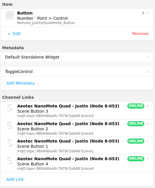

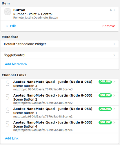

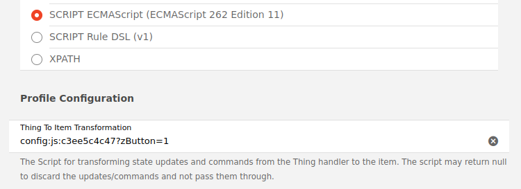

  3. This was the big one for me: On multi-button scene controllers where the OH binding would provide all the values on the same channel as [Button #].[Event value], Zwave js splits all these into separate MQTT topics and just provides [Event value]. Rather than reconfigure all my remotes with additional items for each button, I just created a quick js-script transform:
(function(data) {
  var returnValue = zButton + "." + data
  return returnValue
})(input)
And I link each of the different button channels to the same item:
And each link has a Script profile:

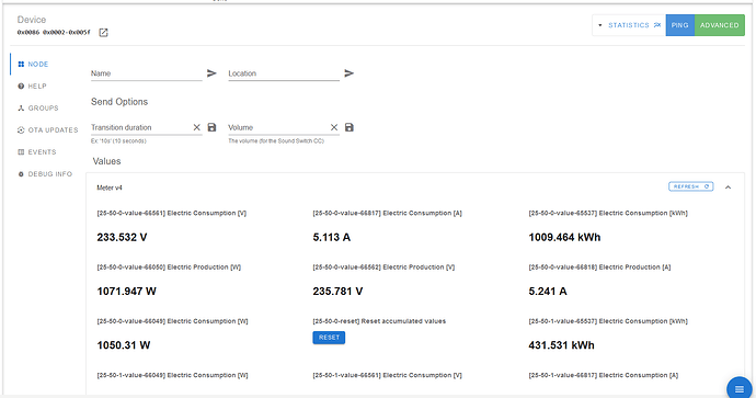

I have a HEM node which I frequently find needs a manual refresh of the values read.
In the OH Zwave binding I just issued a “REFRESH” item command to the node.
How do I issue a manual refresh of all values of the specific node now with MQTT thing command?
And another question;
The node has a “RESET accumulated values” button on the UI.
How do I “push” this button through a MQTT thing command?
I collect a midnight KWH reading for mysql persistance in DSL it looks like this; There is documentation on the zwave-js-ui github about these API commands.

I download into Excel and do the subtraction there, so am not sure about the refresh command.
Could just be topic/set like a configuration item. e.g.
zwave/25/50/0/reset (/set, or /0 or blank or 255 ?)
But I’m just guessing. Could ask on the zwave-js-ui github discussion/question tab.

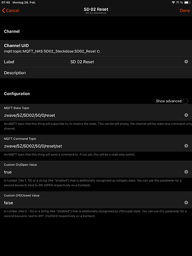

That’s how I reset the power plug values.
Topic depends on your config. I use “zwave/location/device/50/0/reset”
Use a switch channel and link a switch item to that channel. Item needs an expire time of 2 sec.
