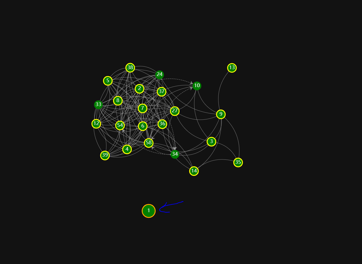

Hello All,
I was wondering what was happening with my things and some of them lost their data so i couldnt configure the devices. Then i look at the network map which got me wondering.
How come this scenario can happen ?
Thanks.

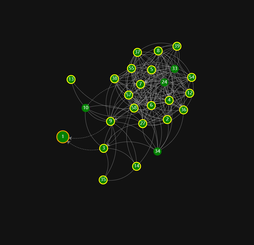

I believe the map is a UI component. This may be a MainUI issue rather than a binding one.
I agree, the map is a UI problem. I have noticed that the map refreshes overnight.
@Thomas_Roager is it just the map or is your network not working properly? In the second case it can help to remove the dead devices if you can do it with the tool. Otherwise you have to use the Z Way Software, but you will need a extra license.
I read that dead devices can mess up the network.

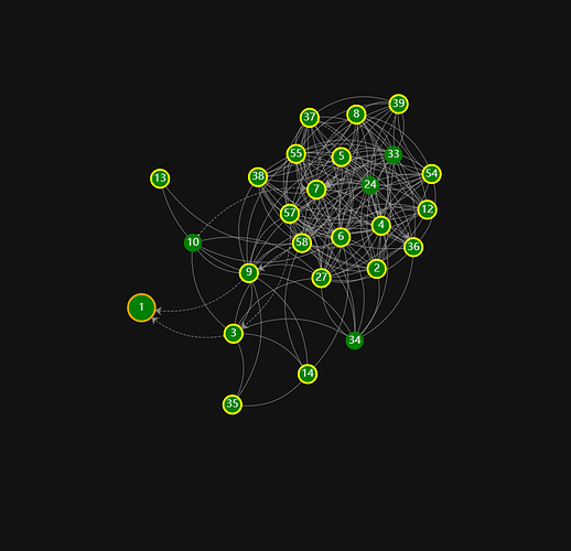

@Dadman & @Bruce_Osborne .
Thank you for you inputs, the network map seems to be looking okay again.
