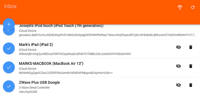

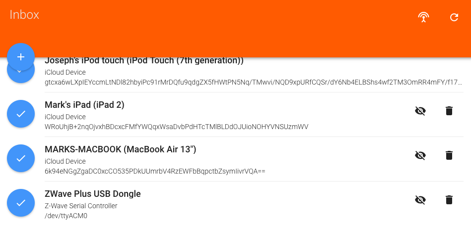

Hi…today upgraded from Build 1350 to 1358…now i have a new zwave device " ZWave Plus USB Dongle" in my INBOX of PaperUI…
What does that mean…have a working zwave infrastructure…but what is new here? Any suggestion what to do…confirm? remove the old USB debvice beforehand?
Ignore it. This is caused by a new feature in the binding which detects the dongle. It only works on Linux machines, so this doesn’t happen for everyone.

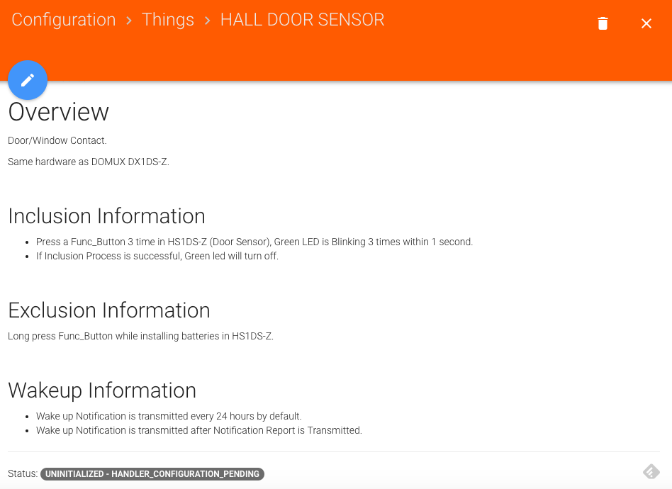

however after a reboot i now have all zwave nodes “uninitialized”…and only my old controller “online”…

1.) i realized that a new device is in the inbox (the NEW controller). did not touch it.

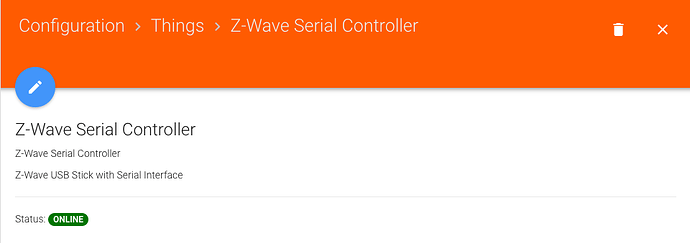

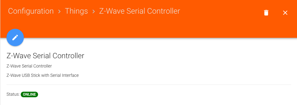

I’m seeing exactly the same… Currently have my original controller thing showing as Online, the new ZWave Plus USB Dongle sitting in the Inbox, as yet untouched and all zwave device things now show as uninitialized.
In my case it was not as the way Chris mentioned - “leave it untouched”. With original controller all zwave items were dead…even after a while or after a reboot.

All that has happened is the is a discovery process that gets some information from the OS, checks the PIDs to decide if this is a ZWave stick. If it is, it adds the thing to the inbox. If you do nothing, then nothing changes. Ignore the thing, and nothing changes.
Simples
Just ignore it, and don’t change to using the new controller. Or change to the new controller if you prefer, and then you will simply need to add all the things back as the original ones won’t work.

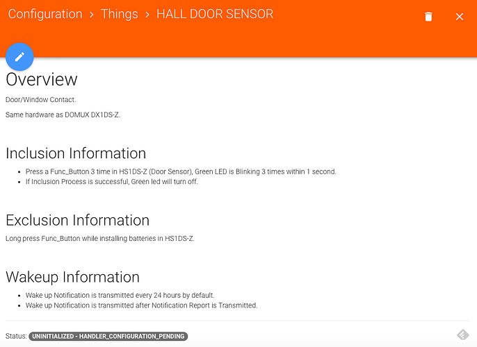

I’ve done nothing and something has changed though… None of my devices are working now and all are showing UNINITIALIZED - HANDLER_CONFIGURATION_PENDING
This is absolutely not true! I had a system update yesterday and all Z-wave devizes stopped working. No one went into the PaperUI and no one accepted the new USB device. My old serial interface was online but none of the devices were available.
This is a true bug! I have tried every other way to get it working without success. As the spouse is coming home and we have a dark house, I had to add the USB device and now it finds my devices. But with that I will need to rename all devices. Not so fun at all.
It is important that this is sorted out for other users.
It is not a bug - but it is an issue that needs to be understood, but I don’t think there is anything that can be done to resolve it.
The issue here is that if you have auto approve enabled, then the system will create a new dongle - automatically. This will cause a race condition on startup, and it’s then a 50/50 chance that the system won’t work.
This is why in the latest update notes that were issues for M4, I recommended deleting all things, including the controller. It is the only way around this that I am aware of.
