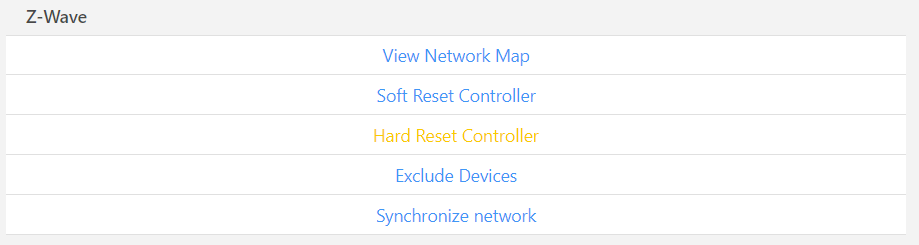

This controller has ZERO buttons, it uses the Serial API to activate inclusion/exclusion modes and as near as I can tell the ZWave binding doesn’t do it. Am I mistaken? I know you cannot perform an NMS backup of the Aeotec Gen5 or any other 500 series and restore it to the 800 series without bricking it because the 800 series has 8k smaller NMS by spec. So I’ll likely have to set up a temp OpenHAB server to include the 800 to the existing zwave network thus copying said network. But then how do I tell teh 800 series to join? I know how to set the Aeotec to include mode, but since the 800 needs the serial API to issue the join/pair command as a SUC how can I do that?
You are mistaken. From the docs:
When the discovery process is started, the binding will put the controller into inclusion mode for a defined period of time to allow new devices to be discovered and added to the network.
If you need to exclude devices, you would do so from the thing for your controller.
