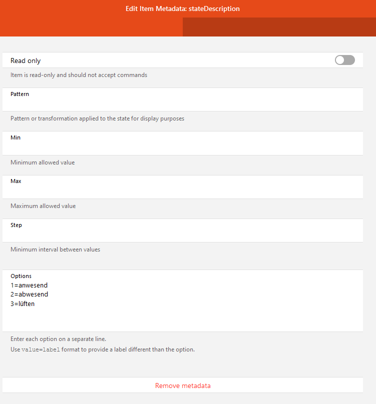

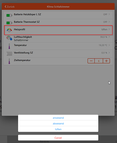

did you try it with a meta description at the item?
