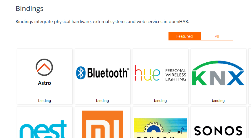

I also already raised the question but no one answered. It is also not understandable for me why this disfunctional binding (for years already) is still listed as one of the number one featured bindings onthe webpage:
