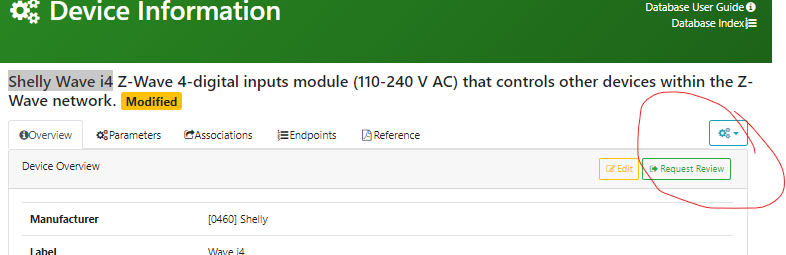

Don’t forget to “request review” on the overview tab, if you are finished.
Can ask for a review, though I still wants to test it a little more…
