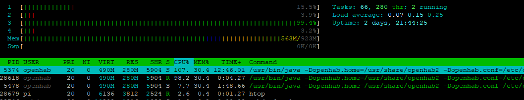

I checked. After activate the trigger I see high CPU load because of openhab process:

Check CPU load with top. It has to be well below 100% and would jump to well above once triggered.
