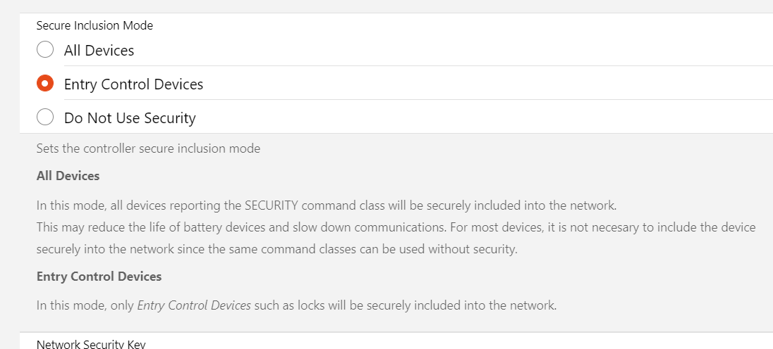

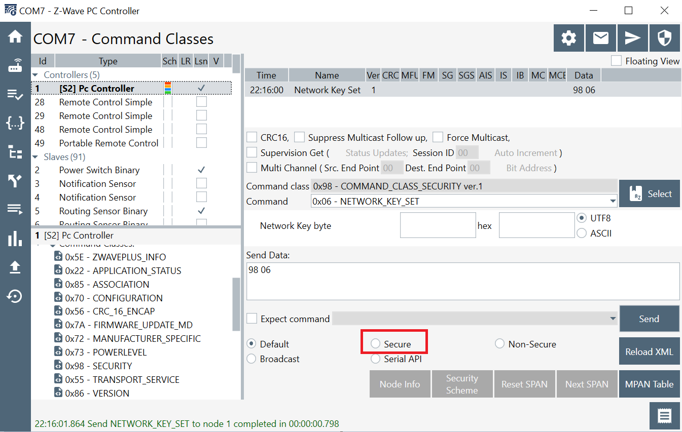

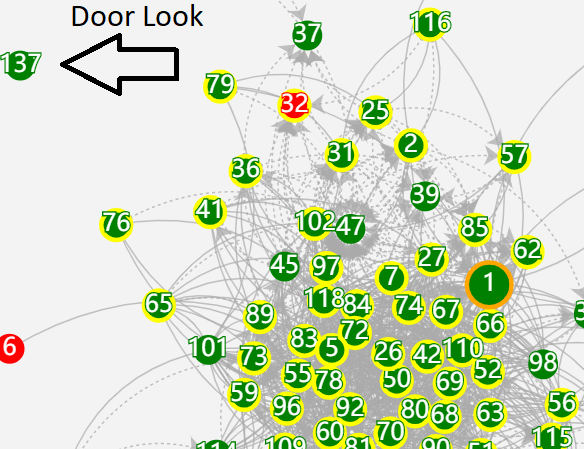

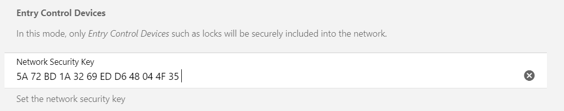

Swiched back to openhab 2.5.
I tryed everything, but I am still stuck.
Here is the Log’s:

In openhab 3 there are some options for the inclusion:
“Entry Control Devices” seems to me the right one or would you choose “All Devices”. Would that effect the conectivity to the other Devices?
@chris is likely the only one with the answer to your question.
It won’t change anything for any device that is included. This setting just sets what type of devices the binding will attempt to include securely - but it’s only relating to inclusion and won’t impact anything that is included.
Locks obviously must be included securely. Generally, most people probably don’t use security on other devices, and of course it’s up to you to decide if you are happy with that or not :slight_smile: . Security does increase traffic on the network by roughly twice, so it does tend to slow things down a very small amount, and might increase battery usage a very small amount, but likely you won’t notice either.
I hope that helps.

Would the following setting make sence to the main Controller:
The device must be included securely through the OH binding to work in OH. The security key is in the OH binding.
Yes I know, inclusion over OH :white_check_mark:
I guess you mean this key (it’s a bit longer → Just for the screenshot):
I understood that I need to change from S2 to S0 Security, is that right?
S2 security devices are backward compatible, yes. OH does not support S2

Uh, I like the Z-Wave Network Map in OH3 (but I guess that is not helpfull…):
The setting was fine already - it was performing the inclusion.
The controller doesn’t support any command classes. All the commands on the “controller” side are managed in the binding alone.
What do you mean by this? I’m not really aware of a way to switch - the binding will resolve this normally. Or does the device maybe have a way to prevent S0 being used?
