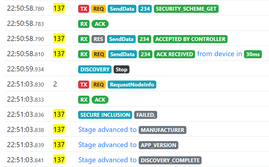

I would suggest to start the binding, wait a while (let’s say, 1 hour), then try the secure inclusion. In this log at least, the binding is still initialising, and this is causing delays. Eg in this log, node 2 is not responding to the NIF request, and that is occuring during the inclusion, and that adds 10 seconds of delay to the process which is too long.
@chris what do you mean by start the binding ?
Do you think it will help to unplug Node 2 which is causing problems?
@Bruce_Osborne thx for the suggestion with the Log Viewer. I don’t know how to find the root cause of my problem, but to me it seems that the Secure inclusion Failed:
The binding is started normally when OH starts, but it can also be stopped and started separately using the console.
No - this will only make things worse as then it’s guaranteed that the device doesn’t work.
Yes - this is what I said earlier. The cause is the delays that occur before this part of the log that you are showing here.
Thank you for your help.
@chris Node 2 was in fakt the problem. I removed the node completely. Then did everything I did before (Reset Door Look, Switched it to S0 then inclusion over OH).
I would never ever thought that this device(Node 2 a Switch, which wasen’t even pluged in since log) is the root cause. By the way, the “Log Viewer” is there realy a awsome tool finding those problems.
Thanks a lot for your support and patience!!!

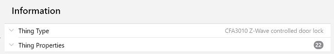

Hi Chris, hi Bruce,
after upgrading to openHAB 3 (v3.1) I did a complete new inclusion of all my Z-Wave devices and they were all discovered fine except my ABUS CFA3010 door lock (similar to hofie81 above).

and the device remains as “unknown device” in the thing’s overview - no matter of how long I wait…
I tried inclusion several times, always with the same result.

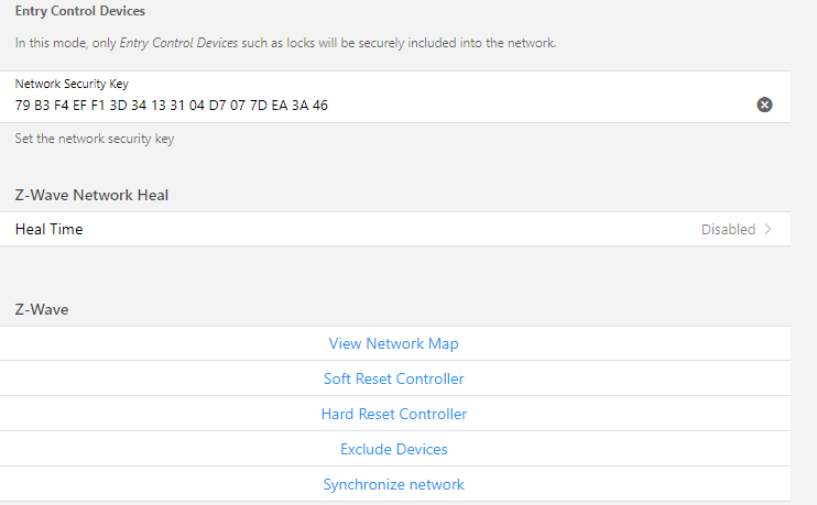

So no real experience with security, but reading the log it says invalid 8 bytes code. On my zstick the security is 16 bytes. Click on zstick thing, advanced.

Hi apella12,
this was the solution: I changed the network key of my controller to 16 bytes and the door lock was included without error message.

Of course - stupid me.
I was looking for a setting to be changed from 8 to 16 (byte)
Mine is already on 16.
Thanks for opening my eyes, Bob
