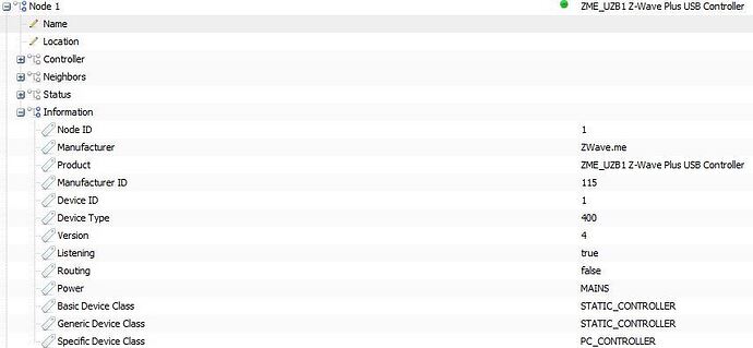

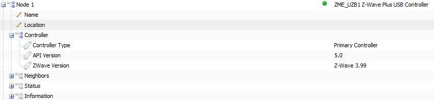

What do you mean by that? Data from the controller? Okay, here you go:
Yes.
Thanks, this is what I was asking for: “ZME_UZB1 Z-Wave Plus USB Controller” I meant the series of the controller :slight_smile:
