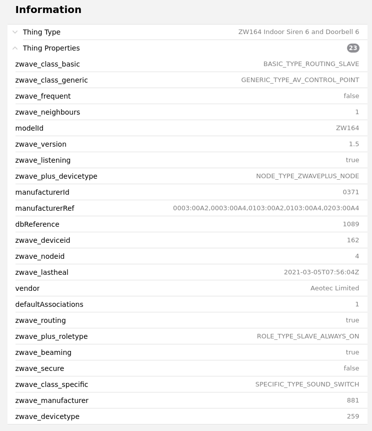

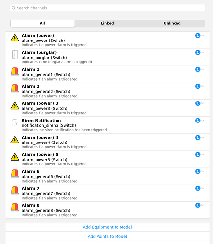

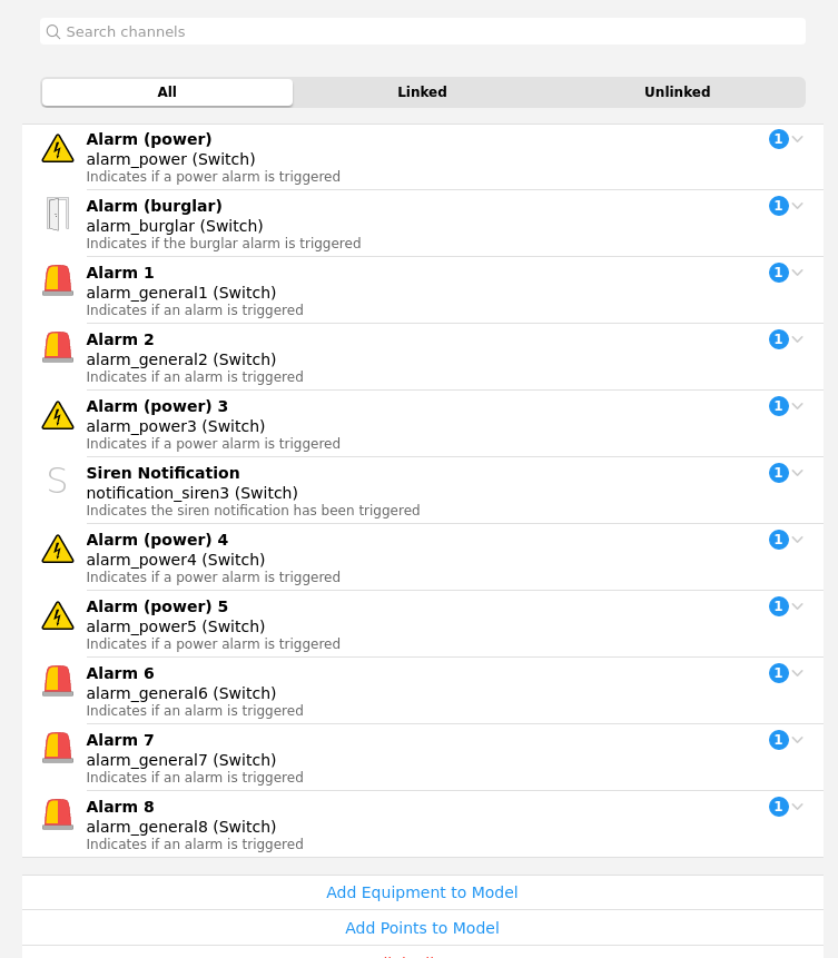

I have just paired up one of these Doorbell 6 units to my OpenHab hub.
Here are the Channels that show as available. They all show as “Switches” but when I create toggle cards for them, I can’t seem to get any of them to trigger. Has anyone figured out how to actually get this device to Chime based on other actions, such as a Door Sensor opening?
Thing Information:
