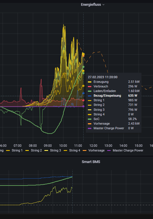

today, at ~11:20 AM all persistence services suddenly stopped working and I see absolutely no reason why…
They don’t really stopped working, I can read the data, but no data is stored anymore since ~11:20 AM.
What is strange, I have InfluxDB for some Grafana stuff und also RRD4j for the usual Item graphs inside OpenHab. And both of them stopped saving at nearly the same time. In Log Viewer nothing is visible, no red Lines…

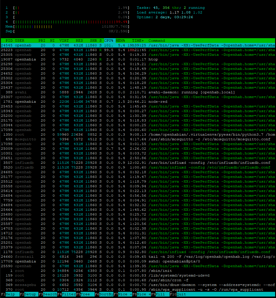

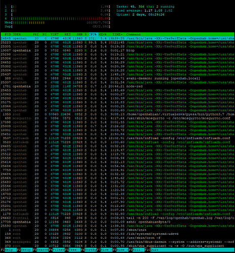

It seems OH3 is using a lot of cpu, but no idea why, I’m doing nothing there atm:

Looking at the screen shots (which are almost impossible to read on a phone unfortunately) it’s weird that one of your CPU cores is pegged and the other three are basically idle. That points to a process run amok.
