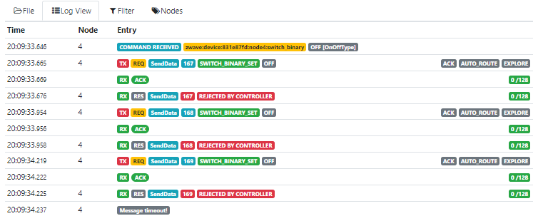

I’ve enabled zwave debug logging and I did see a ton of messages (too much to post here) but some interesting ones that stand out are along the lines of “NODE 41: Retry count exceeded. Discarding message: TID 3404: [CANCELLED]”
I waited for the noise to settle and I tried 1 action (toggle a switch) from basicui and got these log messages:

I’m not an expert on all the reasons the controller will reject commands. However, one major candidate is that it is overwhelmed (not defective). If you look at the timing in the snippet the binding is set to wait 250 ms before resending the command, but after 3 times it gives up. The binding looks good to me. That leads back to the ideas by others regarding zombie nodes. Also, if I picked this up correctly from your file you have polling at 2 hours. I have polling for powered devices at 10 days (the max) and for battery devices 1 day (just to get a daily battery reading). Increasing the polling interval probably won’t solve the problem, but it could help reduce traffic. I also do not use the command poll, but that is controversial. Between auto-update and visual confirmation (yes, the light is on!) I feel I’m covered. A great post on Zwave issues is here. IMO -I’d try to get the current situation better, before going the docker route

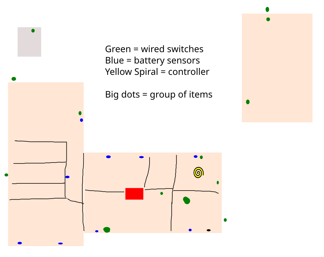

to follow up on what Bob is saying, how many nodes in your zwave network?
how many mains powered how many battery
rough layout (number of floors, construction - frame/masonry)
taking a stab at this after watching conversation.
