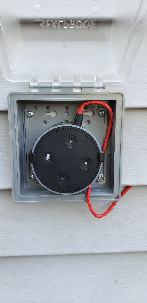

I permanently mounted an Amazon Echo Dot outside while in the Covid-19 lock down to better integrate OH in the backyard. We’ll have to see how it does with the extreme temperatures changes 95 F to -25 F around here.
Since Amazon doesn’t expose the microphone MUTE option via their API, I have OH setting the Echo volume levels to 0 when the patio door is closed OR when gUnifiPhones are OFF OR between the hours of 10 pm - 7 am to prevent “some level” interaction with it.
I drilled holes in the clear cover on the front and bottom in order for it to listen/speak which it actually picks up our voices 15’ away which is surprising.
Here are the supplies I used:
Sealproof 2-Gang Weatherproof In Use Outlet Cover | Two Gang Outdoor Plug and Receptacle Protector, Lockable, UL Extra Duty Compliant, 45 Configurations Amazon.com: Sealproof 2-Gang Weatherproof In Use Outlet Cover | Two Gang Outdoor Plug and Receptacle Protector, Lockable, UL Extra Duty Compliant, 45 Configurations : Baby
eBoot Solid Metal Wall Mount… Amazon.com: eBoot Solid Metal Wall Mount Stand Holder Stand Bracket for All-New Echo Dot 2nd Generation (Black 1) : Electronics
TayMac MX3300 One Gang Horizontal… Amazon.com: TayMac MX3300 RaynGuard Extra Duty Metal Weatherproof in-Use Cover, 1-Gang, Gray : Industrial & Scientific

Have you thought of cutting the power-supply to the Echo via something like a Sonoff switch ? Echo takes about a minute to boot, so that could be integrated into your rules so that Alexa is ready for you when needed
I did think about this but the issue was the size of the weather proof gang box to insert a power-switch inside it. I have WeMo’s here and it’s power plug would not fit in there. The actual power block for the Amazon Echo by itself barely fits right now - had to bend the USB cable at a 90 degree angle to get the door to shut on the GFI outlet.

It has made it through a Chicago summer with rain, wind and a lot of high humidity w/o any issues.
The clear plastic cover has started to dis-color a bit from the outside variables.

How did the outdoor setup fare through the winter? I’ve been thinking of doing something similar and would love some real-world results. Thanks for sharing.
Everything is still working perfectly! I had to reboot it maybe 3x over the winter but that was it. Negative 20 F below degrees and summer with 90 F degrees. I am actually shocked it has worked with such a range of temperatures.
