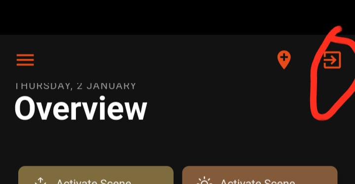

Problem 1)
Specifically, I find the Overview page which appears in (mainui as standard) to be a liability since it invites the (let’s assume unsophisticated) user to click on the “Sitemaps/exit” icon in the top right. This leads to an error page of “Openhab returned an empty Sitemap list” which is VERY user unfriendly - a user wouldn’t expect this from a high quality system , so as the admin, I want to get rid of it. Is there any way to remove this icon?
A workaround is to set a tab page in MainUI as a startup page. This does not have the sitemaps icon in the top right, but the problem is it does have a hamburger menu in the top left … clicking on this reveals a slideout menu with any other tabbed pages and also the Openhab logo… so far so good (from a user perspective since no ugly errors) but clicking on the logo unfortunately brings me back to the Overview page with the Sitemap link in the top right… Sitemap icon problem again.
Problem 2)
In the example above I am not using any authentication and just using the android app as is. It would be more elegant to define a specific user role - let’s say “guest” - logged in to the app on the tablet which is in any event, for guests’ use. In my case I have found that the app frequently asks for authentication - I would like to have a “remember me” option so that this does not happen for, say, 30 days. Also I would like to be able to prevent the guest from being able to change their own password (since I will have different guests - I don’t want to have to delete and recreate user roles each time someone changes the guest password and doesn’t tell me)… At present I don’t think this option is available.
Any guidance on elegant solutions I or even hacky workarounds would be appreciated.

Whilst it’s not 100% tamper-proof, here’s what you can do:
  • Create a Layout Page
    In the Code, enter this:
  layoutType: fixed
  fixedType: canvas
  gridEnable: false
  hideNavbar: true
  hideSidebarIcon: true
  scale: false
  screenHeight: 1080
  screenWidth: 1920
  sidebar: true
Adjust the screen resolution to suit.
I use a Raspberry Pi/Debian, and I have Chromium browser run full-screen on X startup directly to the page’s URL. This way you can configure specific tablet to load a specific page for that room.
I don’t know how to set this page to load by default on Android. If you could hide Android’s system navigation buttons (bottom of scrreen) so user can’t press “Back” or menu or something… it might work.
Works thanks.
This hides for all users, of course, including admin.

Uninstall BasicUI.
OH has two roles, user and admin. If he implicit user role is enabled, accessing OH without logging in assigns the user role. The user role can only access Pages, Sitemaps, and interact with Items. All the settings and other menus are not shown and access to the portions of the rest api to muck with those is locked down.
Furthermore, you can choose to show/hide widgets and even whole pages on a role basis or even in a user basis, but I don’t know if the later can be done when using the explicit user role (i.e. not logging in).
This is between you and the browser you are using. The browser is throwing away the cookies with the login credentials. OH doesn’t expire the credentials automatically. On my home machine I remain logged in pretty much until I clear the browser cache.
I actually don’t think there’s is a way to change the password at all except by ssh’ing to the machine and using the karaf console. But if you use the implicit user role your guests shouldn’t even need to log in at all.
Only if they are in the admin role.
The user role can’t access nor change those settings, even if they are knowledgeable enough to use the rest api directly.

If we take an unauthenticated user, on the app, on reaching the Overview page they are presented with an Exit button. One would assume that clicking this button will exit the app…
However this does not appear to be the case - I get this:
A non-savvy user would not know, and arguably should not need to know, what a “Sitemap” is.
It has been suggested that I could delete Sitemaps - but would that really remove this page such that an Exit Button really leads to an exit?
Instead, in the current form of the app and setup, the user is forced to click on the hamburger menu to get away from this screen and the following appears:
A user also should not need to know what MainUI is. For a smooth user experience, this menu should not be appearing in its current form, and arguably should not need to appear at all.
One solution is to make the Overview page invisible to unauthenticated users (am aware of isVisibleTo); and have a preferred landing page (defined in the app) other than the Overview page. The problem is that when you do this, the Openhab logo in the sidebar menu is still clickable: it takes you to the (supposedly blocked) Overview page… and from here there is the problematic Exit button .
I have tried hiding the sidebar, and hiding the navbar but these changes are hacky and frankly - make the experience less nice. The menu looks good and is useful for other pages. The Navbar looks good too as Maintainers designed it.
Part of the problem appears to be that we are trying to make a “Settings” button available (in the sidebar menu, after the exit button has been clicked), and to do this for all users whether authenticated or no. The pincode/biometric authenticator in the app provides some security that settings can’t be changed by just anyone.
So one solution is to accept that a Settings button is needed, simply and move it into the main pages sidebar of the app.
Another solution is to use some form of login. As pointed out, different user roles are already available to be defined.
However in the app this is more complex; the app appears to require you to log in repeatedly ( this is between me and the app, not me and the browser), so some kind of “remember me” function would be great. Bearing in mind that for an android tablet on a wall in a house, there will be multiple users perhaps sharing the same login (if we decide that logins are the way to go - not sure that they are), however the admin needs to be able to block the ability of a user to change the password. At present this is not possible - in the app the authenticated ‘guest’ user can change their ‘guest’ password to anything they like - and the other guests sharing the same login will no longer be able to access Openhab - this is a problem.
I hope this helps crystallize the problem that I am seeing. This is amazing software - I hope to see access to Openhab going beyond the tech savvy.
How do you suggest do reach app settings in that case? I don’t think the deep integration between app and web UI you’re suggesting is viable with the amount of man power we have. Don’t forget there’s also more features like NFC that could appear in that spot.
I’m not saying there’s nothing that can be improved (the exit button probably shouldn’t be shown if there are no sitemaps configured), but the general argument of any kind of complexity overwhelming any non tech savvy user seems a bit contrived to me.
@mueller-ma I guess we should have an interface for communicating to MainUI whether or not to show the button.
Open MainUI in the browser on the phone.
Tap the three dot menu
Tap “Add to Home Screen”
MainUI is a PWA so you can add it as an app to your phone independent of the Android app. Of course you lose out on all the features the Android app provides such as notifications, divice info sharing, etc unless you also install the app. But if BasicUI isn’t installed nothing should be shown as an option when tapping that exit icon.
