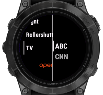

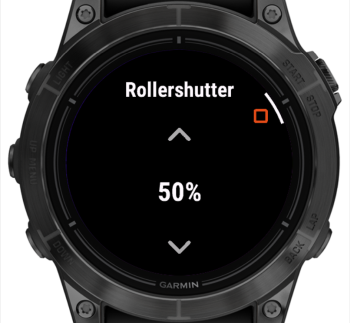

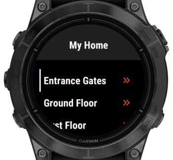

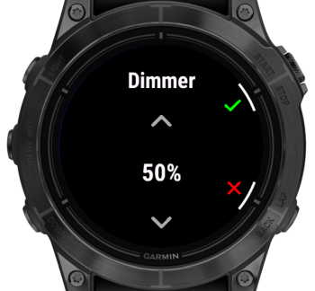

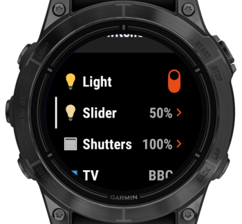

The screenshots below show, clockwise from the top left: the menu structure for a sitemap page, the slider/setpoint widget, the rollershutter widget, and a multi-option switch.

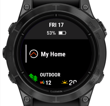

Here are a few screenshots from the latest iteration of the app:
The glance serves as the app’s entry point and displays the label defined in your openHAB sitemap.
