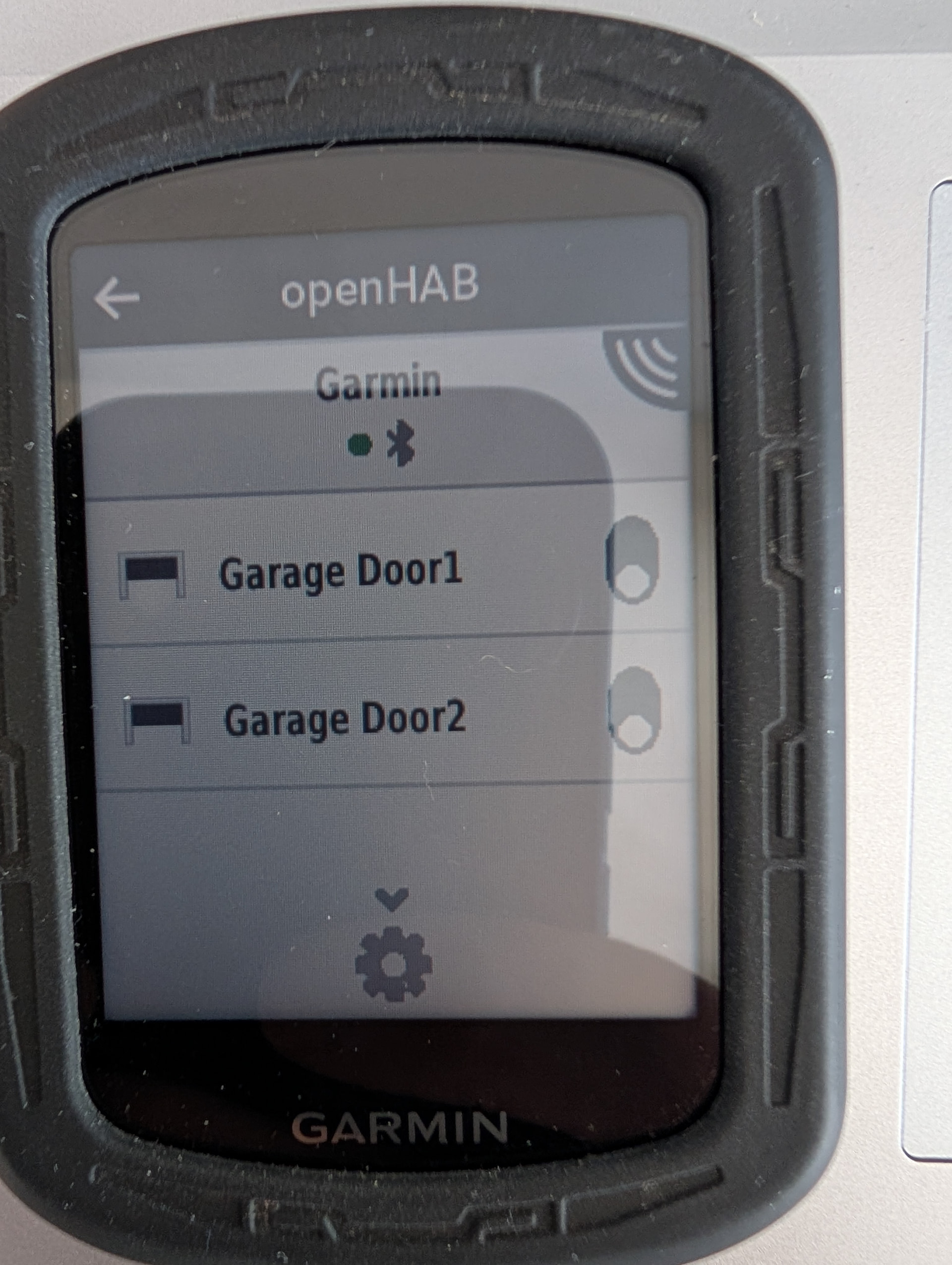

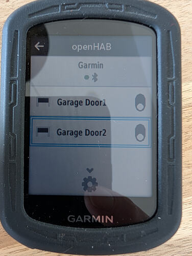

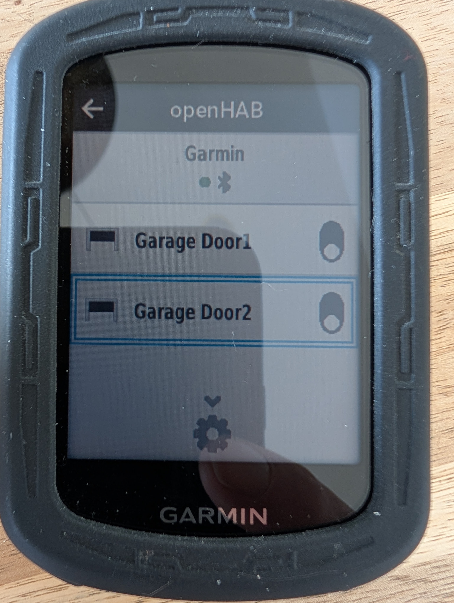

Latest beta much looks much sharper on the Edge 840. I like the placement of the connection icons better as well.
Thanks for the feedback. What does it look like when you activate the focus indicator? In particular, how are the menu item dividers rendered?

@g_g_rich, another request for testing:
On your Edge 840, when using the buttons to scroll down past the last menu item, does it enter the settings menu or wrap directly back to the first menu item?
The other open issue is the occasional “Sync Failed” error observed by @agrarina and myself (#227). I am still investigating whether there is anything the app can do to prevent this. So far, it appears to affect only certain devices. I see it regularly on my Epix Pro Gen 2, but I have not encountered it yet on the Edge 850.
Using the buttons on the Edge 840 the selector wraps to the top and you cannot navigate to the setting.
