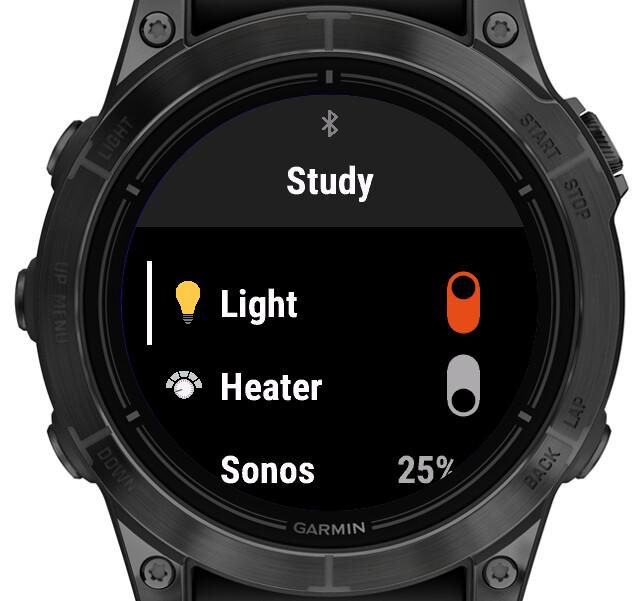

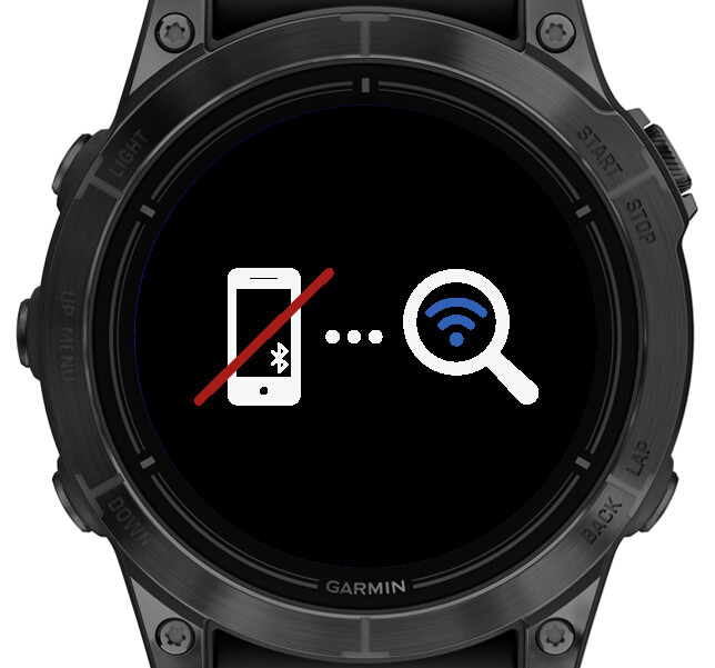

I have just uploaded v1.2.0-rc6, which introduces a permanent connection mode indicator. It uses a Bluetooth icon for phone connections. When the app switches to Wi-Fi mode, the Bluetooth icon turns red and is complemented by a blue Wi-Fi icon.
I also experimented with phone-shaped icons, but they did not work well within the limited screen space. Even the Bluetooth symbol is not immediately recognizable at this size, but I believe it performs well enough in context.
An interesting challenge was the visual alignment of the Bluetooth and Wi-Fi icons. Because of their different shapes and colors, they appeared clearly misaligned when positioned using purely geometric alignment. I therefore adjusted them visually instead. The result looks balanced to me, although perception still varies slightly depending on the viewing distance.
The screen displayed during the initial Wi-Fi search has also been improved.
If no connectivity is available, the app now switches to a full-screen error view. Previously, this state was indicated by a text message only. It is now presented using aligned status icons for clearer visual feedback.
Let me know what you think.

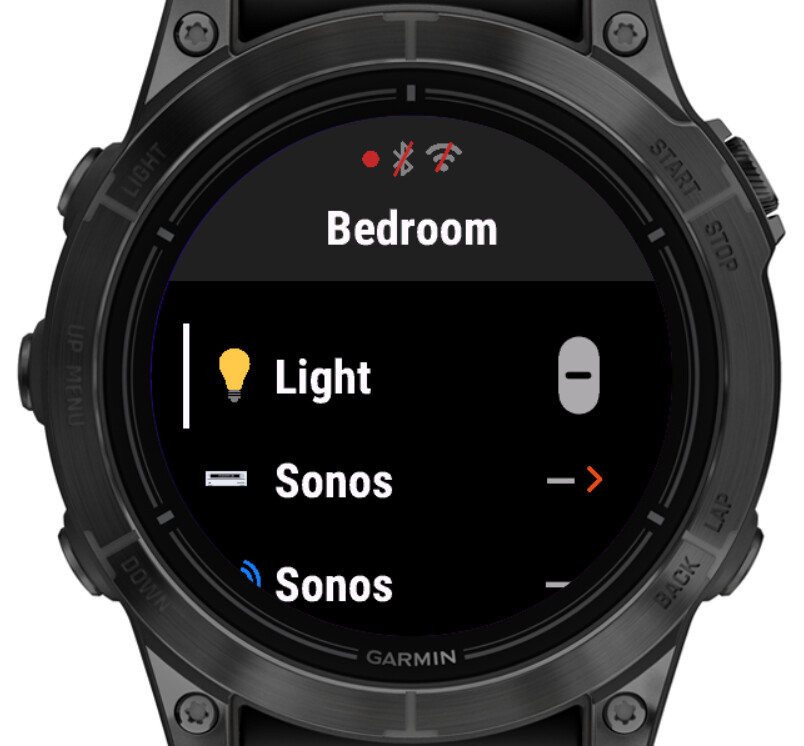

After using it for a while today, I felt that the colored connection indicators were somewhat cluttered and not as readable as they should be. Therefore, in v1.2.0-rc7, I switched to monochrome icons, using only a red slash to indicate a missing Bluetooth connection.
I was still not fully satisfied with the Wi-Fi implementation, so I moved the development back to beta stage and revised a few things.
v1.2.0-beta12 is now available with the following changes:
The full-screen views for Wi-Fi search and offline mode have been replaced by the regular menu structure with limited functionality. This simplifies the implementation and also improves usability: when starting the app without Bluetooth, the time spent searching for Wi-Fi can already be used to navigate the menu.
A full-screen offline error is now only shown if no cached sitemap is available.

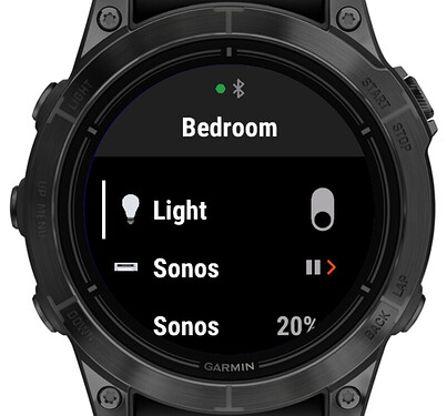

For better clarity, a new three-color connection status indicator has been introduced:
  • Green: Bluetooth, full functionality
  • Yellow: Wi-Fi, states are not displayed and commands are sent via Wi-Fi sync
  • Red: Offline, menu navigation is possible but commands cannot be sent

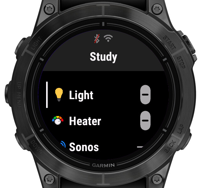

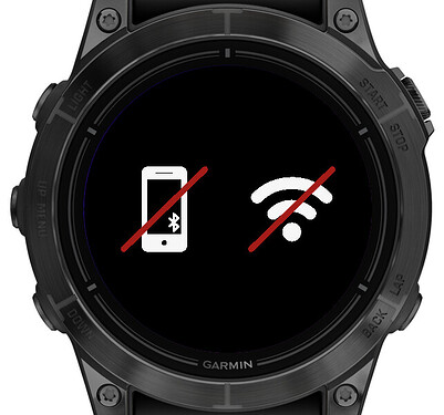

Here are some screenshots:
On Bluetooth connection:
Searching for Wi-Fi:
In Wi-Fi mode:
Offline:

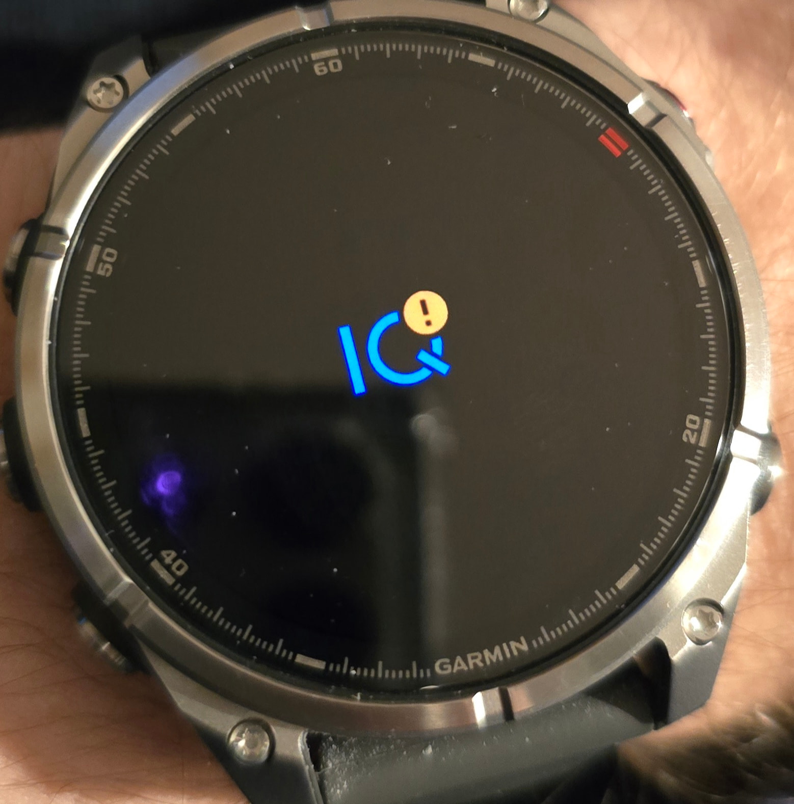

Has anyone encountered a problem where the Robert app works normally when the phone (Android) is unlocked, but when you launch it while the phone is locked, the attached icon appears on the watch?
Whatever the underlying issue is, the crash definitively should not happen, I need to fix that.
Are you on the stable version or the beta version?
Which watch is this?
Edit: created a ticket for this, if you are on GitHub you could also post details there:
https://github.com/openhab/openhab-garmin/issues/271
Hmm, that’s strange, but sometimes it loads normally (even when the phone’s screen is locked), so it’s probably not related to the locked screen.
App version v1.1.3 on Fenix ​​8Pro watch - if generating some JSON or other diagnostics would help, I’d be happy to do so.
Please find video below. Watch is very responsive but once when get out of app with BACK button then opening again didnt work

App Crash
@stonke thanks for the video! Could you install the beta version and see whether the issue still occurs? A few things changed in the v1.2.0 betas that also affect the startup routine, so I’d like to use the beta as the baseline for investigating the issue you reported. Here is the link to the beta app: https://apps.garmin.com/apps/b55277ba-9ecd-4082-8b80-692426241291.
First video on 1.2.0beta15 with same sitemap like yesterday
Second video with same app same map(after crash above)
Last video on same beta app but light sitemap (as we have had previously problem with memory on my old venu2)- as you see 4seconds after map loaded Garmin error appear(without any touch(
Thank you very much.
I investigated the issue further and reviewed the anonymized crash reports I received. This is the same problem I mentioned as unresolved when I released v1.1.3. Since then, I have added additional diagnostic code to the app, which has helped me confirm more precisely where the crash occurs.
At this point, it appears to be caused by a bug in the Garmin API rather than in my own code. Other developers on the Garmin forum have reported similar crashes in their apps. The issue seems to be limited to the newest generation of devices. I am seeing reports from Vivoactive 6, Forerunner 970, Fenix 8 and 8 Pro, as well as Venu 4, but none from older devices such as my own Epix Pro Gen 2.
The good news is that I believe I can implement a workaround by replacing the affected API call with my own implementation. This should be possible without too much effort. Unfortunately, Garmin does not have a strong track record when it comes to resolving such issues quickly, so waiting for an official fix may not be very productive. Nevertheless, I have submitted a detailed bug report to Garmin, including source code and error logs.
