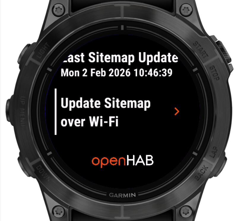

Wi-Fi
Some Garmin wearables can also connect directly to Wi-Fi. This allows access to the local LAN and, if Internet connectivity is available, to services such as myopenHAB.
When connected via Wi-Fi, both HTTP and HTTPS are supported.
Garmin does not allow a permanent Wi-Fi connection. Instead, the app must enter a dedicated sync mode, perform its network operations, and then close the Wi-Fi connection again. While this sync is active, Garmin displays system-provided views to inform the user about sync progress.

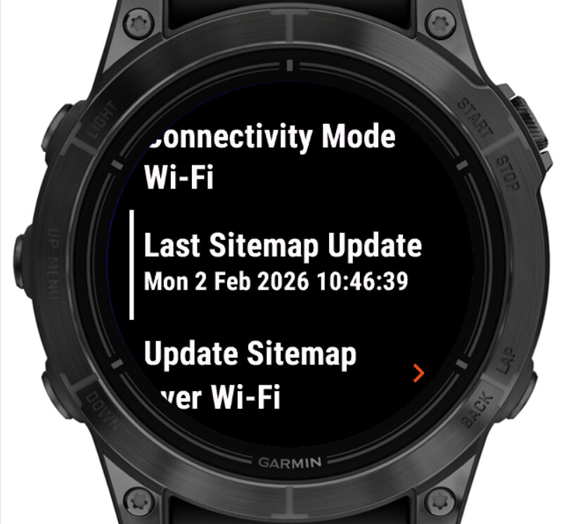

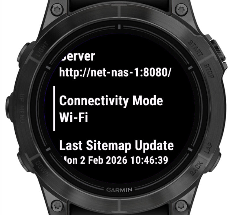

Automatic Wi-Fi Detection and Mode Switching

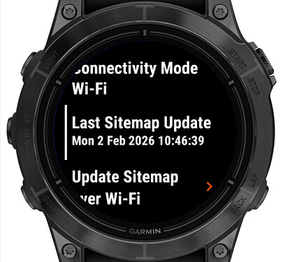

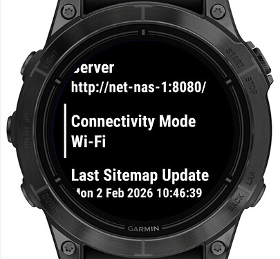

If no BLE connection to a phone is available, the app automatically checks whether a Wi-Fi connection can be used and, if so, switches to Wi-Fi mode. These checks continue while the app is running, and the app may switch between BLE and Wi-Fi connectivity at any time.
As described above, when running in Wi-Fi mode no live item states are displayed. The current connectivity mode can be checked in the settings menu.
No Polling of Sitemap Changes and States
Due to these limitations, the app does not regularly poll openHAB for sitemap changes or state updates while in Wi-Fi mode. As a result, item states are not displayed.
Only if no data is available at startup, for example after settings changes or a fatal error, the app enters sync mode to retrieve the full sitemap. The settings menu shows when the sitemap was last retrieved, and the user can also manually trigger an update via Wi-Fi, for example to download structural changes to the sitemap.

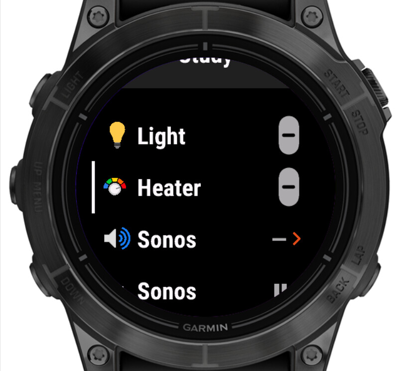

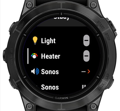

Sending Commands

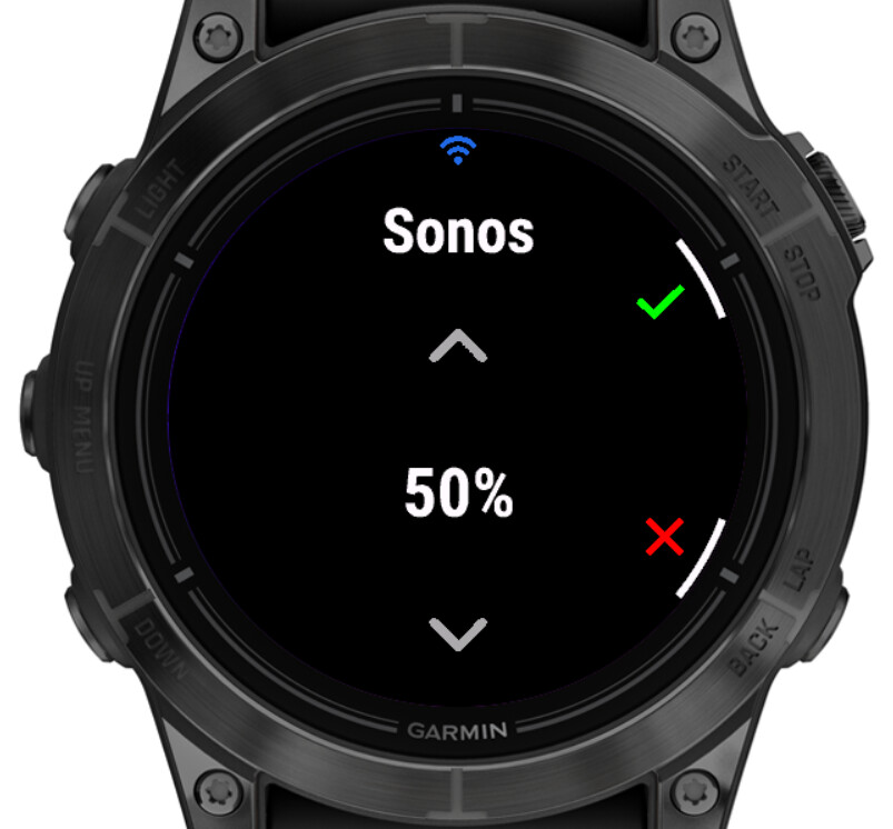

Because current item states are not available in Wi-Fi mode, sending commands cannot rely on existing state information. For toggle switches, this means the user must explicitly choose whether the item should be switched on or off via an action menu.
Another example is the Slider. In Wi-Fi mode, the slider always starts at the middle of its range and operates in releaseOnly mode. The command is sent only when the new value is confirmed, not while the value is being adjusted.

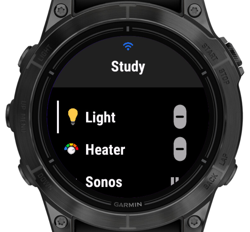

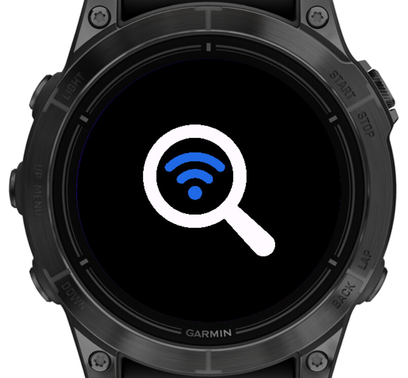

Just uploaded v1.2.0-beta7. This release replaces the Wi Fi check and loading text messages with icons and adds a Wi Fi mode indicator to menus and full-screen widgets.
Another issue remains: the Player variant of the Switch widget does not yet work without a state. If no state is available, it shows Pause, and in the full-screen widget only the Play command can be sent.
