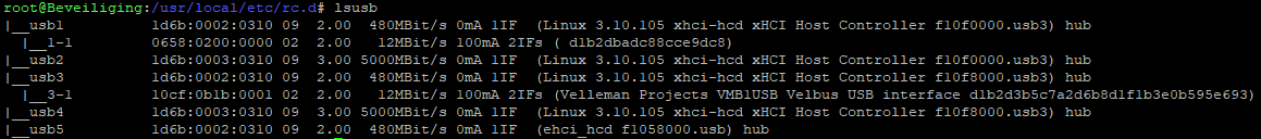

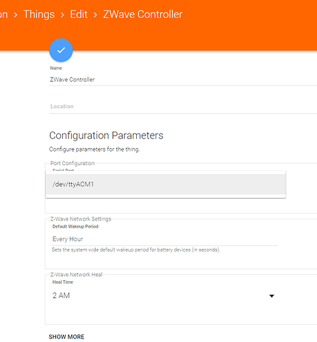

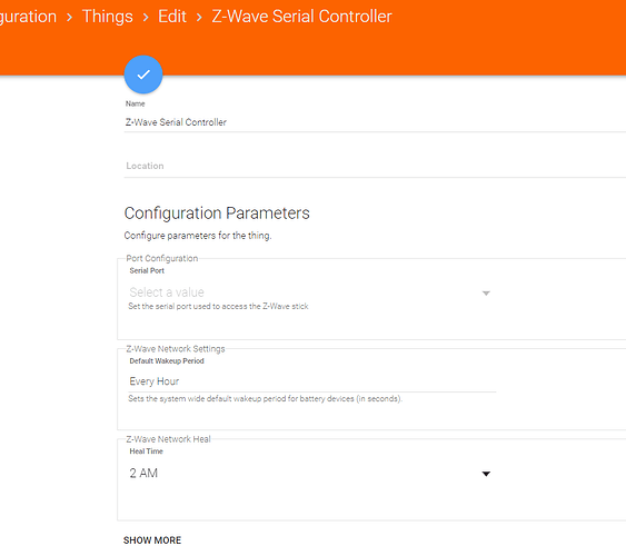

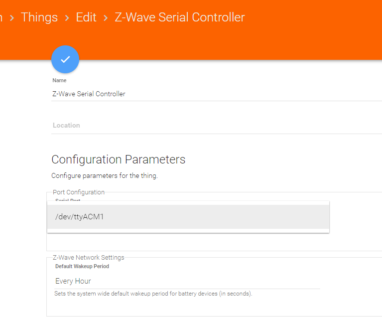

My stick in inserted in the ttyACM0, and in the ttyACM1 i have my Velbus system connected.
When i want to add the Z-wave stick i can only select the ttyACM1…
