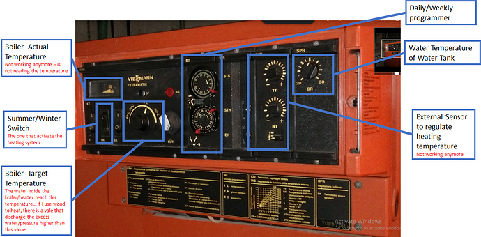

I have a picture of the boiler… I think that all I need to do is being able to switch on/off the “winter/Summer Switch” based on a temperature prefixed…
is that too simplistic? (this is exactly what my dad is doing manually (on, when is cold… off, when is too hot :P))… he believed that the weekly/daily programming clock (where he used to turn off the heater at night), does not work anymore… and therefore the heater is on or off… that’s it…
Not possible to say from here, really. You’re kind of hoping the water tank, boiler, and heating thermostats are still providing sensible control of the system.
I wonder if the inoperative temperature sensor is the root of the trouble.
