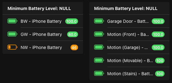

I am getting NULL for minimum battery level. Is there something I need to configure to fix this part?
Did you define the Group with the MIN aggregation function? If so has any of its members been updated since adding the aggregation function? Are all members of the Group a Number type Item.
That that was it Rich. I didn’t even know you could, thanks for the pointer!
