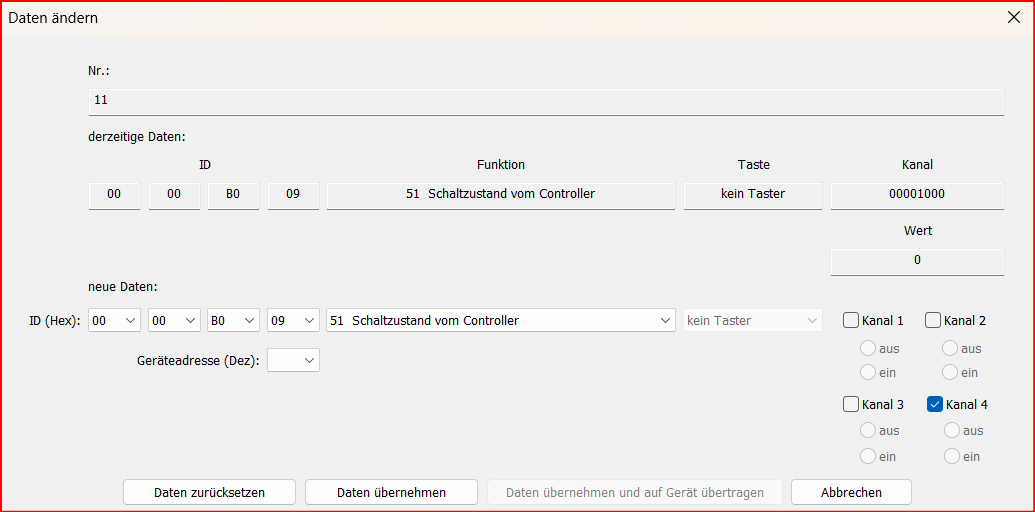

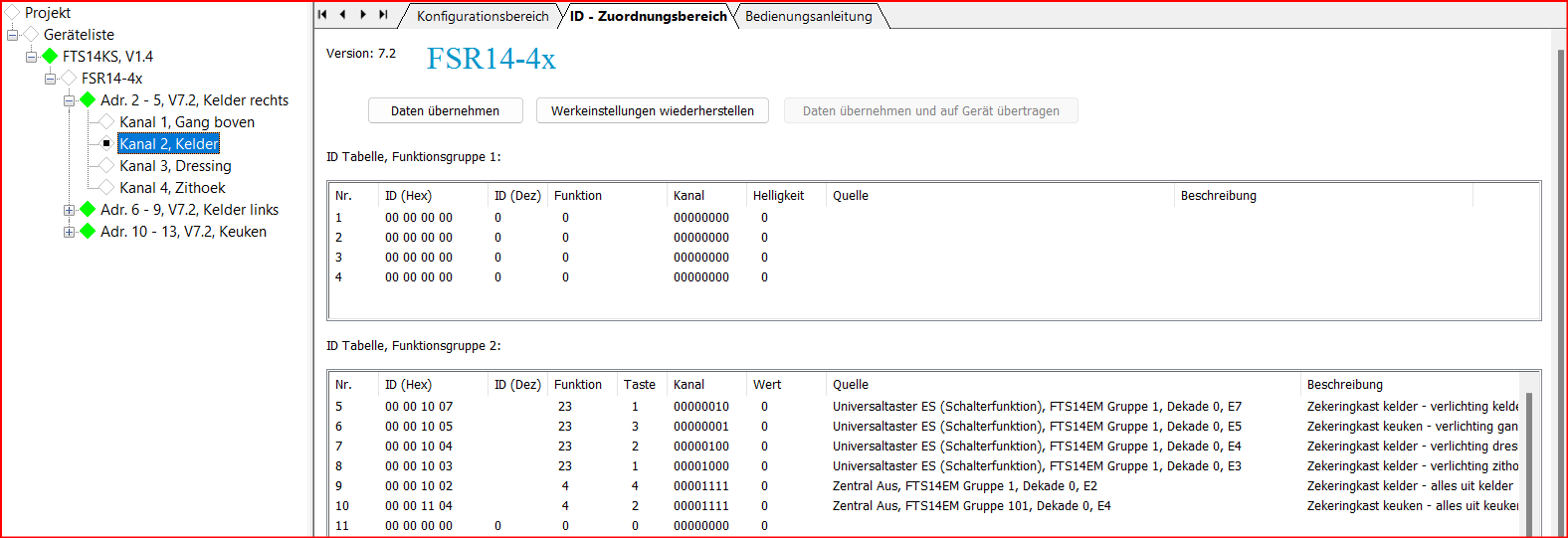

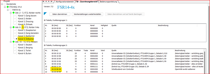

You can setup everything with PCT14. I made an excel file for my setup where the addresses are calculated.
You can write the openhab IDs (gateway base id + address) into your enocean devices via PCT14 and then create the things in openhab with the associated IDs (Base id + address).
The teach in via Openhab is not necessary.

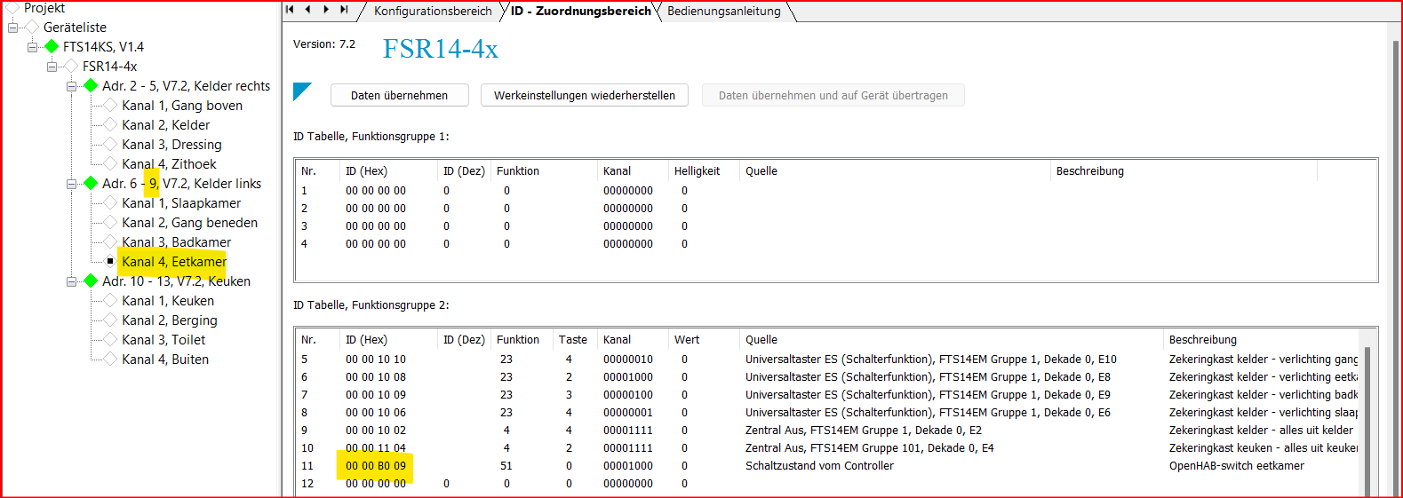

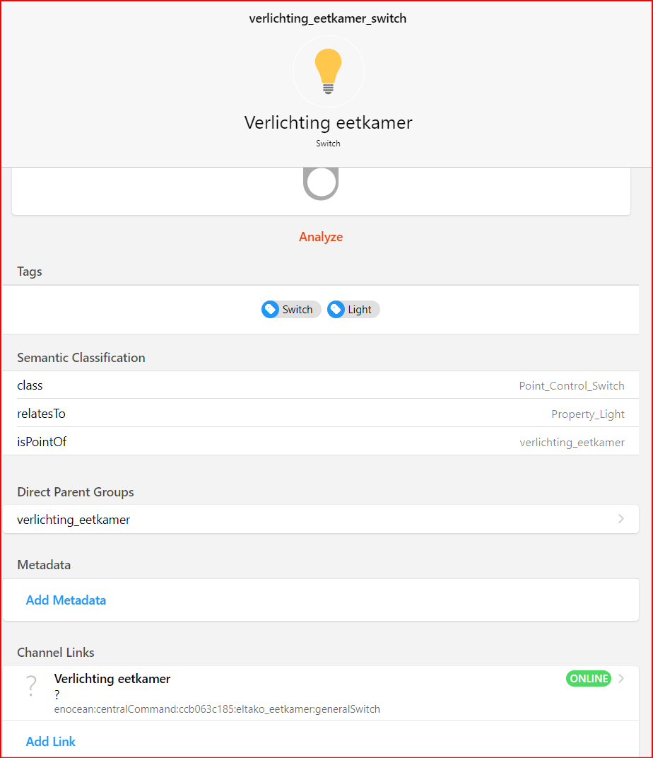

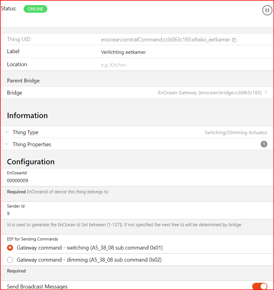

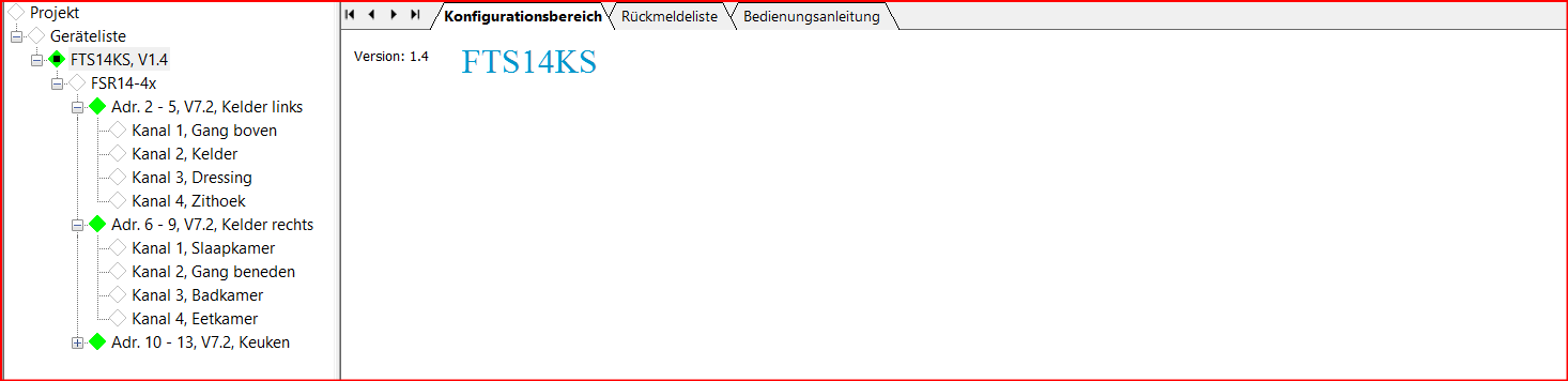

Finally the hardware was installed! We (the electrician and me) spent the entire afternoon configuring every physical switch with the PCT14 software. Everything works from a non-smart way, so the misses can’t complain. :wink:

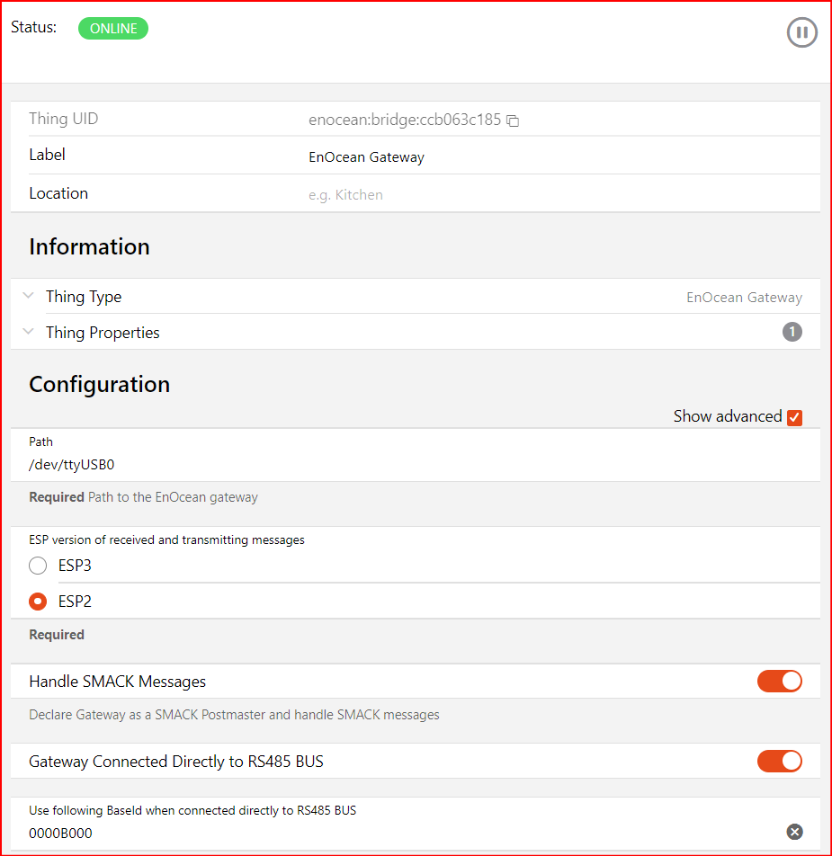

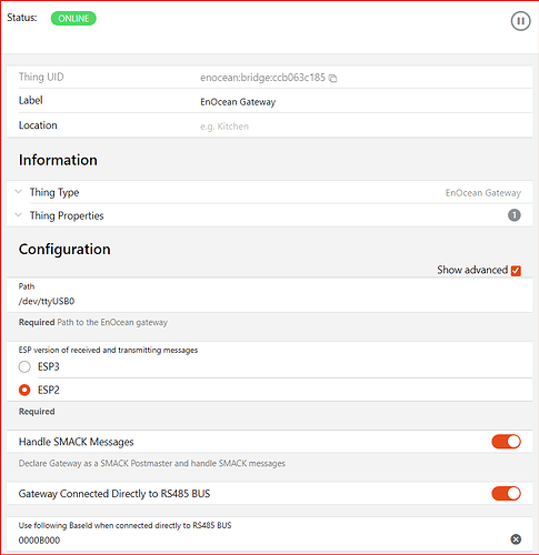

Now I’m fiddling with the openHAB connection. Since I used the PCT14 software to teach in the physical switches, I used it as well to teach in the OH switch (rather than play with the knobs of the FSR14-4x).
For now, no success… Maybe someone spots where I’m going wrong?
UID: enocean:bridge:ccb063c185
label: EnOcean Gateway
thingTypeUID: enocean:bridge
configuration:
  rs485BaseId: 0000B000
  path: /dev/ttyUSB0
  rs485: true
  enableSmack: true
  espVersion: ESP2
  sendTeachOuts: false
channels:
  - id: repeaterMode
    channelTypeUID: enocean:repeaterMode
    label: Repeater Mode
    description: Repeater mode of EnOcean gateway/device
    configuration: {}
  - id: setBaseId
    channelTypeUID: enocean:setBaseId
    label: Set Base Id
    description: Set base id of EnOcean gateway. Use this with care! Must be between
      0xFF800000 and 0xFFFFFF80
    configuration: {}

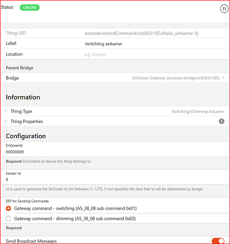

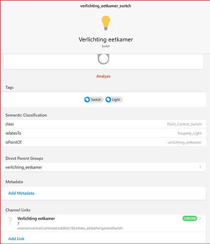

UID: enocean:centralCommand:ccb063c185:eltako_eetkamer
label: Verlichting eetkamer
thingTypeUID: enocean:centralCommand
configuration:
  enoceanId: "00000009"
  senderIdOffset: 9
  suppressRepeating: false
  sendingEEPId: A5_38_08_01
  receivingEEPId: F6_00_00
  broadcastMessages: true
bridgeUID: enocean:bridge:ccb063c185
channels:
  - id: contact
    channelTypeUID: enocean:contact
    label: ""
    configuration: {}
  - id: rollershutter
    channelTypeUID: enocean:rollershutter
    label: ""
    configuration: {}
  - id: lastReceived
    channelTypeUID: enocean:lastReceived
    label: ""
    configuration: {}
  - id: generalSwitch
    channelTypeUID: enocean:generalSwitch
    label: ""
    configuration: {}
  - id: repeatCount
    channelTypeUID: enocean:repeatCount
    label: ""
    configuration: {}
  - id: rssi
    channelTypeUID: enocean:rssi
    label: ""
    configuration: {}

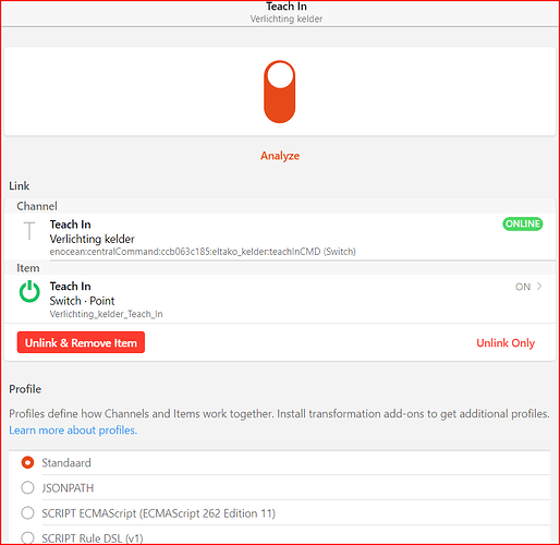

  - id: teachInCMD
    channelTypeUID: enocean:teachInCMD
    label: ""
    configuration: {}
type: Switch
category: lightbulb
groupNames:
  - verlichting_eetkamer
tags:
  - Switch
  - Light

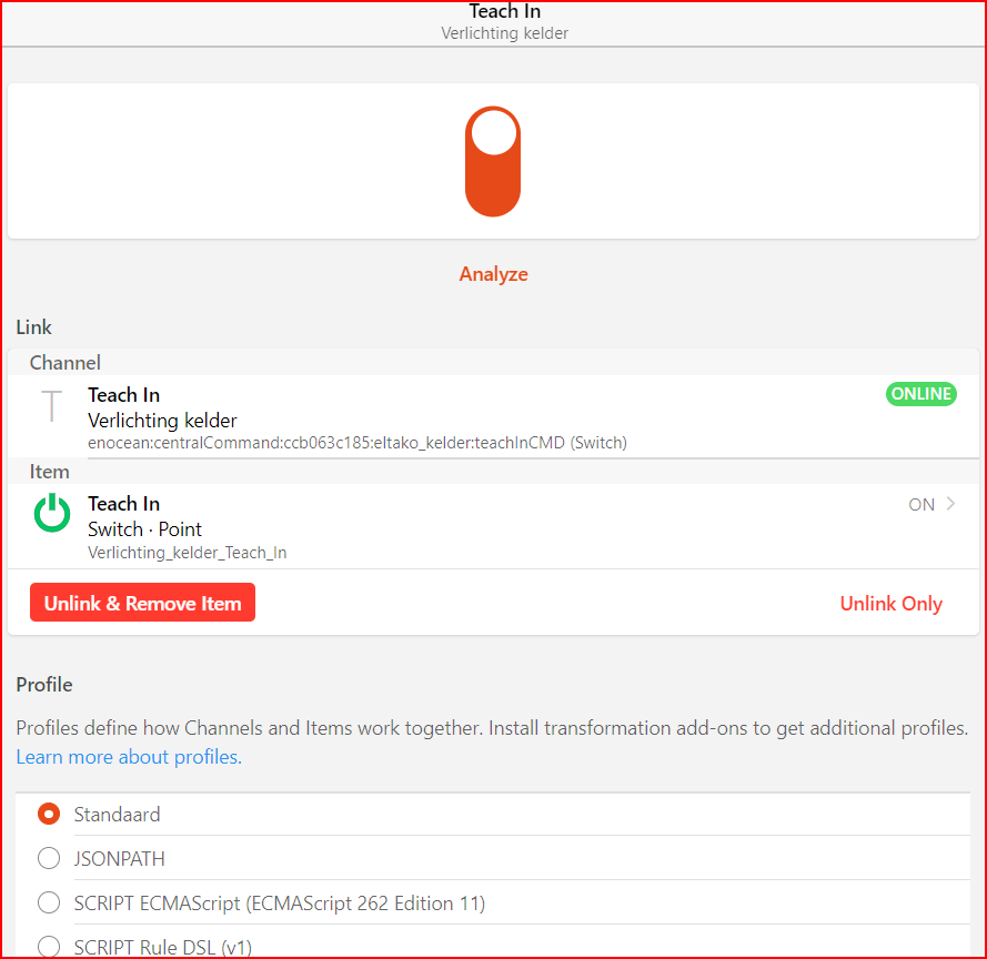

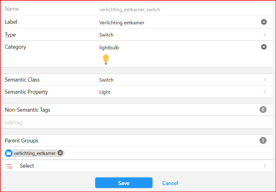

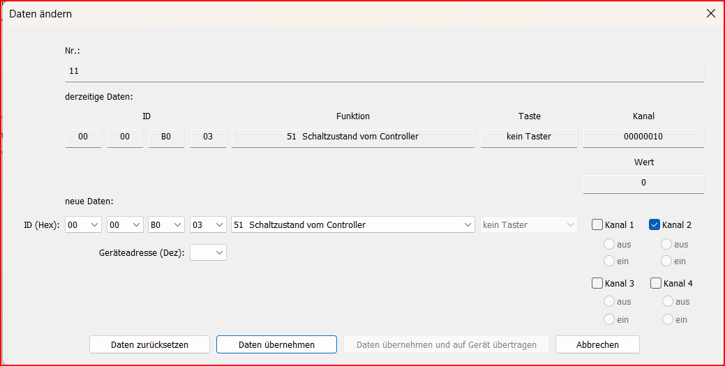

(I choose EnOceanId and Sender Id 9 because Eetkamer is on channel 9; that seemed easy. Was that a mistake?)
I thought this maybe was the problem, so I followed the instructions to do it through the knobs. I used a different light this time, as the circuit board is located in the basement, and that light is the easiest to check during the process :slight_smile:
I put the upper switch on 0, the middle switch on LRN and the bottom knob on 2 and created a Teach In item.
But the LEDs didn’t stop blinking when I switched the Teach In item from ON to OFF… Not surprisingly, 0000B003 didn’t show up after doing ‘Gerätespeicher auslesen’.
So maybe there’s something wrong with my bridge thing?

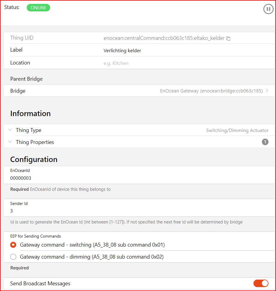

UID: enocean:centralCommand:ccb063c185:eltako_kelder
label: Verlichting kelder
configuration:
  enoceanId: "00000003"
  senderIdOffset: 3
channels:
  - id: contact
    label: ""
    configuration: {}
  - id: rollershutter
    label: ""
    configuration: {}
  - id: lastReceived
    label: ""
    configuration: {}
  - id: generalSwitch
    label: ""
    configuration: {}
  - id: repeatCount
    label: ""
    configuration: {}
  - id: rssi
    label: ""
    configuration: {}
  - id: teachInCMD
    label: ""
    configuration: {}
label: Teach In
type: Switch
category: Switch
groupNames: []
tags:
  - Point

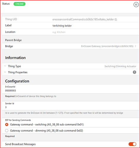

I had missed that the FGW14-USB should have had knob BA on 6.
Now that I did that, the channel in openHAB reflects what the actual light does, but I can’t switch with it. The switch immediately returns to the state of the actual light. For a video screen shot: https://youtu.be/YHdlIUHo8zk.
Good news is that the bridge works! Now I only have to find out why I can’t send commands… I tried switching almost all parameters on or off, but no success…
I tried all BA rockers, but only with 6 did the OH switch reflect the actual status of the light. (And none enabled me to switch from OH, obviously.)
(Btw, I haven’t taught in the kelder switch in yet via PCT14, but the OH switch already gets the status of the light in the basement (‘kelder’ in Dutch).)

06:54:32.123 [DEBUG] [ernal.handler.EnOceanBaseThingHandler] - ESP Packet payload F6500000000330 for 00000003 received
06:54:32.125 [INFO ] [openhab.event.ItemStateChangedEvent  ] - Item 'Verlichting_kelder_switch' changed from ON to OFF
But maybe another log is more useful… I now switched verlichting_eetkamer_switch in openHAB to ON (this is the switch I thaught in via PCT14 - 0000B009). The light didn’t go on; the switch immediately turned back to OFF. This is the log:
06:59:59.224 [INFO ] [openhab.event.ItemCommandEvent       ] - Item 'verlichting_eetkamer_switch' received command ON
06:59:59.230 [INFO ] [openhab.event.ItemStatePredictedEvent] - Item 'verlichting_eetkamer_switch' predicted to become ON
06:59:59.231 [INFO ] [openhab.event.ItemStateChangedEvent  ] - Item 'verlichting_eetkamer_switch' changed from OFF to ON

Sorry for the stalkage, but these users have had some insight in the binding, it seems to me: @mdillman, @fraggy, @fruggy83, @Beasty, @dirkdirk
There are 2 things that pop up for me. (Without any long investigation)
In PCT 14 it should be the function „ Funktion 51“ Schaltzustand von GFVS“ and you need to teach in from OFF to ON and not like you write from ON to OFF.
Try these two things, maybe it will already fix your problem. If not we need to look again.
Edit: looks like Eltako change the description of Funktion 51. So your setting may be correct.
Use these steps, should work.
Thanks for your answer, @dirkdirk!
I changed that later, based on someone else’s screenshot earlier in this discussion.
I did that; I messed up in my sentence above.
I did everything like in the instruction you cited (Enocean FSB14 teach in - #12 by eftokay83), but nothing happens if I switch the Teach In switch from OFF to ON. The blinking of the FSR14 module doesn’t stop. Also, if I check with the PCT14 software, address 0000B003 doesn’t show up after “Gerätespeicher auslesen”. And - of course - the openHAB switch doesn’t work.
I tried reassigning my phisical switches via PCT14, so that none of them control the “kelder” lights, and then repeat the process. But no luck…
So we need to look again :wink:
Then skip the the teach in process and add the data manually into PCT14 and save it to the device.
Have you tried this?
Yes, that was what I tried initially.
or (for “kelder” instead of “eetkamer”):
No effect…

I am using a FAM14. So no direct wired connection to the bus and my base ID is some unique one and not only 00000000.
This is the correct way of calculating the id.
You can try to change you gateway base id and then teach it in or write it into PCT14 again.
Maybe the actuators doesn’t like the Id.
Can you see your baseid within PCT14?
In the link you provided, I read “You just have to look up the base id of your enocean gateway”. Where should I look that up?
What exactly do you mean by this? Where should I see it?
Like I said, I am not using your hardware.
For me I can see the base id under the FAM14 device in PCT14.
Unfortunately:
Ok, then sorry.
Can’t help you at the moment.
If your ID‘s are all correct but the FSR14 can’t be switched via openHAB, there must be a problem with the connection to the bus.
Maybe this is why the teach in doesn’t work, too.
My FAM14 connection is totally different, so can’t check or compare anything with my setup. Sorry
And do you use this ID FFDDC480 as BaseID in the bridge thing?
I use my base ID from my wireless adapter in the bridge thing. The picture was just an example.
This is my config:
In PCT14 the openHAB enocean bridge base id + Sender id is used as calculated ID (as hex) for the actuators.
So the bus knows which sending telegrams must control which light.
In openHAB the FAM14 base id + Adress no is used as calculated ID (as hex) for the things.
So openHAB knows which receiving telegrams must reflect the state to which thing.
