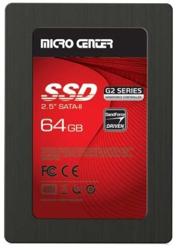

Not to beat this to death … what is recommended SSD size for openHAB … I have a 64 GB Micro-Center and a 500 GB Samsung EVO. The EVO has better life (multi read/write) yet the Micro-Center is ‘free’ i.e., collecting dust for now.
Whatever SSD is far better than any SD card, in my opinion. Make your decision from their price and what you feel suits you best.
64 Gig is way more than enough space.
Any will do. But this is no official recommendation. That would rather be to go ZRAM.

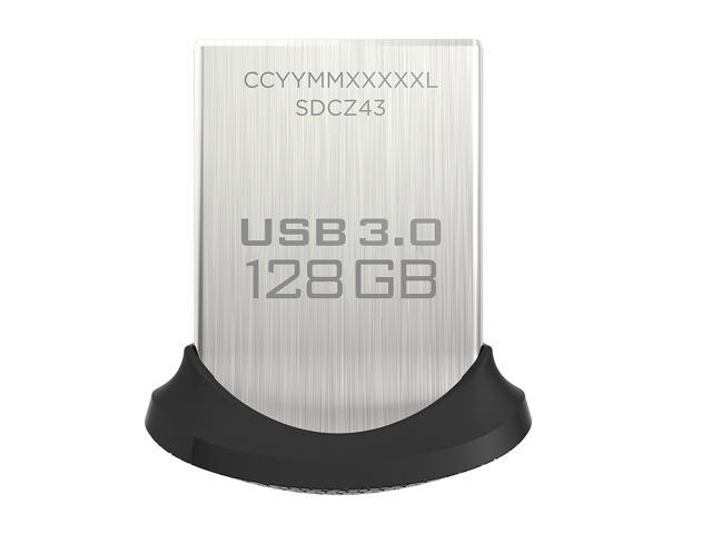

Putting things in perspective (where size matters)… either a full size SSD (64 GB) or a MINI thumb drive (USB 3.0, 128 GB Sandisk)
A thumb drive is going to have the same problems that an SD card has in terms of wear out. You may as well just continue to use SD cards.
An SSD is usually way over provisioned and has other technology built in that makes it last about as long as an HDD does.
If you are looking for something that isn’t going to wear out for the life of the RPi, the only choice is the SDD.

Thank you both @rlkoshak and @mstormi for clarifying the issues with microSD and USB drives … I was merely showing the two options (SSD vs. Thumb Drive) to highlight the differences.
The SSD is reliable, but clunky. The low-profile USB is very ‘elegant’ but not durable … Such are many choices in life, or, as they say here, you can’t have your cake and eat it too. :slight_smile: :frowning:
