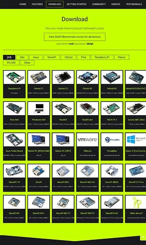

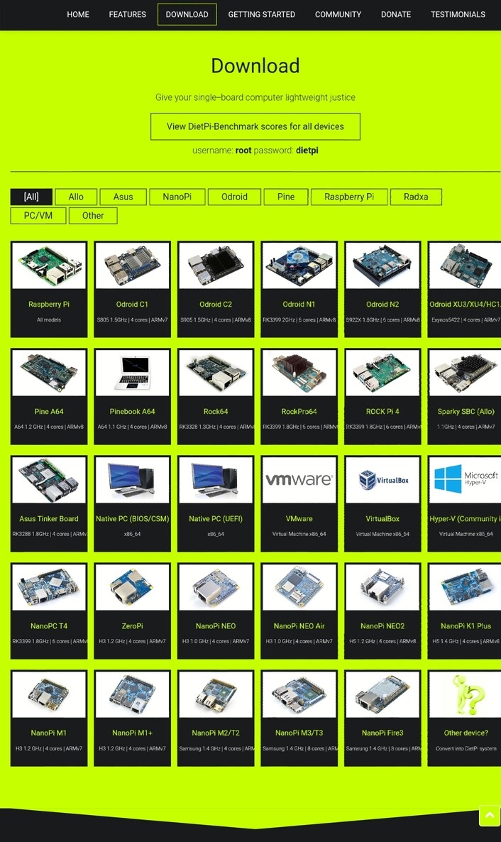

DietPi is NOT hardware, it is Debian Linux, especially constructed to be extremely lightweight, so ideal for use with software like openHAB2, that doesn’t need the extras preloaded.
I guess the name comes from it originally being created to run on Raspberry Pi hardware.
However, there’s an image for other devices, like the ODroid C2, Quad core SBC.
As well as many other SBC devices

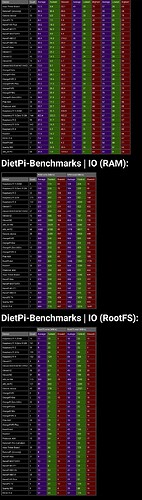

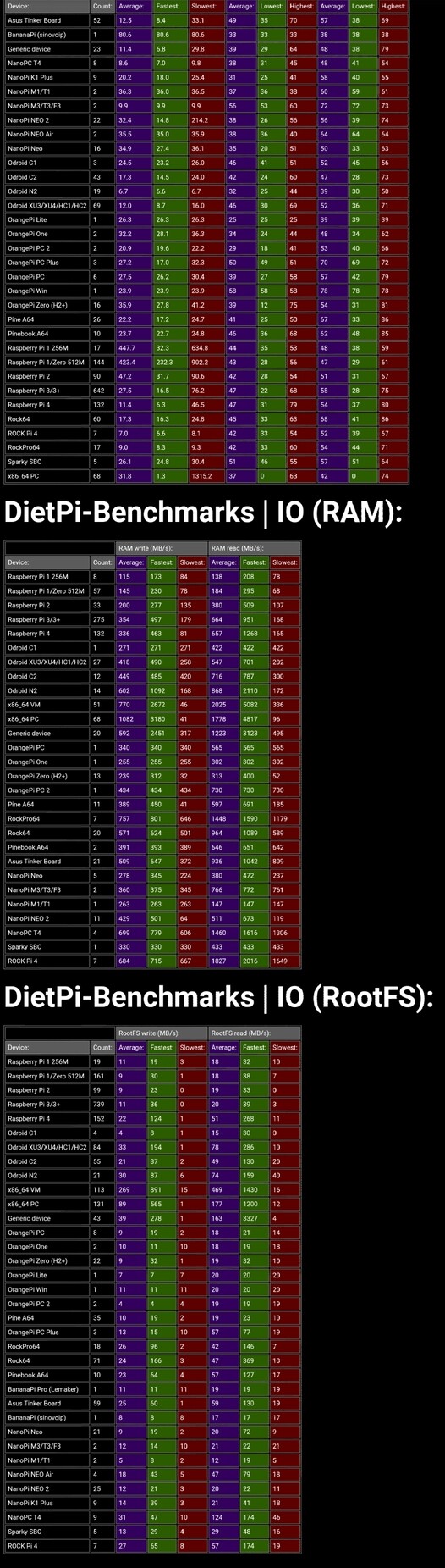

Just click on the Download tab on https://dietpi.com/
The setup process for DietPi is one of the simplistic I have ever seen / used.
Now here’s something you don’t see in many OS websites
