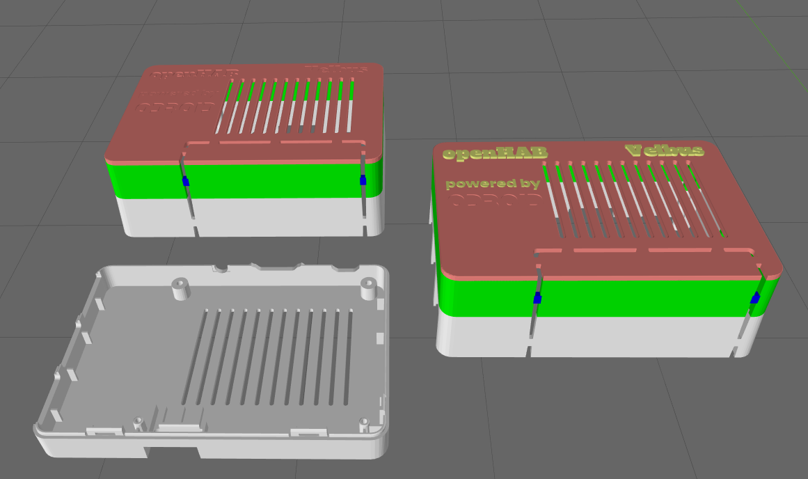

Hi
You asked that I post some more information, so here goes.
I’ve bitten the bullet and ordered a C2 UPS.
The only minor detail is that I’m told it won’t fit in the standard C1 / C2 case, so I was advised to download the STEP files for the case and modify it to suit.
This is what I have come up with…
It’s on the printer right now, so let’s hope it works.
I’ll post an update on the UPS when it arrives and I’ve had a chance to put it to work.
The STL file for this case is here, if anyone wants it.
http://www.mdar.co.uk/dl/MDAR_ODROID-C2+UPS_CASE.zip
