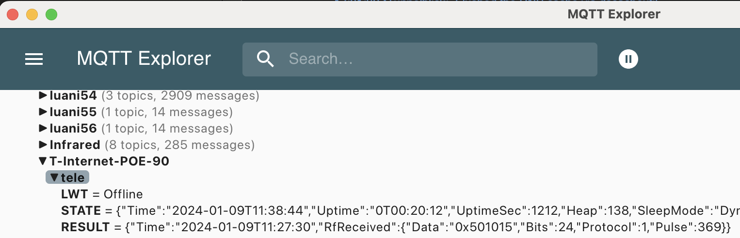

From what I can see, the protocol being used is not Zigbee or anything similar (like with outher lamps from NLG), but a proprietary one. It also doesn’t seem to be some “dumb” protocol like IR, where the ceiling light just listens to whatever floats around (at least that’s how I interpret the part in the manual that mentions a sort of “pairing” process):
Understand / reverse-engineer the signals / protocol (in my case only two for “brightness up” and “brightness down”, since that’s the only thing that’s needed)
Pair the ceiling lamp to openHAB (once)
Send the respective signals via openHAB (for “brightness up” and “brightness down”) when needed
With #5 I’m very familiar, but looking at a custom 433 MHz protocol I’m somewhat clueless on how to even approach the steps 1 - 4.
In this thread I read something about MiniCUL and FHEM, but I’m hesitant going down the FHEM-route but like to keep it simple.
And yes, I know that the fallback would be to open the remote and solder the Tx-signal pins of an ESP to the buttons of the remote.

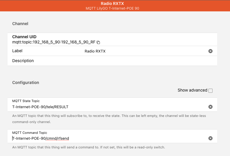

You have all the skills to be able to do this with TASMOTA
Its the cheaper option.
This is another option to just buy a device that works and install program on PI to control that has a webpage to easily configure.
Either way you will need to.
Pair the remote.
learn all the button presses and map each button to individual items.
I someone is going to use the remote Each item is a momentary item so you will need to expire it.
Use these items to update real items to keep the state the same in openHAB and on device.
You only need to create one thing to control and all 433 items just use rules to send different commands to it.
