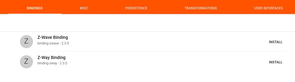

but all I am seeing is the option to install the 2.3.0 version.
Sorry for asking the silly questions, but please enlighten me on how to name the jar file and where to place it in an openhabian installation. According to the README file, I really think it is placed in the correct location. But something is still not working correctly.
It looks like you are running OH 2.3. You can upgrade to the OH M5 milestone build through the openHABian config menu. I am not familiar with openHABian, but I know this has been discussed in the forum, and may also be in the documentation. Once your OH is upgraded, the latest zwave binding will be available to install through Paper UI.
It is possible to install bindings by putting the jar into /addons/, but when you do, you will not see it listed in Paper UI. I have built a script to help in manually installing the binding, but you’ll also find steps for performing the manual install yourself, including the location to download the latest snapshot build of the binding.
Once installed, you will need to add the controller Thing, which will then add into the Inbox all of the nodes that it is aware. Hope this helps!
If you placed the jar in the addons folder it should have become active already, but as @5iver correctly states that won’t be shown in PaperUI. Use ‘bundle:list|grep -i zwave’ in Karaf console to see if it’s running.
But I’d suggest moving to the M5 milestone as well, then you should be able to use PaperUI to deploy it.
