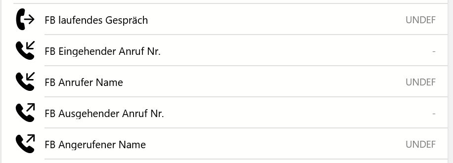

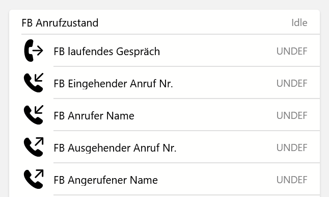

i am faceing the same issue. When no call is incomming or outgoing or ongoing the item always show “UNDEF” which in my point of view should not be the case. To show the name of the caller i also use the “PHONEBOOK” profile at the respective channel to get the name from the phonebook.
Here how it looks before and after the call:
and here during an incomming call:

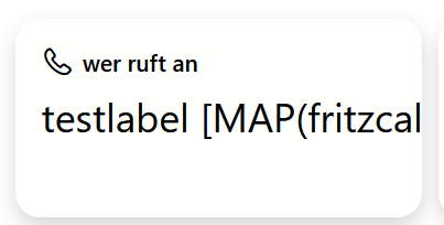

but in the widget:
i tried several different ways for MAP / =MAP etc. , none of them was working.
component: oh-label-cell
  item: FB9xyz_EingehenderAnruf
  icon: f7:phone
  title: wer ruft an
  label: testlabel [MAP(fritzcall.map):%s]

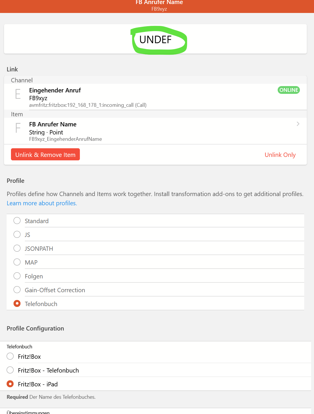

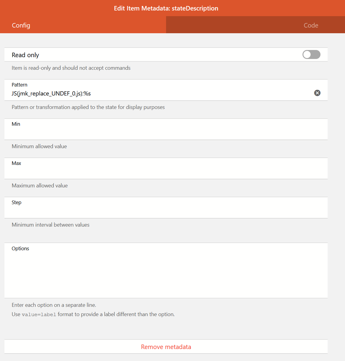

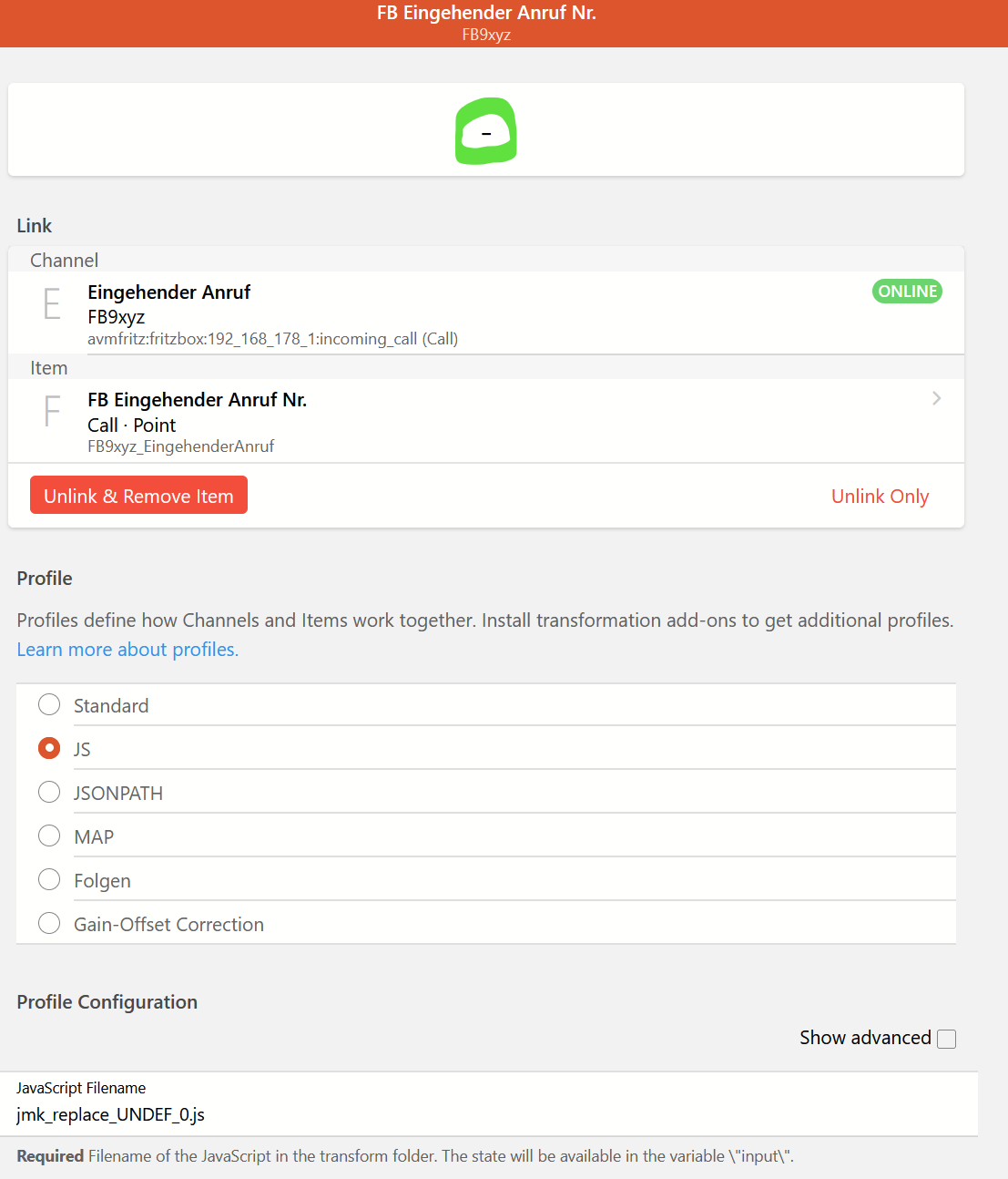

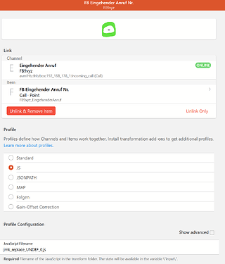

It works fine if i apply this as profile in a channel
For the same thing but another channel i use the phonebook (Telefonbuch) profile and i see as expected UNDEF as long as no call is done.

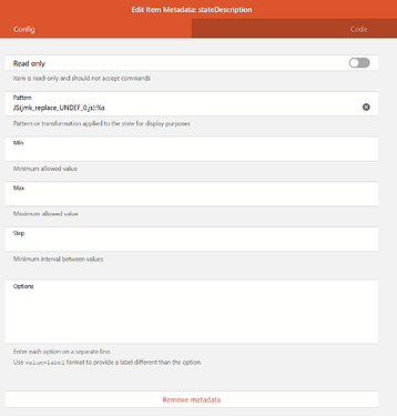

Therefore i use the JS in the Pattern of the stateDescription based on the assumtion that i can use only one transformation at a channel.
Unfortunately nothing changes for those cases, i still see the UNDEF!

  • transformation applied on a channel really change the state
  • transformation applied on items metadata keep the state but change how the state is display.

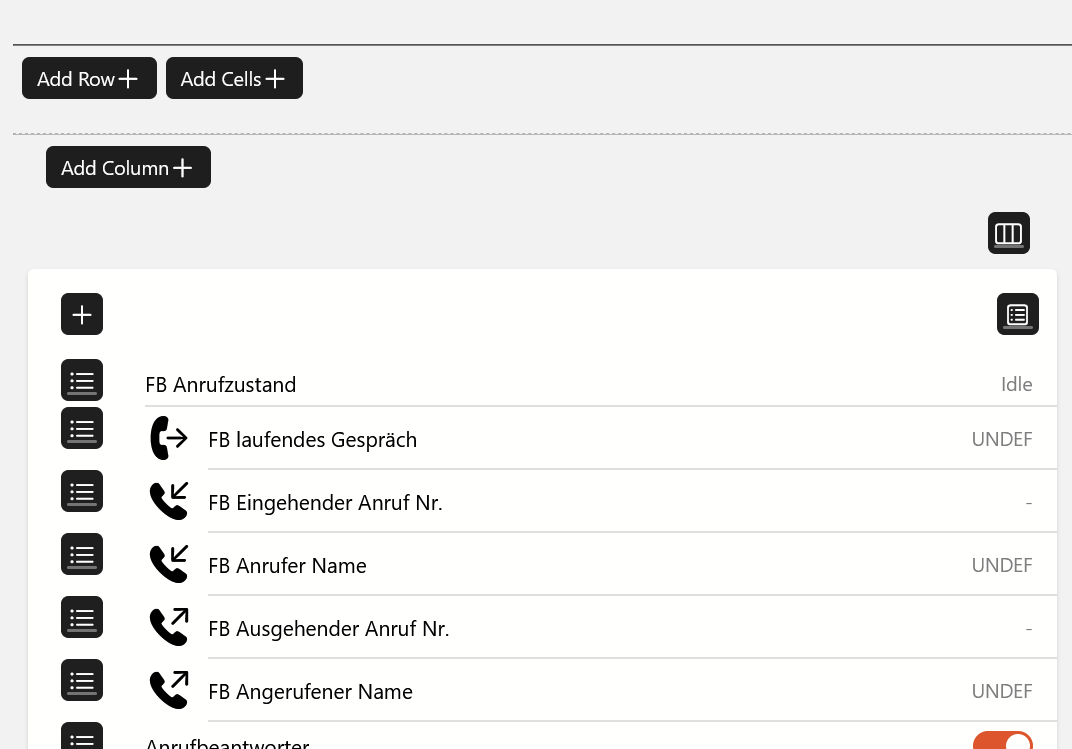

I don’t know what you’re showing us in that screenshot. Some widget? Is it displaying Item state, or displayState? You have a choice in widgets - real Item state or formatted/transformed version.
here i have a bit different view as i found today also in the OH Community:
I would use UNDEF rather than NULL because they have slightly different meanings in openHAB
NULL = hasn’t been set up yet
UNDEF = something wrong or unexpected
which is locigal for me. Therefore if there is no call it should be 0 or OFF as it should be a defined state and not UNDEF = something wrong or unexpected
I have choosen this approach to get all items into a defined state after a reboot of the system or restart of openhab. It should be the state as it was before the reboot / restart took place which usually take only a view minutes. But this is a minor topic for me as a reboot / restart should be an exceptional case.
Sorry was not clear for others.
Yes its part of a widget of a page.
and this is the code extract, nothing done here to change the format of the item state.
I usually try to get the display part for an item state right on the item itself e.g using pattern because then you always get the same view to an item independed where it’s displayed.

One question is still open:
Why the JS in the Metadata - stateDescription - Pattern of the item is not apllied in case a profile is already used at the channel (in this case the phonebook profile)?
At least as i understood how OH works is that with the profile you can change the item state value and afterwords you still can change the display part with e.g. stateDescription - pattern

If you really must do this, you have already found the means to do it using a transformation. Remember your replacement value has to be a valid state for the particular Item type (NULL and UNDEF are valid for all Item types)

You might have a Number Item with state 3.1417, and ‘pattern’ “%.1f bananas”
In your widget, you can choose to show “3.1417” or to show “3.1 bananas”
See above.
That will change the state of the Item.
