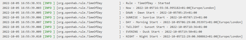

So, the Blockly rule is below and the log file below that.
In short, the rule sets 6 variables, 4 from the astro binding and 2 I’ve set fixed times. The issue is with these fixed times. At this time of year it runs the else statement ‘Sunrise is after 6:30’.
Dawn / Day / Twilight / Evening all run through and the ToD gets reported correctly but when it gets to NightStart, ie my fixed time of 22:29, it stays as Evening, and stays that way through until DawnStart happens and then it change to Dawn. So I never get a NIGHT.
The log files below suggest that the variables all have date / time entries. I’m a bit stumped…

DawnStart is coming from an Astro linked Item (it appears). That Item is populated sometime around midnight for that day. When this logic runs, Notice that DawnStart is 05:25 today and NightStart is 22:29 today. When the time reaches, for example 22:30, the else if evaluates to false because 22:30 is not between 05:25 and 22:29. So NIGHT can never happen.
You have to account for the fact that you actually won’t know when DawnStart is for tomorrow until after midnight. But then at that point NightStart will have moved to the next day too. You could adjust this by adding more else if statements for NIGHT where you test if now is between NightStart and midnight tomorrow and another to test if now is before DawnStart.

And of course you are correct, I just need to set the NIGHT to be >= NightStart and it will be perfect…
