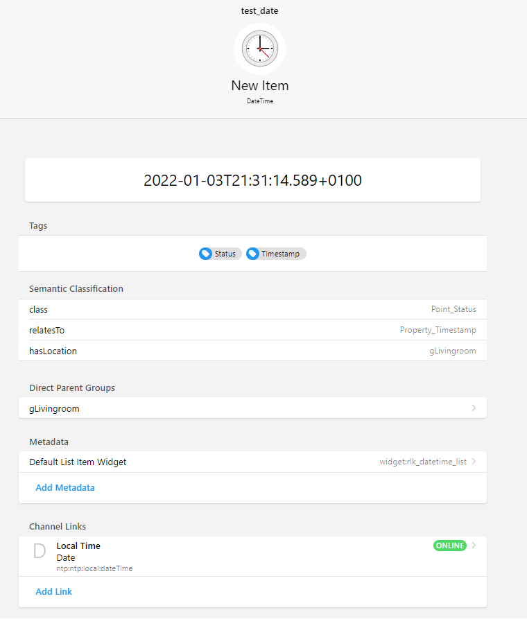

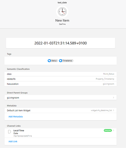

What always stays empty? How are you trying to use it? Have you set it as the Default List Item Widget for a DateTime Item? Does your Item have a state that isn’t NULL or UNDEF? Where are you looking at the widget?
My testitem looks like:
The widget isnt shown in the default card for the room.
Did you look on the Properties tab of the room’s card? Since this isn’t a member of an Equipment, it’s a property directly on the Room and is shown on a separate tab. This is discussed in the Getting Started Tutorial: Pages - Overview Page | openHAB
Note that what you see on the Item’s page is the Stand Alone Widget, not the List Widget.
Nothing is shown in the property tab :/.

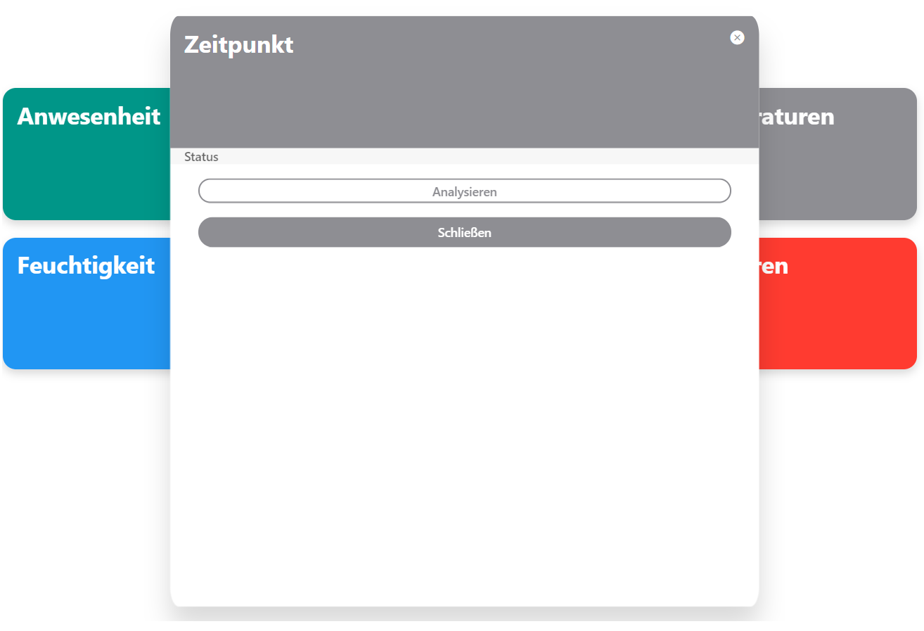

Furthermore if i open the timestamp card, which is created with this item, it only shows:
Do i need to install something?
Then there is something wrong with the model or with your Item. Perhaps you need to refresh the page. It’s not something that is related to this widget so opening a new thread is probably best.

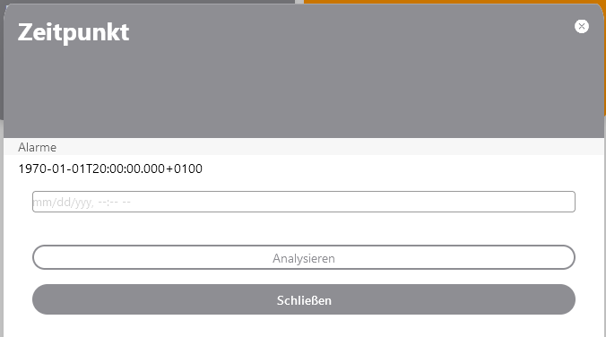

After reinstalling the widget it now renders :). But for now the calendar button / calendar itself is missing. And i cant input anything
I’ll take a deeper look into it at the afternoon.
Hi Rich,
I can cofirm this problem, the item only shows an input box with the content mm/dd/yyy …, no calendar and no check icon is displayed.

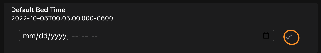

How can I use the list wiedget without the send button to get the value changed?
I think just hitting enter/return should do it. I don’t know for sure though as I’ve never not had the send button.

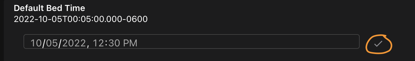

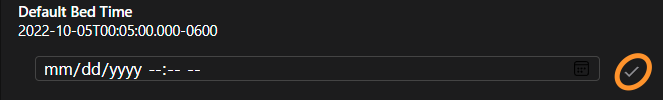

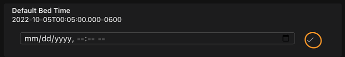

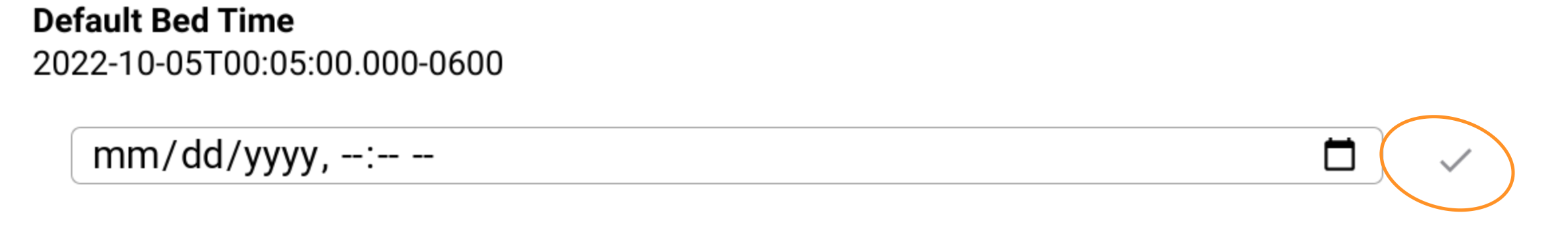

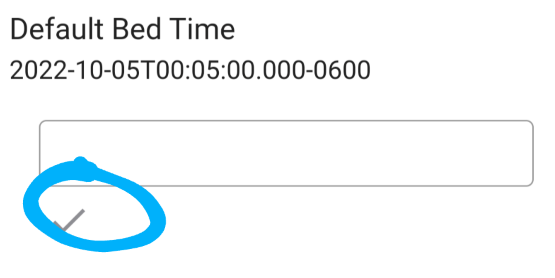

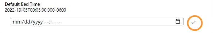

What platforms are you using? I can tell about app via android as well as Chrome on Windows 11. But do not show the send button on my systems.
On a Mac in Brave:
Safari on Mac:
Windows 11 in Brave:
Edge on Windows 11:
Chromebook in Google Chrome
Android in Android App:
Android in Brave:

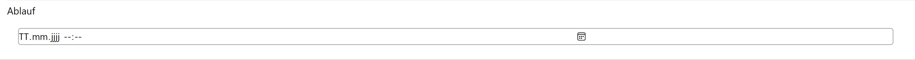

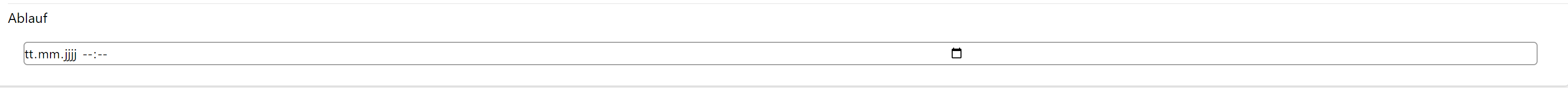

just to be sure - we are talking about the list widget, not the standalone?
Windows 11, Chrome 105
Windows 11 Edge 105
=> maybe config on my side (and others?)?
Yes, the list widget. The same goes for the stand alone widget too though.
Maybe but I can’t imagine what it would be.
