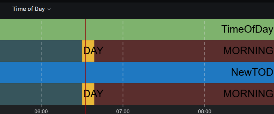

@rlkoshak Thanks for sharing your great work - the state machine works just great (as the previous rule based version did). However also the new solution does not support one of my scenarios when Day-Morning or Evening-Night times overlap over the course of the year. Example: Morning time is fixed to 6:45 - Sunrise is set by astro binding, today it was around 6:30. This results in having all day tod=morning.
My expected result (wish!) would be to skip “Morning” if the day starts earlier, or with other words the squence of ToDs should always be the same.
Having read the documentation multiple times I don’t think this is supported or easy to be implemented.
Assuming that I am maybe not the only one with this issue, is there an suggested solution?
Thanks so much in advance
Christian
This. It’s not easy to support. All the rule sees and knows is that you have a bunch of Items and each Item has a DateTime. It puts those in order and schedules the timers. It has no concept that MORNING should normally happen before DAY.
However, all is not lost. You have some options depending on where the DateTime in Morning and Day comes from.
  1. Set a no earlier than in the Sunrise channel to something later than the static start for MORNING. So if you set that, no matter what the sun is doing, sunrise will never be earlier than 6:46 AM (for example).
  2. My MORNING is actually driven by the alarm clock on my phone. When it’s set it triggers a rule (using the Alarm Clock rule template for now, but you should use the new Time is <item> trigger). The rule checks to see if it’s NIGHT or BED and only if so does it run and set the TimeOfDay Item to MORNING. On weekends and days where I don’t need to get up, no alarm is set and those days do not have MORNING state.
  3. You can modify the rule and make it smarter. Add some if statements that look to see if DAY actually occurs before MORNING and adjust the times as appropriate. But that’s something that will be unique to you and can’t be something I can make generic. You could even put this into a separate rule that checks the DateTimes sometime after the rule runs at midnight and adjusts the times as necessary. Changing the DateTimes will cause the rule to run again and reschedule the Timers.
Tl;dr, it’s up to you to make sure the DateTimes are in the order you require, but there are options to make sure that’s the case that are not too onerous.

Where would you look to debug this infrequent problem? I would not expect that createTimersGenerator() would events.sendCommand(), but it does. I’ll enable debug on that module, but if you have any guesses on where to look I’ll happily poke at it. :slight_smile: Upon entry, mostRecentState would have been NIGHT according to my event log, which means that it hit if(dt.isBefore(now) && dt.isAfter(mostRecentTime)) {}.
Debug context: openhab 3.3.0 in a docker container on ARM, javascript is marketplace:128245 (I’m unsure if this auto-updates, but I set this up on 10/20 and haven’t touched it since).
That’s what this thread is for.
I probably won’t be able to help much without more information. Either modify your log4j2.xml file or the karaf console to add a logger for org.openhab.automation.script.Rules.rules_tools set to DEBUG level logging or modify the rule itself and change all the log debug statements to log infos. Then post the debug logs from the rule when this behavior occurs.
For some reason, the part of the code that schedules the timers for the next day scheduled the DAY timer to one minute after midnight. Without knowing what the state of that DateTime Item was at the time the rule ran I couldn’t guess as to what went wrong.
It might help a bit to see the events.log showing which of your DateTime Items changed and when they changed in relation to when the state changed to DAY. It might be a timing issue where the rule ran in response to an event from Astro (for example) before To Today was able to update the DAY Item, meaning it was still scheduled for yesterday and ran immediately. I’ve never seen that before but it makes sense logically.
If that is the case I can add some logic to prevent that. But I need more details to know if that’s the case.
It doesn’t. But I’ve not modified the template since February of this year so you should have the latest.
To upgrade you need to remove the template, add it again, and then delete and recreate the rule(s) instantiated from the template.
Thanks, Rich. I always appreciate the support I see you give. I enabled debug on org.openhab.automation.script.Rules.rules_tools.Time_SM, so hopefully I’ll catch a hint later.
At 00:00, I see my hard-coded times rolled forward to the next day via marketplace:127921.
I also see my *_Morning and *_Evening times updated (Astro; the others are manually set).
I give the earliest event of the day (00:05) a several-minute buffer after time rolls forward to hopefully avoid any race condition.
I left one non-TOD entry in my event log here for fun: I came home right around midnight and triggered my motion sensor, the clear event happening at the very same second that the DAY command was issued, but it was SURELY a complete coincidence. :slight_smile: (There are no rules tied to it currently - just a note in the event log.) I don’t see any more hints here.

Ok, that’s weird.
First, please use code fences for logs.
code/logs/configs go here
Here is what I see.
  • 9 msec after midnight the To Today rule starts updating the time of Day Items. This will trigger the Time Of Day rule
  • It takes about half a second for that first trigger to get to the point where it’s calculated what type of day it is. During all this time the many triggers caused by the To Today rule are queueing up. A 30 second timer is created to wait for all these updates to finish happening before calculating the time of day.
  • The Time of Day rule is triggered 6 more times from the To Today but because the timer exists, it’s just rescheduled. The Items updates are:

  • About one minute after midnight the timer finally expires and calculates the time of day as DAY.
Notice anything missing? Default_Day was never updated. So it still had the previous date which was in the past and therefore it was the earliest date time found by the rule.
So the problem isn’t the Time of Day rule, it’s the To Today rule (I assume). Why wasn’t Default_Day updated? Does it still have the “tod” tag (given its state I’m assuming it’s not driven by Astro) or is it driven by something else that To Today?
Looking at the states you posted above, indeed, both Default_Bed and Default_Day have yesterday’s date. So what ever is supposed to update those two Items (perhaps others) is not working.
Put the To Today rule into DEBUG logging too (assuming these rules are usually driven by To Today). That’s where the problem lies.
I might be able to put a check for date times that are the previous day. But I don’t know what’s appropriate to do in that case, ignore it? I’m not sure that’s right.
re code fences: thanks - that’s what I was looking for! That’s what I get for posting after midnight! Fixed.
Wow, good eye! I didn’t notice the absence of Default_Day. I just confirmed that Default_Day has the same (sole) tag as Default_Night (which, as you saw, did get moved). I’ll definitely look at the rollover script more closely now. Funny that this has worked so well every other day:
