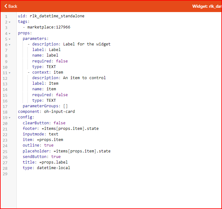

uid: rlk_datetime_standalone
tags: []
props:
  parameters:
    - description: Label for the widget
      label: Label
      required: false
      type: TEXT
    - context: item
      description: An item to control
      label: Item
      required: false
      type: TEXT
  parameterGroups: []
component: oh-input-card
  outline: true
  clearButton: false
  inputmode: text
  footer: =items[props.item].state
  item: =props.item
  placeholder: =items[props.item].state
  title: =props.label
  type: datetime-local
  sendButton: true

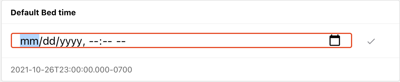

I am interested in working with dates in a custom widget but what happens to me is that when I press outside, the date is deleted and I would like it to remain present. I have seen the example of him, I have replicated it and it also happens.
Would you know any possible solution to this?

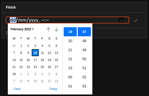

For info, as I get inconsistent results depending on browser. I get that there’s not much control available for this…!
Dark theme used throughout.
Ubuntu, Firefox

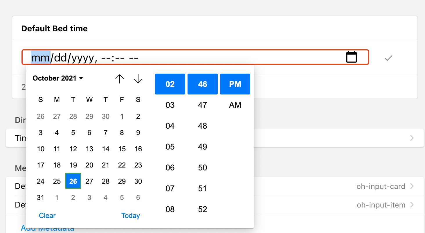

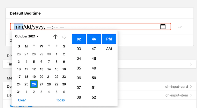

Clicking on either dd, mm, or yyyy gives the below - no time picker. Clicking anywhere else provides nothing. After selecting a date, user has to manually enter a time before the check icon can be clicked, otherwise nothing happens.
Ubuntu, Chromium
The picker only comes up when clicking the almost invisible calendar icon, but at least you can choose the time! Picker doesn’t respect the theme settings.

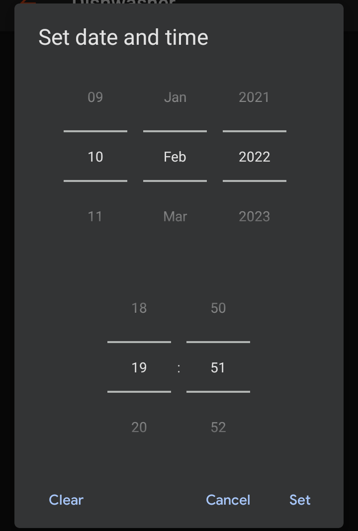

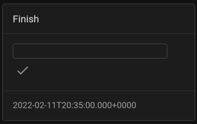

Android, Chrome & Brave
Note the empty input field.
Screenshot_20220210-195018
Tapping the input field provides this pop-up.

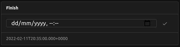

Screenshot_20220210-195155
Tapping the check icon to accept the date time then clears the input field again, so it’s empty.

There where some issues with setting time in the input card. This should be resolved with PR#1525. It will be available with the next milestone.
The datetime-local behaviour is not consistent across browsers. With the next milestone, you should be able to use datepicker as type and set a showTime flag to true. However, when using datetime-local, it should now correctly show time as well.

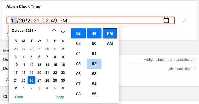

Thanks a lot for it! Now I can dynamically set my alarm clock time in a convenient way!
