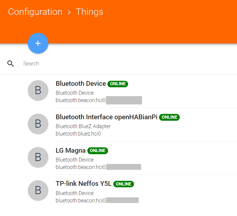

Once the smartphones were detected, the things page stayed like this:
Any hints?
Thanks.

@xgon These devices are treated as beacons, so you should see their RSSI channel being updated and indicating you the range.
The ONLINE/OFFLINE information of the Thing is instead rather meant as a mechanism to hint at problems - if a Thing goes OFFLINE, it means that it doesn’t work as expected anymore, because there is some problem. For beacons, this is not the case as it is a completely normal and expected situation that they are out of range. You should thus use the RSSI channel for your logic.

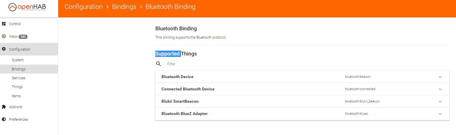

Here:
“Enable background discovery”
Strange I don’t have the same interface :frowning:
I discover OH sorry my noob question
I try now with things
Bridge bluetooth:bluez:bd909c61 [ address=“B8:27:EB:2E:”, discovery=false ]
This means that you are running an old version of the binding. Uninstall and install again.
