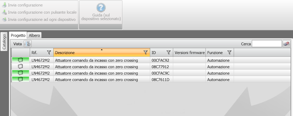

    I’ve installed on my pc MyHOME_Suiteand check the actuators they seems to be ok also there.

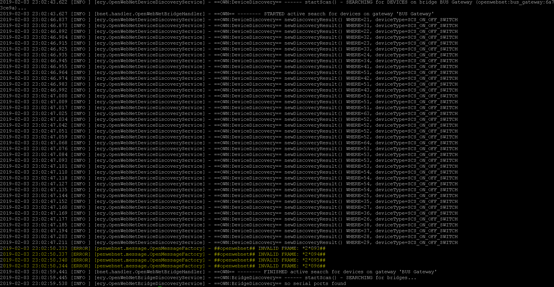

Attach the log as text not as a photo
i don´t know why but it seems in your log there is
*2*093##
but shoudn´t it be like that:
*2*0*93##
Instead of using physical configurators, why not use MyHomeSuite is configuring with virtual configurators?
ok thanks for the tip, i’ll post again
Because I was trying to apply this solution on my environment already configured since 5 years. This evening i’ll try to collect the log from rasp and send here.
I don’t know why the are formatted in that way, that’s what is written in log file. what do you suggest?

2019-02-03 17:00:38.603 [WARN ] [org.openwebnet.OpenGatewayBus       ] - ##gw-openwebnet-BUS## ...re-connect FAILED. Exception: connect timed out
2019-02-03 17:00:48.655 [INFO ] [bnet.handler.OpenWebNetBridgeHandler] - ==OWN== ------------------- RE-CONNECTED to gateway!
2019-02-03 17:00:55.078 [WARN ] [penwebnet.message.OpenMessageFactory] - ##openwebnet## unsupported WHAT 12 from frame *1004*12*0##
2019-02-03 17:01:14.755 [WARN ] [penwebnet.message.OpenMessageFactory] - ##openwebnet## unsupported WHAT 12 from frame *1004*12*0##
2019-02-03 17:02:41.049 [WARN ] [bnet.handler.OpenWebNetBridgeHandler] - ==OWN==  CONNECTION ERROR: Connection error (IOException). Check network and gateway thing Configuration Parameters
2019-02-03 17:02:48.552 [WARN ] [org.openwebnet.OpenGatewayBus       ] - ##gw-openwebnet-BUS## ...re-connect FAILED. Exception: connect timed out
2019-02-03 17:02:58.562 [WARN ] [org.openwebnet.OpenGatewayBus       ] - ##gw-openwebnet-BUS## ...re-connect FAILED. Exception: connect timed out
2019-02-03 17:03:08.594 [INFO ] [bnet.handler.OpenWebNetBridgeHandler] - ==OWN== ------------------- RE-CONNECTED to gateway!
2019-02-03 17:03:14.895 [WARN ] [penwebnet.message.OpenMessageFactory] - ##openwebnet## unsupported WHAT 12 from frame *1004*12*0##
2019-02-03 17:03:34.510 [WARN ] [penwebnet.message.OpenMessageFactory] - ##openwebnet## unsupported WHAT 12 from frame *1004*12*0##
2019-02-03 17:05:00.922 [WARN ] [bnet.handler.OpenWebNetBridgeHandler] - ==OWN==  CONNECTION ERROR: Connection error (IOException). Check network and gateway thing Configuration Parameters
2019-02-03 17:05:08.424 [WARN ] [org.openwebnet.OpenGatewayBus       ] - ##gw-openwebnet-BUS## ...re-connect FAILED. Exception: connect timed out
2019-02-03 17:05:18.433 [WARN ] [org.openwebnet.OpenGatewayBus       ] - ##gw-openwebnet-BUS## ...re-connect FAILED. Exception: connect timed out
2019-02-03 17:05:28.457 [INFO ] [bnet.handler.OpenWebNetBridgeHandler] - ==OWN== ------------------- RE-CONNECTED to gateway!
2019-02-03 17:05:34.895 [WARN ] [penwebnet.message.OpenMessageFactory] - ##openwebnet## unsupported WHAT 12 from frame *1004*12*0##
2019-02-03 17:05:54.638 [WARN ] [penwebnet.message.OpenMessageFactory] - ##openwebnet## unsupported WHAT 12 from frame *1004*12*0##
2019-02-03 17:07:20.836 [WARN ] [bnet.handler.OpenWebNetBridgeHandler] - ==OWN==  CONNECTION ERROR: Connection error (IOException). Check network and gateway thing Configuration Parameters
2019-02-03 17:07:28.335 [WARN ] [org.openwebnet.OpenGatewayBus       ] - ##gw-openwebnet-BUS## ...re-connect FAILED. Exception: connect timed out
2019-02-03 17:07:36.442 [WARN ] [org.openwebnet.OpenGatewayBus       ] - ##gw-openwebnet-BUS## ...re-connect FAILED. Exception: No route to host (Host unreachable)
2019-02-03 17:07:46.471 [INFO ] [bnet.handler.OpenWebNetBridgeHandler] - ==OWN== ------------------- RE-CONNECTED to gateway!
2019-02-03 17:07:54.716 [WARN ] [penwebnet.message.OpenMessageFactory] - ##openwebnet## unsupported WHAT 12 from frame *1004*12*0##
2019-02-03 17:08:14.495 [WARN ] [penwebnet.message.OpenMessageFactory] - ##openwebnet## unsupported WHAT 12 from frame *1004*12*0##
2019-02-03 17:09:40.894 [WARN ] [bnet.handler.OpenWebNetBridgeHandler] - ==OWN==  CONNECTION ERROR: Connection error (IOException). Check network and gateway thing Configuration Parameters
2019-02-03 17:09:48.396 [WARN ] [org.openwebnet.OpenGatewayBus       ] - ##gw-openwebnet-BUS## ...re-connect FAILED. Exception: connect timed out
2019-02-03 17:09:58.407 [WARN ] [org.openwebnet.OpenGatewayBus       ] - ##gw-openwebnet-BUS## ...re-connect FAILED. Exception: connect timed out
2019-02-03 17:10:08.437 [INFO ] [bnet.handler.OpenWebNetBridgeHandler] - ==OWN== ------------------- RE-CONNECTED to gateway!
2019-02-03 17:10:14.560 [WARN ] [penwebnet.message.OpenMessageFactory] - ##openwebnet## unsupported WHAT 12 from frame *1004*12*0##
2019-02-03 17:10:34.589 [WARN ] [penwebnet.message.OpenMessageFactory] - ##openwebnet## unsupported WHAT 12 from frame *1004*12*0##
2019-02-03 17:12:00.954 [WARN ] [bnet.handler.OpenWebNetBridgeHandler] - ==OWN==  CONNECTION ERROR: Connection error (IOException). Check network and gateway thing Configuration Parameters
2019-02-03 17:12:08.457 [WARN ] [org.openwebnet.OpenGatewayBus       ] - ##gw-openwebnet-BUS## ...re-connect FAILED. Exception: connect timed out
2019-02-03 17:12:18.466 [WARN ] [org.openwebnet.OpenGatewayBus       ] - ##gw-openwebnet-BUS## ...re-connect FAILED. Exception: connect timed out
2019-02-03 17:12:28.492 [INFO ] [bnet.handler.OpenWebNetBridgeHandler] - ==OWN== ------------------- RE-CONNECTED to gateway!
2019-02-03 17:12:34.697 [WARN ] [penwebnet.message.OpenMessageFactory] - ##openwebnet## unsupported WHAT 12 from frame *1004*12*0##
2019-02-03 17:12:54.093 [WARN ] [penwebnet.message.OpenMessageFactory] - ##openwebnet## unsupported WHAT 12 from frame *1004*12*0##
2019-02-03 17:14:20.725 [WARN ] [bnet.handler.OpenWebNetBridgeHandler] - ==OWN==  CONNECTION ERROR: Connection error (IOException). Check network and gateway thing Configuration Parameters
2019-02-03 17:14:28.227 [WARN ] [org.openwebnet.OpenGatewayBus       ] - ##gw-openwebnet-BUS## ...re-connect FAILED. Exception: connect timed out
2019-02-03 17:14:38.236 [WARN ] [org.openwebnet.OpenGatewayBus       ] - ##gw-openwebnet-BUS## ...re-connect FAILED. Exception: connect timed out
2019-02-03 17:14:48.323 [INFO ] [bnet.handler.OpenWebNetBridgeHandler] - ==OWN== ------------------- RE-CONNECTED to gateway!
2019-02-03 17:14:54.651 [WARN ] [penwebnet.message.OpenMessageFactory] - ##openwebnet## unsupported WHAT 12 from frame *1004*12*0##
2019-02-03 17:15:13.853 [WARN ] [penwebnet.message.OpenMessageFactory] - ##openwebnet## unsupported WHAT 12 from frame *1004*12*0##
2019-02-03 17:16:40.675 [WARN ] [bnet.handler.OpenWebNetBridgeHandler] - ==OWN==  CONNECTION ERROR: Connection error (IOException). Check network and gateway thing Configuration Parameters
2019-02-03 17:16:48.176 [WARN ] [org.openwebnet.OpenGatewayBus       ] - ##gw-openwebnet-BUS## ...re-connect FAILED. Exception: connect timed out
2019-02-03 17:16:58.185 [WARN ] [org.openwebnet.OpenGatewayBus       ] - ##gw-openwebnet-BUS## ...re-connect FAILED. Exception: connect timed out
2019-02-03 17:17:08.306 [INFO ] [bnet.handler.OpenWebNetBridgeHandler] - ==OWN== ------------------- RE-CONNECTED to gateway!
2019-02-03 17:17:14.360 [WARN ] [penwebnet.message.OpenMessageFactory] - ##openwebnet## unsupported WHAT 12 from frame *1004*12*0##
2019-02-03 22:59:03.540 [INFO ] [er.internal.HomeBuilderDashboardTile] - Started Home Builder at /homebuilder
2019-02-03 22:59:03.888 [INFO ] [.core.internal.i18n.I18nProviderImpl] - Time zone set to 'Europe/Rome'.
2019-02-03 22:59:03.899 [INFO ] [.core.internal.i18n.I18nProviderImpl] - Locale set to 'it_IT'.
2019-02-03 22:59:03.902 [INFO ] [.core.internal.i18n.I18nProviderImpl] - Measurement system set to 'SIUnits'.
2019-02-03 22:59:05.587 [INFO ] [.dashboard.internal.DashboardService] - Started Dashboard at http://192.168.178.46:8080
2019-02-03 22:59:05.590 [INFO ] [.dashboard.internal.DashboardService] - Started Dashboard at https://192.168.178.46:8443
2019-02-03 22:59:06.512 [INFO ] [io.openhabcloud.internal.CloudClient] - Connected to the openHAB Cloud service (UUID = 24cac74b-3d6e-4f71-a30f-c0a276f4bfaa, base URL = http://localhost:8080)
2019-02-03 22:59:15.556 [INFO ] [thome.model.lsp.internal.ModelServer] - Started Language Server Protocol (LSP) service on port 5007
2019-02-03 22:59:18.462 [INFO ] [basic.internal.servlet.WebAppServlet] - Started Basic UI at /basicui/app
2019-02-03 22:59:18.832 [INFO ] [arthome.ui.paper.internal.PaperUIApp] - Started Paper UI at /paperui
2019-02-03 22:59:18.939 [INFO ] [panel.internal.HABPanelDashboardTile] - Started HABPanel at /habpanel
2019-02-03 22:59:19.104 [ERROR] [org.openhab.binding.openwebnet      ] - [org.openhab.binding.openwebnet.internal.OpenWebNetHandlerFactory] Cannot register Component
org.osgi.service.component.ComponentException: The component name 'org.openhab.binding.openwebnet.internal.OpenWebNetHandlerFactory' has already been registered by Bundle 218 (org.openhab.binding.openwebnet) as Component of Class org.openhab.binding.openwebnet.internal.OpenWebNetHandlerFactory
	at org.apache.felix.scr.impl.ComponentRegistry.checkComponentName(ComponentRegistry.java:222) [39:org.apache.felix.scr:2.0.12]
	at org.apache.felix.scr.impl.BundleComponentActivator.loadDescriptor(BundleComponentActivator.java:448) [39:org.apache.felix.scr:2.0.12]
	at org.apache.felix.scr.impl.BundleComponentActivator.initialize(BundleComponentActivator.java:315) [39:org.apache.felix.scr:2.0.12]
	at org.apache.felix.scr.impl.BundleComponentActivator.<init>(BundleComponentActivator.java:268) [39:org.apache.felix.scr:2.0.12]
	at org.apache.felix.scr.impl.Activator.loadComponents(Activator.java:388) [39:org.apache.felix.scr:2.0.12]
	at org.apache.felix.scr.impl.Activator.access$200(Activator.java:54) [39:org.apache.felix.scr:2.0.12]
	at org.apache.felix.scr.impl.Activator$ScrExtension.start(Activator.java:265) [39:org.apache.felix.scr:2.0.12]
	at org.apache.felix.utils.extender.AbstractExtender.createExtension(AbstractExtender.java:254) [39:org.apache.felix.scr:2.0.12]
	at org.apache.felix.utils.extender.AbstractExtender.modifiedBundle(AbstractExtender.java:227) [39:org.apache.felix.scr:2.0.12]
	at org.apache.felix.utils.extender.AbstractExtender.addingBundle(AbstractExtender.java:187) [39:org.apache.felix.scr:2.0.12]
	at org.osgi.util.tracker.BundleTracker$Tracked.customizerAdding(BundleTracker.java:469) [?:?]
	at org.osgi.util.tracker.BundleTracker$Tracked.customizerAdding(BundleTracker.java:415) [?:?]
	at org.osgi.util.tracker.AbstractTracked.trackAdding(AbstractTracked.java:256) [?:?]
	at org.osgi.util.tracker.AbstractTracked.track(AbstractTracked.java:229) [?:?]
	at org.osgi.util.tracker.BundleTracker$Tracked.bundleChanged(BundleTracker.java:444) [?:?]
	at org.eclipse.osgi.internal.framework.BundleContextImpl.dispatchEvent(BundleContextImpl.java:908) [?:?]
	at org.eclipse.osgi.framework.eventmgr.EventManager.dispatchEvent(EventManager.java:230) [?:?]
	at org.eclipse.osgi.framework.eventmgr.ListenerQueue.dispatchEventSynchronous(ListenerQueue.java:148) [?:?]
	at org.eclipse.osgi.internal.framework.EquinoxEventPublisher.publishBundleEventPrivileged(EquinoxEventPublisher.java:213) [?:?]
	at org.eclipse.osgi.internal.framework.EquinoxEventPublisher.publishBundleEvent(EquinoxEventPublisher.java:120) [?:?]
	at org.eclipse.osgi.internal.framework.EquinoxEventPublisher.publishBundleEvent(EquinoxEventPublisher.java:112) [?:?]
	at org.eclipse.osgi.internal.framework.EquinoxContainerAdaptor.publishModuleEvent(EquinoxContainerAdaptor.java:168) [?:?]
	at org.eclipse.osgi.container.Module.publishEvent(Module.java:476) [?:?]
	at org.eclipse.osgi.container.Module.doStart(Module.java:578) [?:?]
	at org.eclipse.osgi.container.Module.start(Module.java:449) [?:?]
	at org.eclipse.osgi.container.ModuleContainer$ContainerStartLevel.incStartLevel(ModuleContainer.java:1634) [?:?]
	at org.eclipse.osgi.container.ModuleContainer$ContainerStartLevel.incStartLevel(ModuleContainer.java:1614) [?:?]
	at org.eclipse.osgi.container.ModuleContainer$ContainerStartLevel.doContainerStartLevel(ModuleContainer.java:1585) [?:?]
	at org.eclipse.osgi.container.ModuleContainer$ContainerStartLevel.dispatchEvent(ModuleContainer.java:1528) [?:?]
	at org.eclipse.osgi.container.ModuleContainer$ContainerStartLevel.dispatchEvent(ModuleContainer.java:1) [?:?]
	at org.eclipse.osgi.framework.eventmgr.EventManager$EventThread.run(EventManager.java:340) [?:?]
2019-02-03 22:59:19.485 [INFO ] [bnet.handler.OpenWebNetBridgeHandler] - ==OWN:BridgeHandler== registered device ownId=1.95, thing=openwebnet:bus_on_off_switch:6a73ce9a:95
2019-02-03 22:59:19.498 [WARN ] [ebnet.handler.OpenWebNetThingHandler] - ==OWN:ThingHandler== Gateway is NOT connected, setting thing=openwebnet:bus_on_off_switch:6a73ce9a:95 to OFFLINE
2019-02-03 22:59:20.089 [INFO ] [bnet.handler.OpenWebNetBridgeHandler] - ==OWN== ------------------- CONNECTED to BUS gateway - 192.168.178.47:20000
2019-02-03 23:02:43.622 [INFO ] [ery.OpenWebNetDeviceDiscoveryService] - ==OWN:DeviceDiscovery== ------ startScan() - SEARCHING for DEVICES on bridge BUS Gateway (openwebnet:bus_gateway:6a73ce9a)...
2019-02-03 23:02:43.627 [INFO ] [bnet.handler.OpenWebNetBridgeHandler] - ==OWN== -------- STARTED active search for devices on gateway 'BUS Gateway'
2019-02-03 23:02:46.837 [INFO ] [ery.OpenWebNetDeviceDiscoveryService] - ==OWN:DeviceDiscovery== newDiscoveryResult() WHERE=21, deviceType=SCS_ON_OFF_SWITCH
2019-02-03 23:02:46.873 [INFO ] [ery.OpenWebNetDeviceDiscoveryService] - ==OWN:DeviceDiscovery== newDiscoveryResult() WHERE=31, deviceType=SCS_ON_OFF_SWITCH
2019-02-03 23:02:46.892 [INFO ] [ery.OpenWebNetDeviceDiscoveryService] - ==OWN:DeviceDiscovery== newDiscoveryResult() WHERE=22, deviceType=SCS_ON_OFF_SWITCH
2019-02-03 23:02:46.904 [INFO ] [ery.OpenWebNetDeviceDiscoveryService] - ==OWN:DeviceDiscovery== newDiscoveryResult() WHERE=32, deviceType=SCS_ON_OFF_SWITCH
2019-02-03 23:02:46.915 [INFO ] [ery.OpenWebNetDeviceDiscoveryService] - ==OWN:DeviceDiscovery== newDiscoveryResult() WHERE=23, deviceType=SCS_ON_OFF_SWITCH
2019-02-03 23:02:46.925 [INFO ] [ery.OpenWebNetDeviceDiscoveryService] - ==OWN:DeviceDiscovery== newDiscoveryResult() WHERE=33, deviceType=SCS_ON_OFF_SWITCH
2019-02-03 23:02:46.935 [INFO ] [ery.OpenWebNetDeviceDiscoveryService] - ==OWN:DeviceDiscovery== newDiscoveryResult() WHERE=24, deviceType=SCS_ON_OFF_SWITCH
2019-02-03 23:02:46.945 [INFO ] [ery.OpenWebNetDeviceDiscoveryService] - ==OWN:DeviceDiscovery== newDiscoveryResult() WHERE=34, deviceType=SCS_ON_OFF_SWITCH
2019-02-03 23:02:46.955 [INFO ] [ery.OpenWebNetDeviceDiscoveryService] - ==OWN:DeviceDiscovery== newDiscoveryResult() WHERE=41, deviceType=SCS_ON_OFF_SWITCH
2019-02-03 23:02:46.964 [INFO ] [ery.OpenWebNetDeviceDiscoveryService] - ==OWN:DeviceDiscovery== newDiscoveryResult() WHERE=51, deviceType=SCS_ON_OFF_SWITCH
2019-02-03 23:02:46.974 [INFO ] [ery.OpenWebNetDeviceDiscoveryService] - ==OWN:DeviceDiscovery== newDiscoveryResult() WHERE=42, deviceType=SCS_ON_OFF_SWITCH
2019-02-03 23:02:46.983 [INFO ] [ery.OpenWebNetDeviceDiscoveryService] - ==OWN:DeviceDiscovery== newDiscoveryResult() WHERE=51, deviceType=SCS_ON_OFF_SWITCH
2019-02-03 23:02:46.992 [INFO ] [ery.OpenWebNetDeviceDiscoveryService] - ==OWN:DeviceDiscovery== newDiscoveryResult() WHERE=43, deviceType=SCS_ON_OFF_SWITCH
2019-02-03 23:02:47.000 [INFO ] [ery.OpenWebNetDeviceDiscoveryService] - ==OWN:DeviceDiscovery== newDiscoveryResult() WHERE=51, deviceType=SCS_ON_OFF_SWITCH
2019-02-03 23:02:47.009 [INFO ] [ery.OpenWebNetDeviceDiscoveryService] - ==OWN:DeviceDiscovery== newDiscoveryResult() WHERE=51, deviceType=SCS_ON_OFF_SWITCH
2019-02-03 23:02:47.017 [INFO ] [ery.OpenWebNetDeviceDiscoveryService] - ==OWN:DeviceDiscovery== newDiscoveryResult() WHERE=51, deviceType=SCS_ON_OFF_SWITCH
2019-02-03 23:02:47.025 [INFO ] [ery.OpenWebNetDeviceDiscoveryService] - ==OWN:DeviceDiscovery== newDiscoveryResult() WHERE=63, deviceType=SCS_ON_OFF_SWITCH
2019-02-03 23:02:47.034 [INFO ] [ery.OpenWebNetDeviceDiscoveryService] - ==OWN:DeviceDiscovery== newDiscoveryResult() WHERE=52, deviceType=SCS_ON_OFF_SWITCH
2019-02-03 23:02:47.042 [INFO ] [ery.OpenWebNetDeviceDiscoveryService] - ==OWN:DeviceDiscovery== newDiscoveryResult() WHERE=52, deviceType=SCS_ON_OFF_SWITCH
2019-02-03 23:02:47.051 [INFO ] [ery.OpenWebNetDeviceDiscoveryService] - ==OWN:DeviceDiscovery== newDiscoveryResult() WHERE=52, deviceType=SCS_ON_OFF_SWITCH
2019-02-03 23:02:47.059 [INFO ] [ery.OpenWebNetDeviceDiscoveryService] - ==OWN:DeviceDiscovery== newDiscoveryResult() WHERE=52, deviceType=SCS_ON_OFF_SWITCH
2019-02-03 23:02:47.068 [INFO ] [ery.OpenWebNetDeviceDiscoveryService] - ==OWN:DeviceDiscovery== newDiscoveryResult() WHERE=64, deviceType=SCS_ON_OFF_SWITCH
2019-02-03 23:02:47.076 [INFO ] [ery.OpenWebNetDeviceDiscoveryService] - ==OWN:DeviceDiscovery== newDiscoveryResult() WHERE=53, deviceType=SCS_ON_OFF_SWITCH
2019-02-03 23:02:47.084 [INFO ] [ery.OpenWebNetDeviceDiscoveryService] - ==OWN:DeviceDiscovery== newDiscoveryResult() WHERE=53, deviceType=SCS_ON_OFF_SWITCH
2019-02-03 23:02:47.093 [INFO ] [ery.OpenWebNetDeviceDiscoveryService] - ==OWN:DeviceDiscovery== newDiscoveryResult() WHERE=53, deviceType=SCS_ON_OFF_SWITCH
2019-02-03 23:02:47.101 [INFO ] [ery.OpenWebNetDeviceDiscoveryService] - ==OWN:DeviceDiscovery== newDiscoveryResult() WHERE=53, deviceType=SCS_ON_OFF_SWITCH
2019-02-03 23:02:47.110 [INFO ] [ery.OpenWebNetDeviceDiscoveryService] - ==OWN:DeviceDiscovery== newDiscoveryResult() WHERE=54, deviceType=SCS_ON_OFF_SWITCH
2019-02-03 23:02:47.118 [INFO ] [ery.OpenWebNetDeviceDiscoveryService] - ==OWN:DeviceDiscovery== newDiscoveryResult() WHERE=54, deviceType=SCS_ON_OFF_SWITCH
2019-02-03 23:02:47.127 [INFO ] [ery.OpenWebNetDeviceDiscoveryService] - ==OWN:DeviceDiscovery== newDiscoveryResult() WHERE=54, deviceType=SCS_ON_OFF_SWITCH
2019-02-03 23:02:47.135 [INFO ] [ery.OpenWebNetDeviceDiscoveryService] - ==OWN:DeviceDiscovery== newDiscoveryResult() WHERE=54, deviceType=SCS_ON_OFF_SWITCH
2019-02-03 23:02:47.144 [INFO ] [ery.OpenWebNetDeviceDiscoveryService] - ==OWN:DeviceDiscovery== newDiscoveryResult() WHERE=25, deviceType=SCS_ON_OFF_SWITCH
2019-02-03 23:02:47.152 [INFO ] [ery.OpenWebNetDeviceDiscoveryService] - ==OWN:DeviceDiscovery== newDiscoveryResult() WHERE=35, deviceType=SCS_ON_OFF_SWITCH
2019-02-03 23:02:47.160 [INFO ] [ery.OpenWebNetDeviceDiscoveryService] - ==OWN:DeviceDiscovery== newDiscoveryResult() WHERE=27, deviceType=SCS_ON_OFF_SWITCH
2019-02-03 23:02:47.169 [INFO ] [ery.OpenWebNetDeviceDiscoveryService] - ==OWN:DeviceDiscovery== newDiscoveryResult() WHERE=36, deviceType=SCS_ON_OFF_SWITCH
2019-02-03 23:02:47.177 [INFO ] [ery.OpenWebNetDeviceDiscoveryService] - ==OWN:DeviceDiscovery== newDiscoveryResult() WHERE=26, deviceType=SCS_ON_OFF_SWITCH
2019-02-03 23:02:47.185 [INFO ] [ery.OpenWebNetDeviceDiscoveryService] - ==OWN:DeviceDiscovery== newDiscoveryResult() WHERE=38, deviceType=SCS_ON_OFF_SWITCH
2019-02-03 23:02:47.194 [INFO ] [ery.OpenWebNetDeviceDiscoveryService] - ==OWN:DeviceDiscovery== newDiscoveryResult() WHERE=37, deviceType=SCS_ON_OFF_SWITCH
2019-02-03 23:02:47.203 [INFO ] [ery.OpenWebNetDeviceDiscoveryService] - ==OWN:DeviceDiscovery== newDiscoveryResult() WHERE=28, deviceType=SCS_ON_OFF_SWITCH
2019-02-03 23:02:47.211 [INFO ] [ery.OpenWebNetDeviceDiscoveryService] - ==OWN:DeviceDiscovery== newDiscoveryResult() WHERE=29, deviceType=SCS_ON_OFF_SWITCH
2019-02-03 23:02:50.333 [ERROR] [penwebnet.message.OpenMessageFactory] - ##openwebnet## INVALID FRAME: *2*093##
2019-02-03 23:02:50.337 [ERROR] [penwebnet.message.OpenMessageFactory] - ##openwebnet## INVALID FRAME: *2*094##
2019-02-03 23:02:50.340 [ERROR] [penwebnet.message.OpenMessageFactory] - ##openwebnet## INVALID FRAME: *2*095##
2019-02-03 23:02:50.344 [ERROR] [penwebnet.message.OpenMessageFactory] - ##openwebnet## INVALID FRAME: *2*096##
2019-02-03 23:02:59.441 [INFO ] [bnet.handler.OpenWebNetBridgeHandler] - ==OWN== -------- FINISHED active search for devices on gateway 'BUS Gateway'
2019-02-03 23:02:59.445 [INFO ] [ery.OpenWebNetBridgeDiscoveryService] - ==OWN:BridgeDiscovery== ------ startScan() - SEARCHING for bridges...
2019-02-03 23:02:59.530 [INFO ] [ery.OpenWebNetBridgeDiscoveryService] - ==OWN:BridgeDiscovery== no serial ports found
regards
Fede

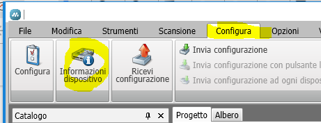

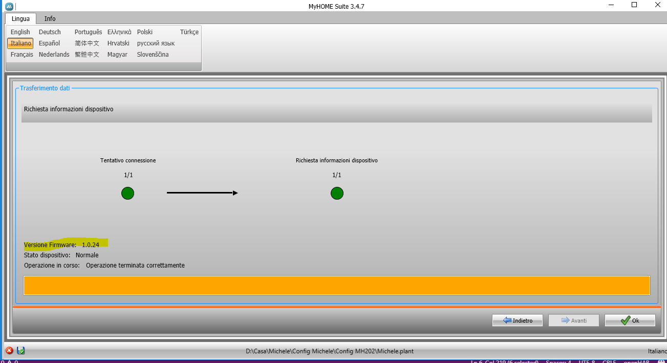

Which firmware version of the webserver?
Don’t know how to check it.
Use MyHomeSuite ?
yep, MyHome Suite 3.4.7
mine is a MH202
mmmm, Don’t know why but i already checked that settings there and can’t get it:
As you can see it’s greyed. :frowning:
